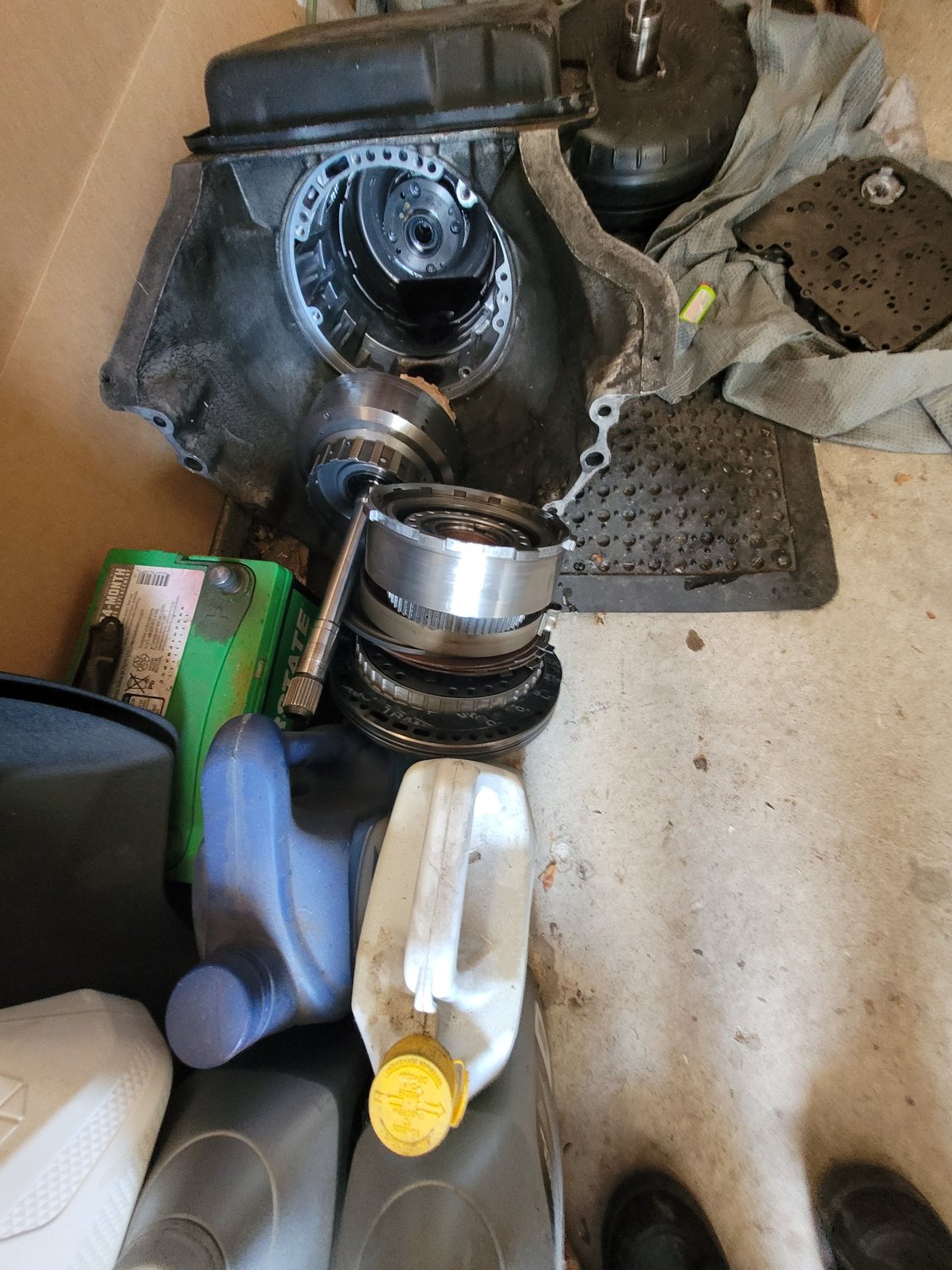

I see nothing out of the ordinary so far , except the gear you turn makes a squeek sound
Old Jun 28, 2025 | 10:45 AM
  #60
Posts: 6,095
That squeak is the one way roller clutch, perfectly normally.

This doesn't look good does it ? 😕
It looks like it spun or something ? There are grooves
Old Jul 2, 2025 | 02:14 PM
  #68
Posts: 6,095
I have seen those kinds of scratches on lots of those drums, and not just 350 transmissions.
Nothing rides on that surface, unless there is some other flaw I’d run it. The machining on some of these parts weren’t the greatest when new, after 50 years it’s not gotten better!!
Old Jul 3, 2025 | 11:04 AM

Maybe someone could shed a light on how the " stator " inside the torque converter did this in the first place. I apologize in advance if this was already answered , but I couldn't find anything. I watched a video or two , but they didn't describe the situation that can cause this in detail . It only ground the splines off about half way down the input shaft and then stopped . I mean , did it move or is it supposed to ? How the heck can it do that ?
Old Jul 12, 2025 | 02:08 PM
  #72
Posts: 6,095
On a TH350, that kind of wear is unusual. I can only recall seeing the splines missing on one other car, it belonged to a friends 70 year old mom. It was a mid 70s olds 88, the transmission shifted perfectly, but the car wouldn’t get out of its own way. I have no doubt the lack of low end torque was due to the stator freewheeling and not providing the torque multiplication it normally would.
That kind of wear is almost standard on a 2004R, that’s because the stator support tube isn’t heat treated from the factory.
Unless you find something else, I’d replace the pump, replace the converter, and reassemble. I bet your good to go.

The stator doesn't necessarily engage all of the splines and it does put a lot of stress on the splines.

The clicking noise the car made that I couldn't figure out for a year was the sound of splines being ground off 😆 . It all makes sense now , but I ignored the signs and F'd around and found out.
