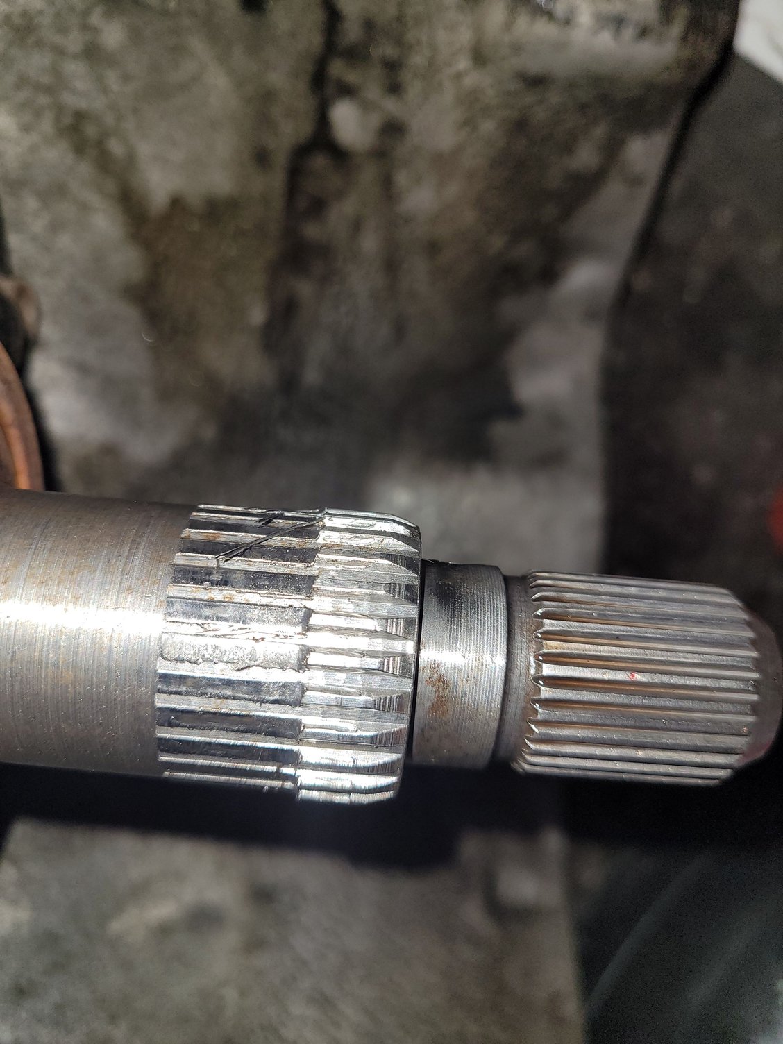

Ok , so the stator support is trashed , or at least the splines on the shaft where it engages is trashed ? Sorry , I don't know very much about transmissions or how they tick . I know my life threw me a ton of curve ***** and I'm once again running out of money . I want to enjoy this car and drive it again , that's why I'm doing this . I also like to tinker and learn at the same time so try to be patient with me . I'm kinda throwing this out there ahead of time because of the jack wagon that had to come into my u-joint thread and talk stupid .

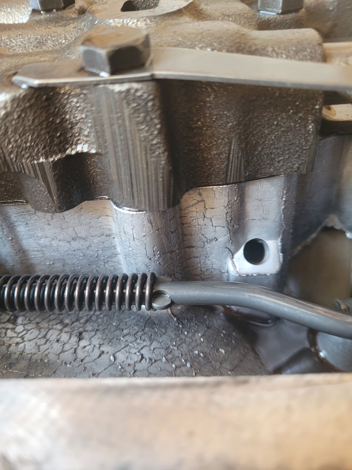

These look like cracks to me . I'm not sure what would cause this .... overheating ?

Ok , forget what I asked 7 posts ago , I get it now . That was one long spline with part of it chewed up . What would cause the torque converter or whatever to move ? I'm assuming that's what was sitting on that spline .

I thought that maybe I installed the torque converter incorrectly but wouldn't the wear be on the outside of the spline , not the inside ? I put the transmission in about 6 years ago give or take

It’s not common, but occasionally th350 tear up the splines on the pump. Replace the pump and converter more than likely all will be good.

The stator support is the part that, well, supports the stator. There are some decent videos about torque converters on yourtube these days. There are three main parts in a torque converter: the back part of the case is the "pump" and spins with the engine and pumps the fluid. The inner forward portion is the "impeller" which sits on the forward-most and smallest shaft on the transmission - that's the input shaft. When the pump pumps fluid it tries to make the impeller move and when it does move, it turns the transmission. To improve efficiency there's a "stator" put in the middle which helps redirect the fluid. It's held in correct alignment by the stator support, and it has a one-way clutch so it can only spin one direction.
Splines tear up because the load put on them is too high. It could be that was a low quality stator support (many transmissions end up requiring a hardened stator support when put in performance applications), it could be something went wrong inside the torque converter and it locked up forcing the stator to turn the wrong way. Regardless, that torque converter needs to, at a minimum, be cut apart and rebuilt.
The aluminum castings for the TH350s just look like that. Consider it a style choice.

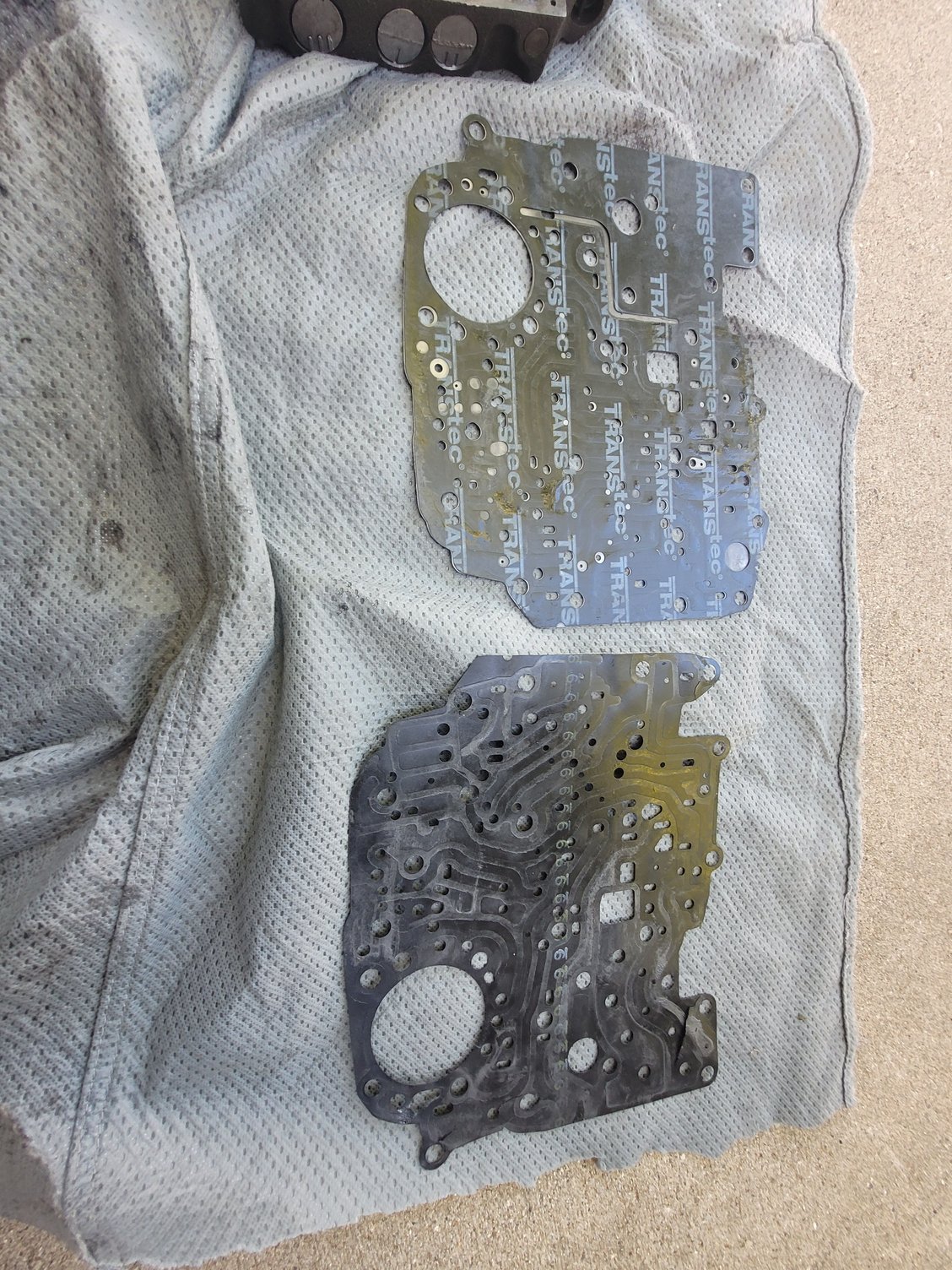

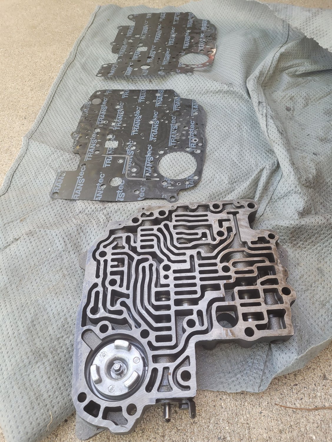

I'm assuming this is the spacer plate . I'm not sure what other pictures you wanted and where it's located

Posts: 6,095
A performance shift kit will include a couple extra plates that are sandwiched between the valve body plate and the thick factory transfer plate. The extra plates are part of the dual feed modification.
If you look at the direct drum, you will notice there is a seal inside the drum. For some reason, HydraMatic decided to split the direct drum into 2 separate chambers, one chamber for reverse, the other for high gear. The dual feed medication combines both chambers of the drum, almost tripling the clamping force.
There are a couple of ways of doing the dual feed. One involves just installing a shift kit. The special transfer plates block off and redirect oil as needed. The advantage of this method is it requires no major transmission disassembly, and can be done with the transmission still in the vehicle.
The other way involves removing the center seal, removing one seal from the pump support, and blocking a hole in the case. This is the preferred method, it eliminates potential hydraulic leaks, and shortens the hydraulic path tge oil has to take to do its job. The disadvantage: it requires transmission removal and partial teardown.
Pay attention to the direct drum when you disassemble it. Note if there is a seal inside the drum, there should be 2 seals on the piston. Once you have that info, report back and I’ll have a better idea of what was done.

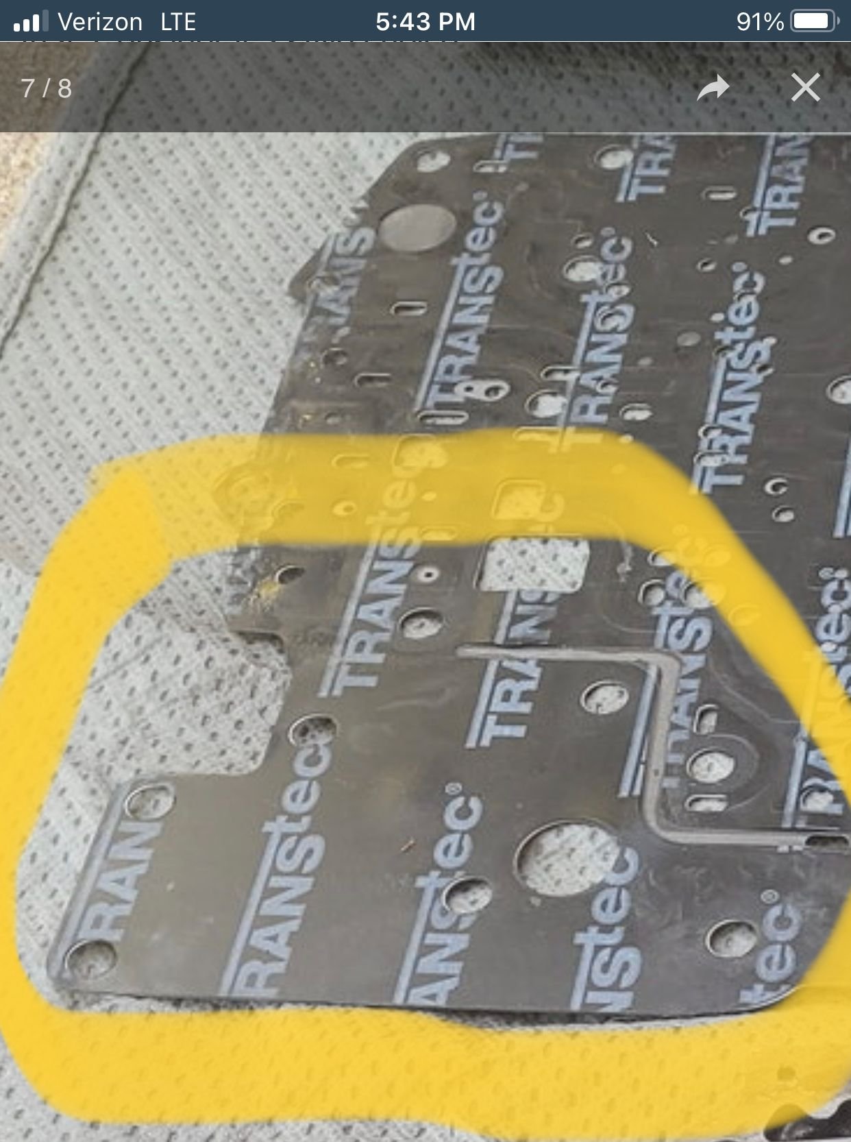

What was bolted here? Just one single thick plate, or a thick plate with a couple thinner plates sandwiched in between?

Performance shift kits include a special spacer plate in addition to the stock plate that bolts into the area I circled. You can do the exact same thing by plugging a hole in the case, and leaving a couple seals off in the direct drum and pump.
In other words, is there are 3 plates total (the factory plate, and 2 transfer plates) then the direct drum/pump needs the seals. If there is only the stock plate, then for the dual feed modification to work correctly you need to plug a hole and omit the seal on the drum.

There's a metal plate , a thin gasket that connects to that and the thick cover where all the bolts go through . I'll look at the pump for seals
