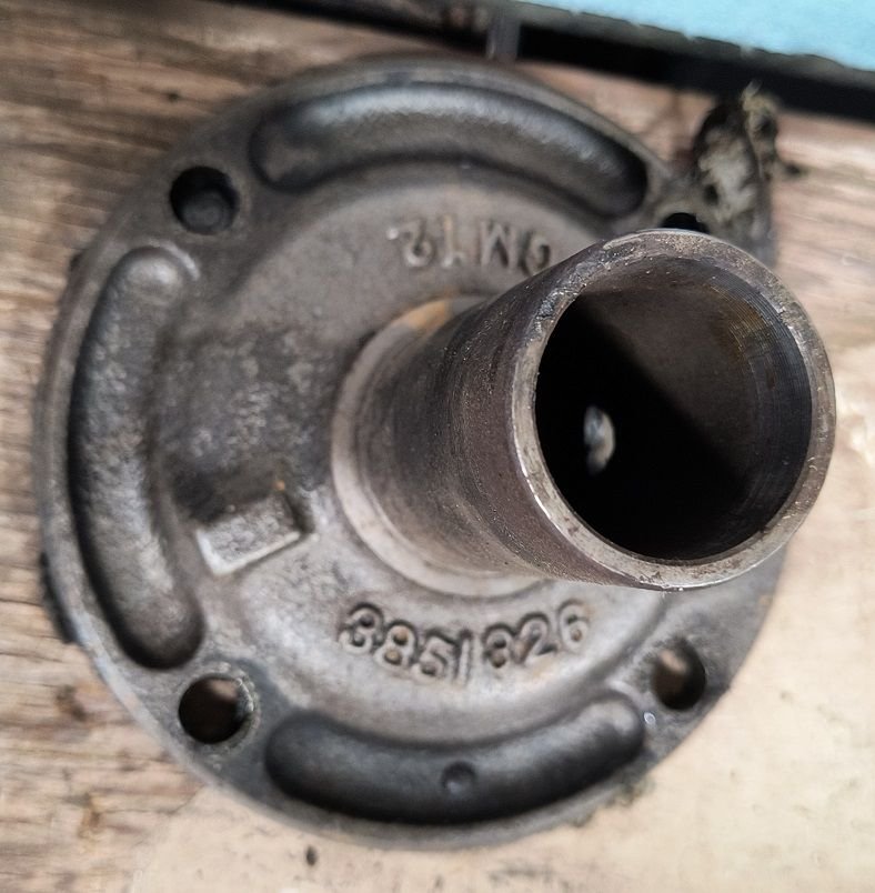

Here are the pictures of the case. It is from a 1966 car not sure what kind. The one in my 65 cutlass had the syncros go bad so i was going to replace them but I was getting ready to leave for collage and I had never worked on a transmission before so my Dad found this one and I swapped out the tail piece because it had the speedometer on the wrong side. I may have swapped the fork cover also. Not really sure as this was around 1984-85. I do know that the linkage is from my cutlass.
Both input shafts have 10 spline / 21 tooth. output shaft has a 27 spline.
Yes I am replacing clutch and pressure plate. I am putting a new TO bearing in also. This is all going on the 455 that I have that I am going to start the rebuild after I get this back together. The 455 is from 1970 (VIN derivative 30M301313)

Looks like a universal bell housing? Two starter snout holes.
The smeared main case number looks like 3885010 = Model year 1965 - 1967, M20.
P0301 is Muncie 4 speed, March 1st of 66.
The Vin stamp 6Z indicates 1966 Fremont CA plant. The last digits are the cars vin #s. But there is one too many digits there unless Fremont was beating to its own drum...again.
All this is off memory, so verify.
Check the flywheel to bell housing trans flange mount for concentricity and parallelism to the block & flywheel.
If that is all good install the bell & clutch and measure the stack up depth and compare it to the face of the trans and shaft.
There are YouTube videos showing how to set up your metrology and where to take the measurements.
If that checks, install the trans and see if it seats nice into the pilot and ensure the clutch disengages like it should.
Make sure you have the flywheel ground on a dedicated flywheel surface machine.
I'm at work, so I don't have time to run the case numbers.
There are at least two good Muncie sites that will break the numbers down.
