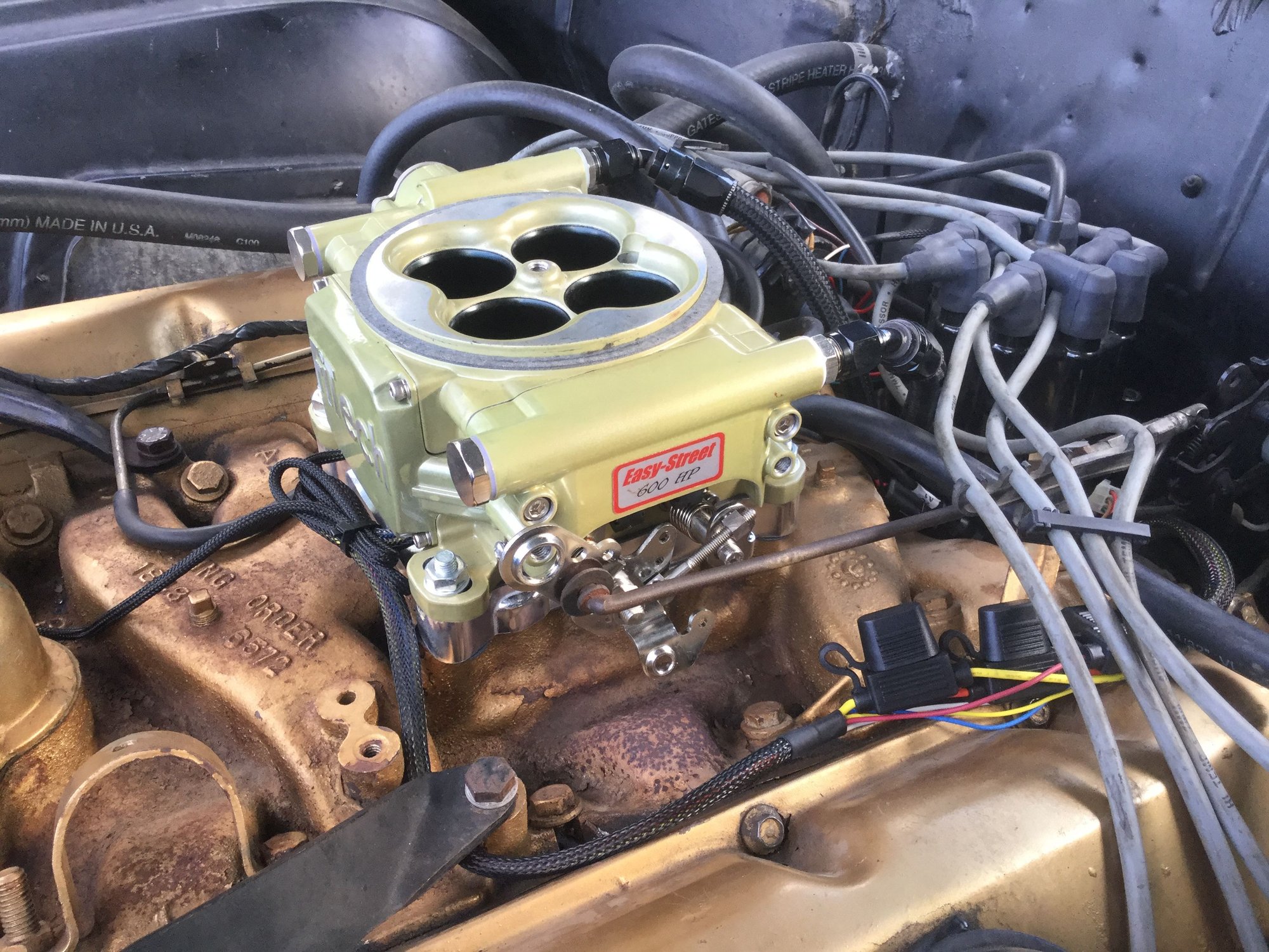

Sorry, here are the photos.
Old Jul 21, 2018 | 04:48 PM
Posts: 50,802
OK, that helps. I can't tell if the wires to the round throttle switch are connected properly. There are three terminals on the switch. One is +12V in, one is 12V out only at wide open throttle (this is for the kickdown), and the third is 12V out at idle/low speed and again at WOT (this is for the switch pitch). You'll need a test light to see if that's working and when in the throttle travel that each one activates. You'll also want to check at the trans connector. There are two wires at the trans connector with the terminals in a "T" orientation. The top of the "T" connects to the switch pitch solenoid, the other leg to the kickdown. Verify power at those points at the right throttle positions also.

Best you could tell from the photos, did it look like the rod was connected properly?
Old Jul 22, 2018 | 06:19 AM
Posts: 50,802
Yeah, but there is no way to tell if the arcs of travel match from a photo. There's nothing obviously wrong, so it's all in the details. FYI, it looks like the throttle rod is rubbing on the no 5 plug wire. That could eventually cause a problem if it is.

You need to keep the wires off the intake exhaust crossover ( like on the pass side) that crossover will melt those wires and probably leave you dead in the water.

RetroRanger: are you referring to the exhaust crossover pipe that runs from the driver’s side exhaust manifold and into the passengers side? If so, no worries there. That thing was removed for duals about 20 years ago. But good advice nonetheless. One criticical thing with FITech wiring is to run it as far away from other electrical as possible. It’s prone to pick up something called “RPM Noise.”

The intake has an exhaust crossover under the carb(FI) . See the middle runner just under the throttle linkage you can see the paint is burnt off it but the other runners are still gold. That runner gets hot asthe exhaust and will melt whatever touches it. On the passenger side there is a little clip on the valve cover that holds the wire or vacuum hose away from the crossover the drivers side needs something similar to hold those wires and fuse holders away from the hot runner.

Update........As it turned out, my problem was not related to the throttle adjustment at all. Trans wasn’t getting enough vacuum. FITech installer ran the trans vacuum from a throttle body secondary, which was too restrictive. Had to take it to an old school trans shop to figure it out. They ran the vacuum directly from a manifold port and just like that...all good again. I did also get those wires off the exhaust crossover. That tip saved me some serious grief. Thanks again to all who chimed in!
