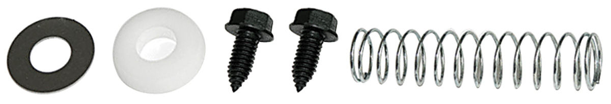

Seems like this item has gone MIA. Before ill fabricate something up, id rather by the correct part, if its available. Problem is, i dont actually even know that in what name i should search it? Assembly manual simply states " bushing". Any leads? Picture to clear the question. Item number 11.

It’s available thru dorman, the Help section at the parts stores, plus countless aftermarket vendors. That bushing was used on pretty much every GM car and truck, column or console shift. You shouldn’t trouble finding one somewhere

Im still at miss how should i search it. Ive tried countless of different search words, but they seem to show up only some wire sleeves, rubber bushings etc.

Search for "backdrive linkage bushing". Here's one source.

Jouni, I think this is what you're looking for? Looks like the white bushing in the picture? The sides aren't square, they're tapered
Hardware, Cross Shaft to Frame Bracket, 1969-72 A-Body Column Shift, Back Drive

Many thanks!
