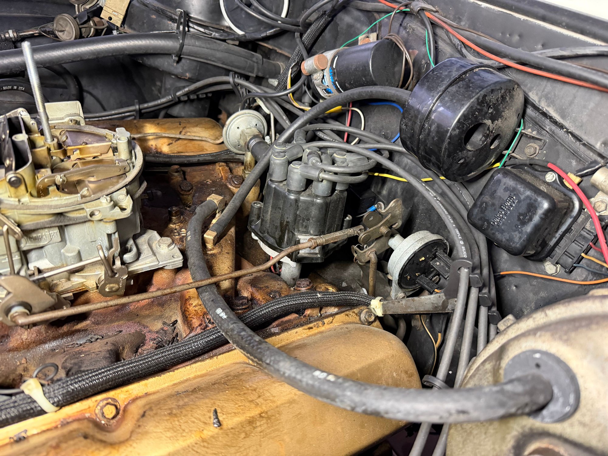

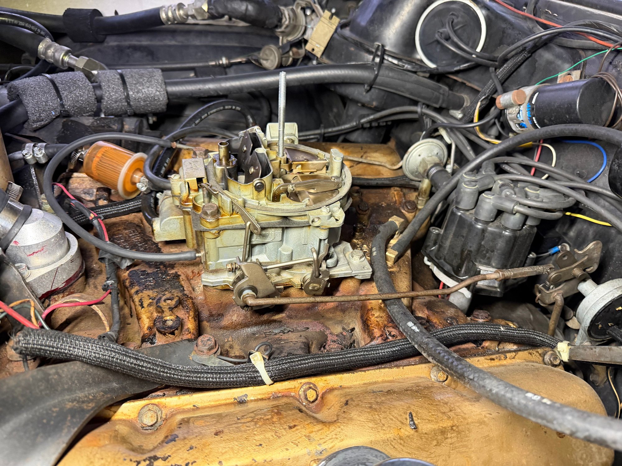

So I am going to install. TH350 in my father’s 66 Cutlass that has a 330/ST300 2spd column shift. I understand the install is straight forward and have done trans replacements. The only thing I can not figure out is the kickdown cable. He has a 4barrel Quadrajet on his 330 with all the factory linkage. I don’t see how to hook up the kickdown cable to the throttle arm of the carb. There is no hole for it. See pics below. I know I can buy an aftermarket bracket and cable but not sure how it would attach or if the factory linkage would be in the way. Car is in FL and I am in NJ. He is brining it up for me to do the swap. Is there factory parts I can get from a later model?

There are a couple of ways to do this. The easiest is probably to get an aftermarket cable and bracket from a company like Lokar. Finding the correct lever arm distance for the kickdown cable might take some trial and error. Alternately, get a later Qjet that has the provision for the kickdown cable.

I appreciate the ideas! I previously found Lokar kit XKD-2350U but I am not sure if it will clear the factory throttle linkage as it sits and I have now way of attaching it to the throttle lever/arm on his quadrajet. I maybe able to swap out that with one that has a provision but I will have to get him to give me some more measurements and more pics.
Has anybody used the above kit on an Oldsmobile intake manifold to verify fitment?

Id start by finding a junk Q-Jet and either transferring the entire throttle arm (not the entire throttle shaft!) or just removing the stud for the kickdown cable. This would be an option if the throttle arm with clear the exhaust crossover of the intake.

The 1966 throttle linkage doesn't work that way. The pedal is hinged on the floor and the arm that comes through the firewall only moves forward when you press on the pedal. On the 68-up cars the arm extends above the pivot point and thus is able to pull on the cable when you depress the pedal.
As for swapping the throttle arm, the arm is swaged to the throttle shaft, so you really do end up swapping the entire shaft. Personally, given the issues with the 1966 Qjets, just get a later model Qjet.

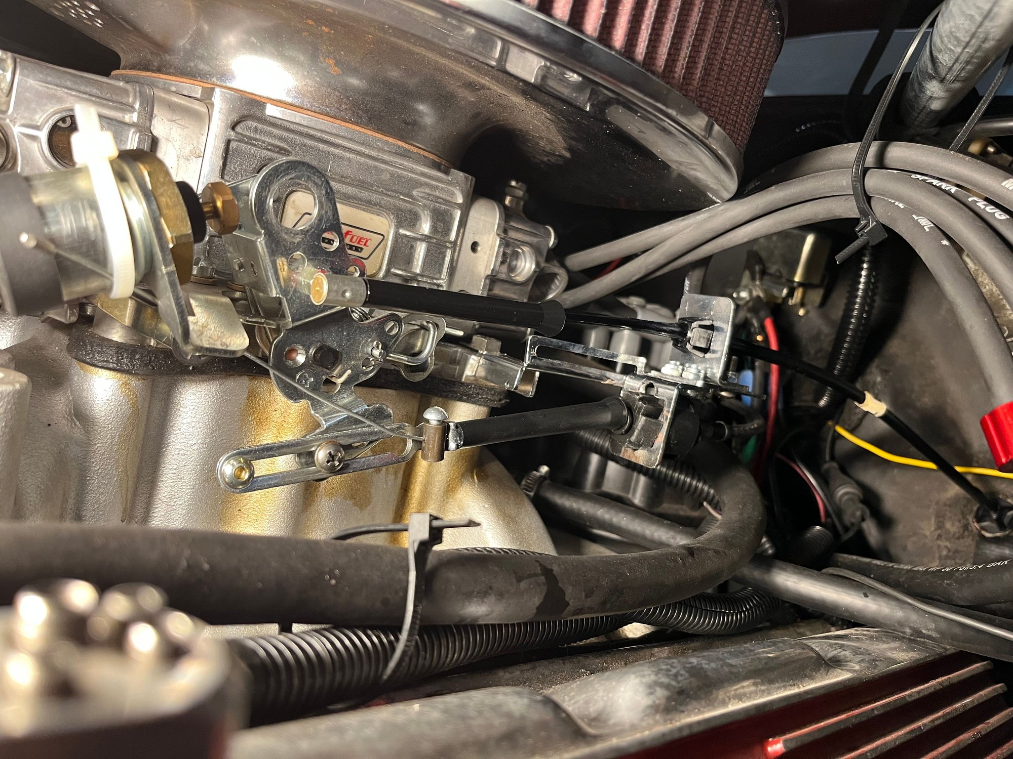

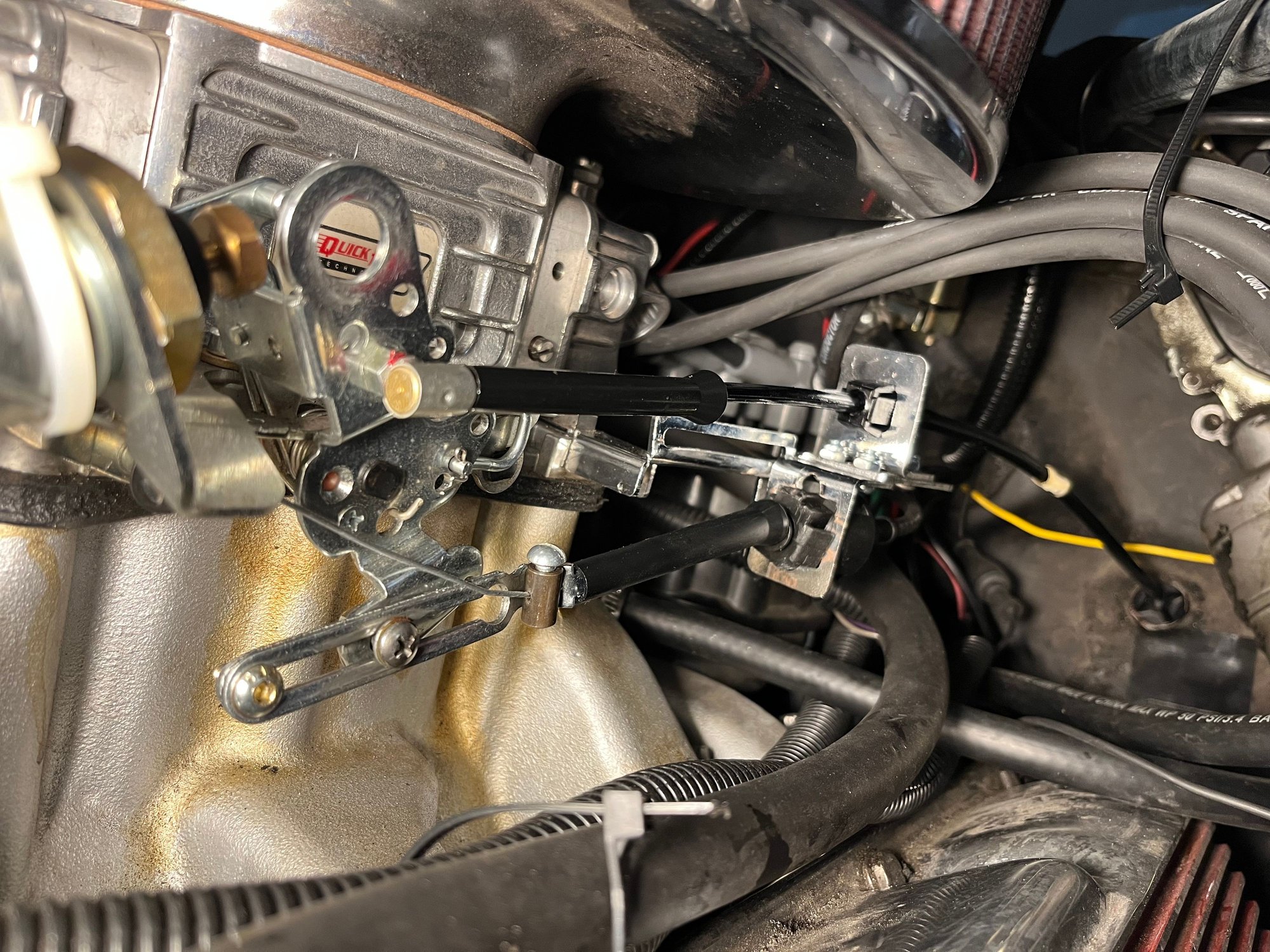

on my 72 350/TH350 I went with a Quick Fuel carb (a Holley-style platform) and had change out both my original throttle cable and the kickdown. Ultimately went with the Lokar KD carb-mounted cable and an OEM Buick Skylark 2-bbl throttle cable which was the perfect length (19.5") for my setup. The Lokar KD cable was a great option for me - I couldn't get the original pedal-mounted kickdown cable to adjust right or operate smoothly on that setup. I had to add an aftermarket carb bracket to align both cables to the carb.
Eventually I'll trim off the excess KD cable wire protruding forth of the mount - I didn't want to do that until I was sure of my adjustment setting.
So possibly similar mods may work for you if you swap out your carb to something newer, whether Qjet or Holley-style

As for the throttle arm, I have ground off the swaged part, transferred arms, and welded them together with success. If the existing Q-Jet needs work, then the later carb would be the better option.

I think I may have found a Lokar cable and bracket that will work. I am talking to the carb shop here about a later model arm that has the provision for the kickdown cable.
