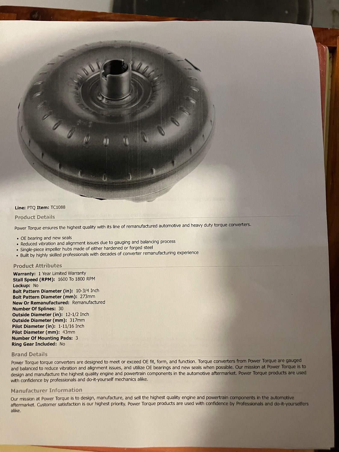

I have a 1974 Oldsmobile 350 engine I am adding a Buick 1977 TH350 transmission. Ordered torque converter for a 1974 olds 350. Picture is the specs from torque converter. Will this all play nice. Planing on install next week.
also what is a ring gear that does not come with the torque converter. Do I need a new one or can I use the one on the car now.

Some engine families have the starter ring gear as part of the converter. GM is not one of them. If the stall speed is close to what the factory had, and the converter is made correctly it should work fine.

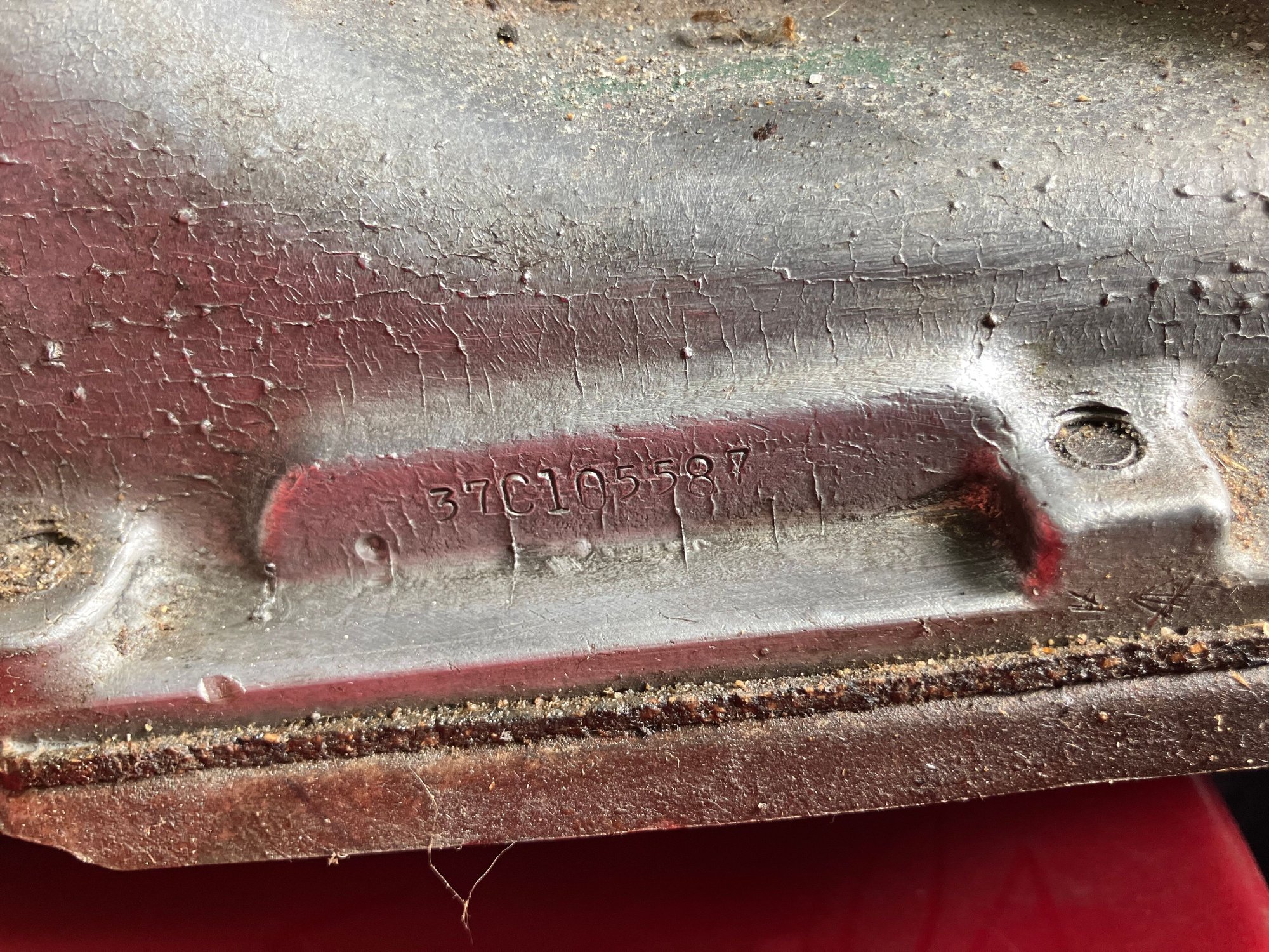

Would a torque converter for a Oldsmobile th350 also fit into a Buick or Pontiac th350 of similar years
or are there more surprises
Yes, ASSUMING this is not a TH350C with the lockup converter. Since the TH350C didn't come out until the 1979 model year, that should not be a problem if your trans really is from the 1977 model year. The second character of the VIN derivative stamp will prove the model year.

37C105587
His data sheet says 1397 RPM stall. I have no idea if that is close to factory or not, but it’s way less than I would use. 1800 RPM would be my minimum, but I’m performance oriented.

My mistake on the converter sheet here is the correct one I ordered sorry for the confusion
Thanks fun71

37C105587
37Cxxxxxx is Oldsmobile Division (3) 1977 model year (7) South Gate, CA assembly plant (C).
Thanks fun71
I find the factory converter flashes around 1600 rpm, makes a lazy launch with ypur factory 2.73 gears. As said a 2000 stall will increase launch a noticeable amount. Sounds like nothing is stock in the driveline, make the 79 H/O more fun.
Same here. I would think a stall speed of 1400 would be pretty sluggish.

I did go with the 1800 the first data sheet was the wrong one I added the correct one above your post 🙃
