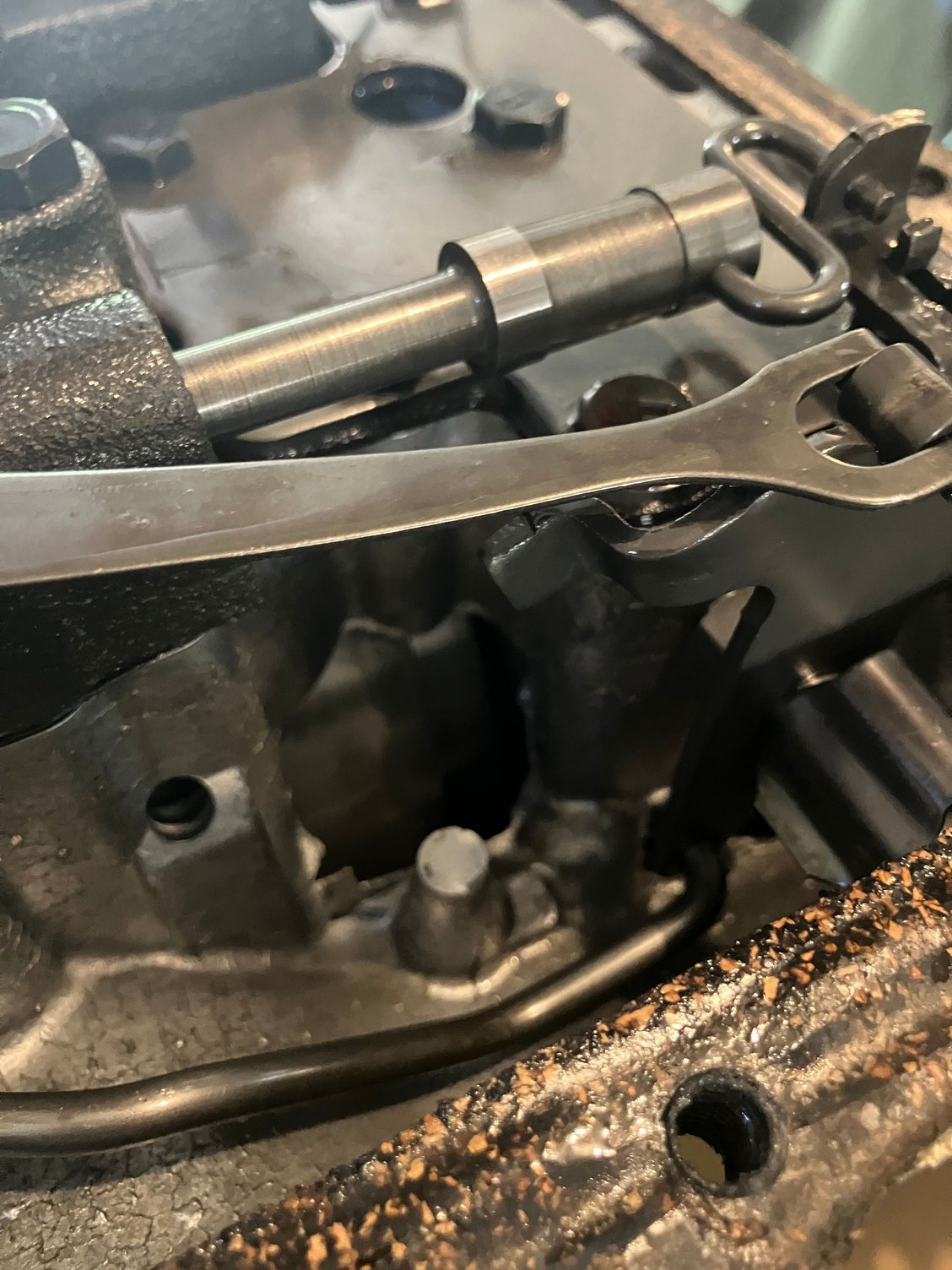

Starting from scratch
opened the transmission and there was a
hole I could put two fingers in.
looking for a good TH 350 folks
Old Jun 6, 2025 | 02:28 PM
Posts: 6,105
Normal. That’s an area that didn’t need any material, so HydraMatic didn’t set up the die to cast aluminum there.
If you think about it, all the lube oil that’s flung off the planetary gearsets has to have a way to drain back into the pan. That hole saves a little money in material cost, and is a convenient drain. Almost like the engineers knew what they were doing!!

There was quite a bit of metal flakes in the pan not sure if I should take the gamble. That hole is ragged and ruff and next to the shifter
quess I need more convincing to move forward with this one.
Old Jun 8, 2025 | 10:57 AM

Some metal flake is normal for a used transmission...
The hole is normal as both Matt and Koda attest to and is unsightly at the same time.
Here is a Reddit question and answer on same subject with pic. https://www.reddit.com/r/MechanicAdv...upposed_to_be/

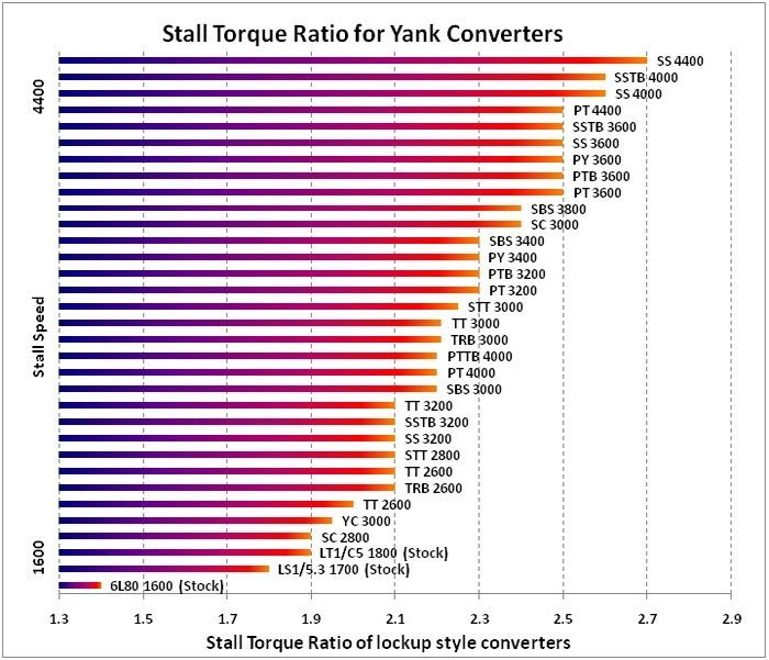

Also with regards to your original question. Here below is a high performance converter chart. Stating both stall and multiplication factor.
Bottom three are stock/equivalent. And you can see how as stall increases so those multiplication. Apples and oranges but you can see how they go hand in hand in all out performance.
