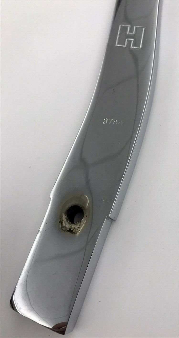

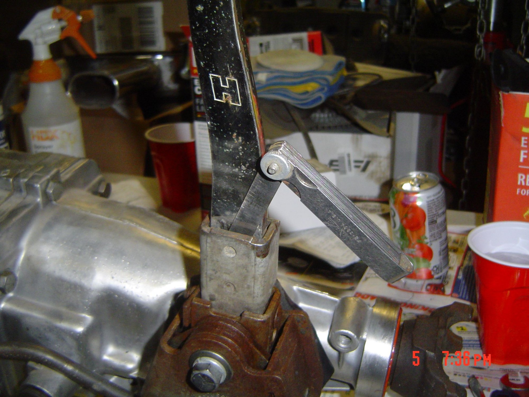

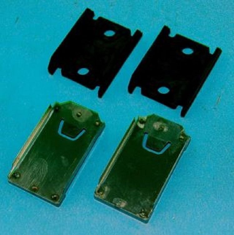

there is a sheet metal spring that locks the lever in place -
your feeler gauge is on the correct side - just make sure it is centered/wide enough to get both corners
Old Feb 6, 2022 | 10:19 AM
Bills67's Avatar
Posts: 203
From: Cadillac Mi

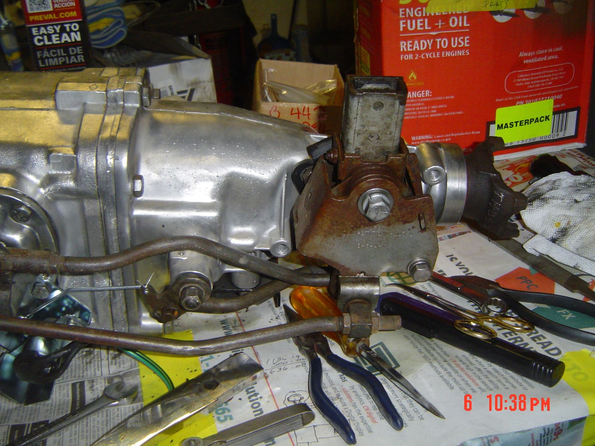

thanks for pics and the info, I was trying to remove it on my bench by my self so I will have my son-in-law help me hold it down to night.
Old Feb 6, 2022 | 06:44 PM
Bills67's Avatar
Posts: 203
From: Cadillac Mi
with a little help I got her out! thanks for info!
