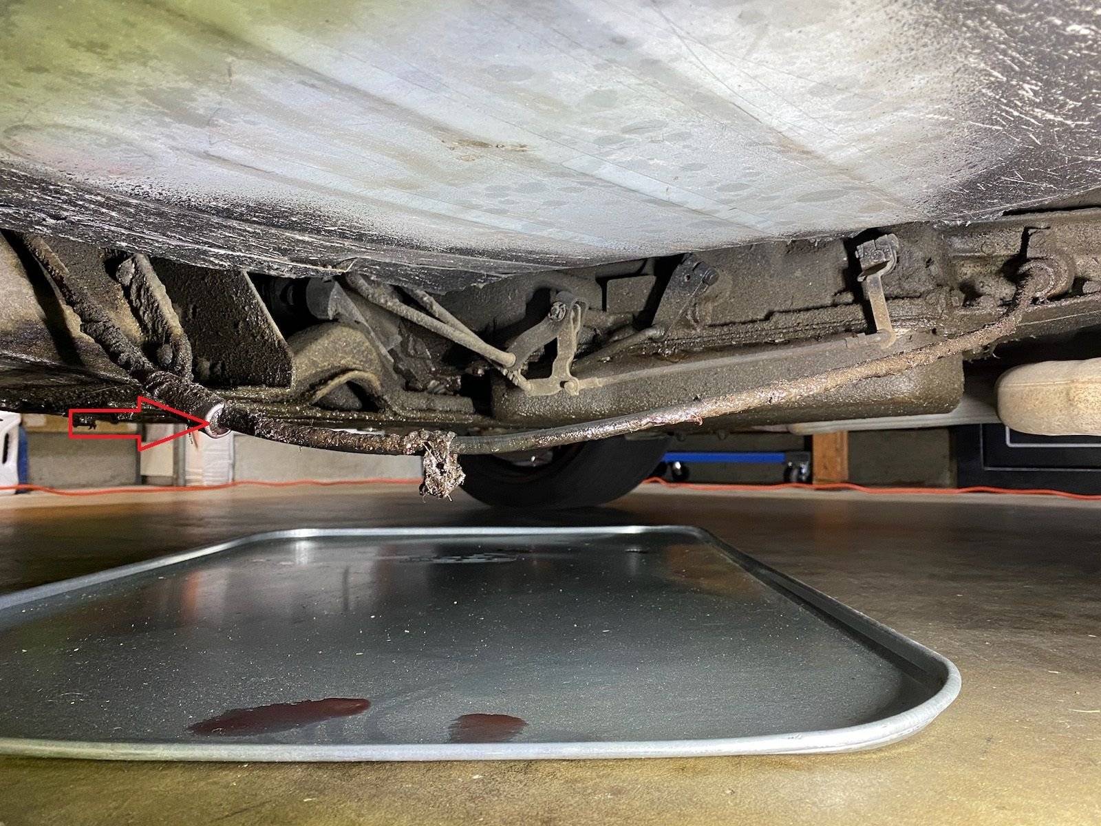

1961 Dynamic 88 trans fluid leak from speedo cable? (photo)
Hello. Newbie here. Just picked up a 1961 Dynamic 88 with original engine and automatic trans. It appears to be leaking transmission fluid from some sort of joint or connection in the middle of the speedometer cable. See attached photo with arrow pointing to where the leak is. Im having a hard time finding what I need to repair this. I assume a new speedometer cable? The speedometer does work properly otherwise. Can anyone point me in the right direction or have part numbers for what I may need? Im sure this wont be my first post as there is a list of items I need to address on the car one by one. Thanks in advance!

Edited my original post. It's not leaking at the trans connection. Its leaking from the joint in the photo in the middle of the speedo cable.

Now I’m even more confused. Showed a guy that photo and he said no way is it leaking from there as the cable itself has no sealing function. It must be leaking from the connection/driven gear at the transmission. Weird because there is no fresh fluid there but definitely fresh fluid further down the cable near the point I circled. Anyway, where can I get a seal kit for the driven gear/trans connection point?

There is an "O" ring and a seal at the speedo gear.
The fluid is leaking from there, and is running down the inside of the cable.

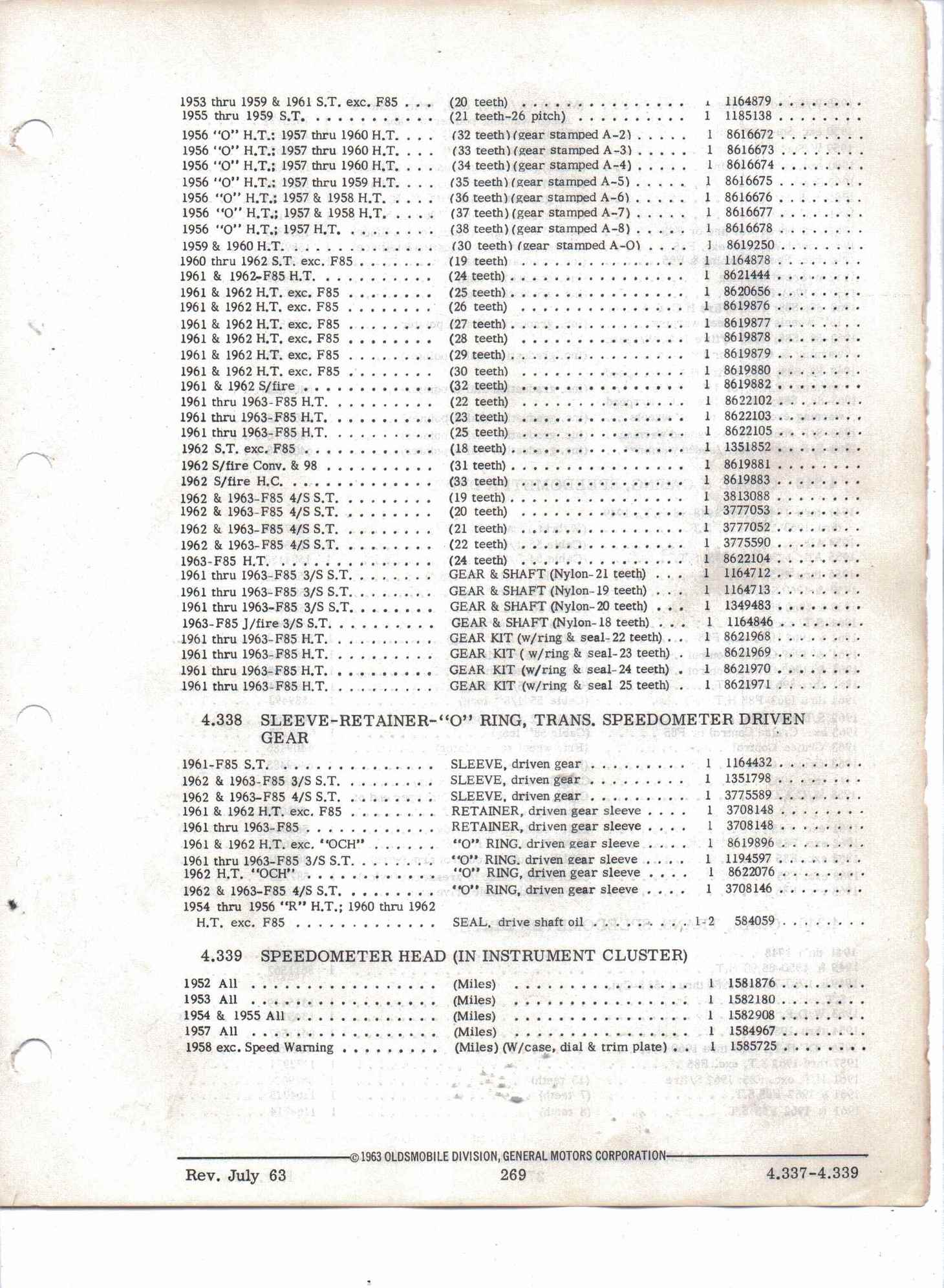

Thank you, Charlie! Any idea where I can buy those o-ring and seals? Doesnt seem to show the part numbers.

The part numbers are here in group 4.338.

Looks like 584059 .
Here's a link to FATSCO
Speedometer Seal (fatsco.net)
