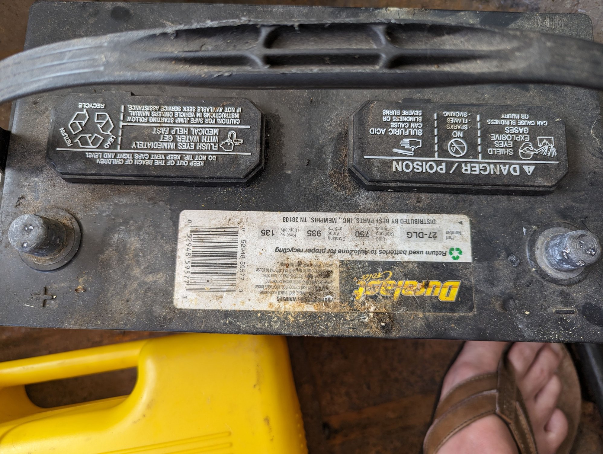

I just got back to it after waiting a week and the top budged for about 2 seconds. I jumped the switch with a wire and got another 2 seconds. But no consistent power.
I can't find any reference to the CB in the manual, but from google I believe it's this piece. I get 12v to ground on the right, 0 on the left. I tried just removing it and connecting the wires directly, but no joy. (Not sure if that should've worked but I thought it would bypass the CB).
I also tried bypassing the switch and that made it budge for another second.

I found a replacement pump online and it stated 12V. But no mention of amps. So I plugged the 12v battery right to the leads. Motor didn't make a sound, and the wires immediately got hot enough to start melting to the terminals.
The pain here is that the motor isn't accessible with the top down.
Question for those who know hydraulics better than me, if I disconnect the pump from the rams will I be able to muscle this thing up?

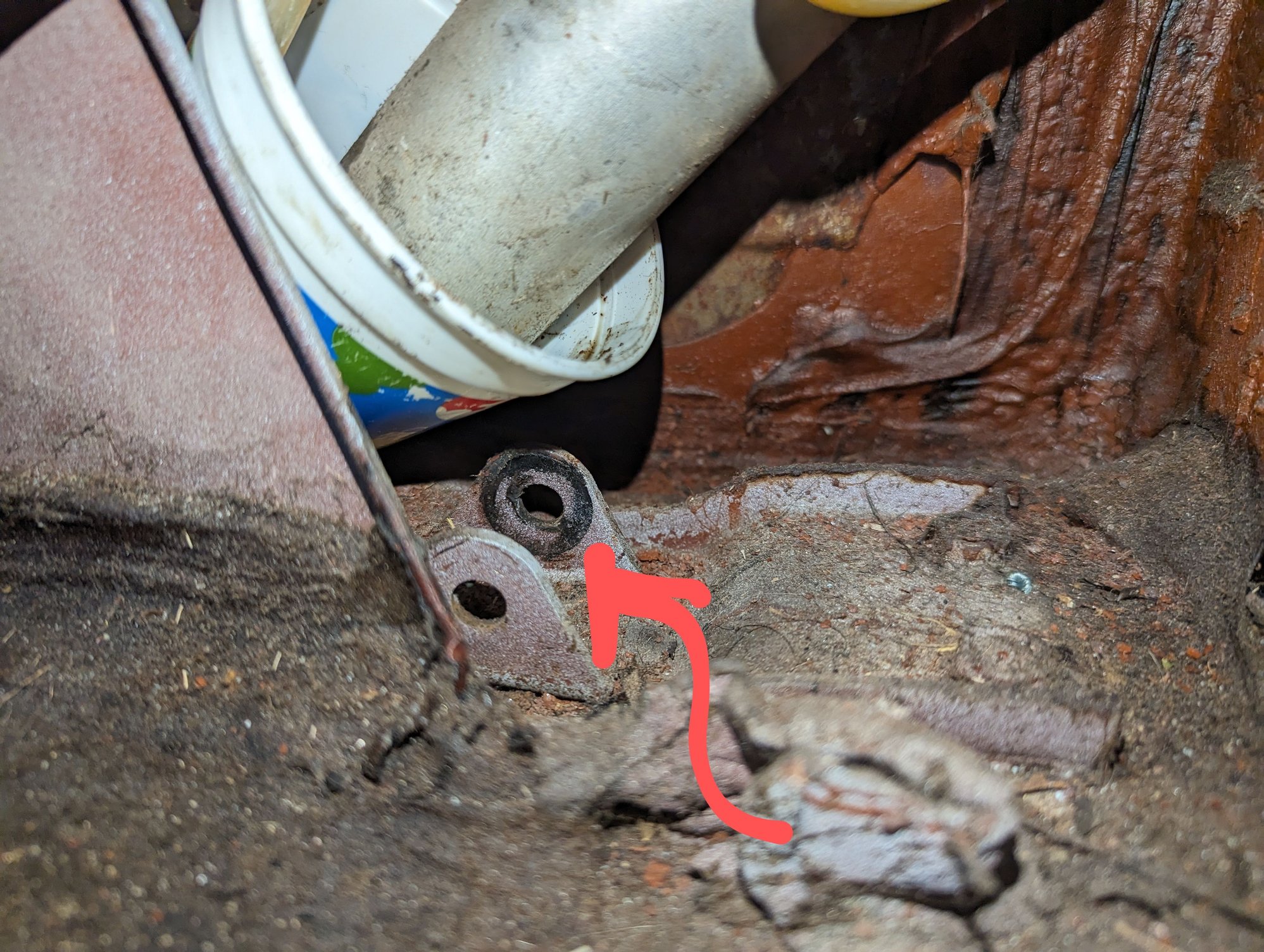

Only a month later, but finally got my top up. Figured I'd update the thread so any future individuals can benefit from my lessons (there were a bunch!).
#1) If you think your system is about to break, fix it. This thing is definitely made to work on with the top UP. Stuck down really made my life harder.
#2) See the picture I attached, if you knock out the cotter pin here and remove the pivot bolt (I think that's the right term) you can put the bottom of the ram into a little plastic cup and really reduce your mess.
#3) When you make the ram longer, fluid wants to squirt out the top opening of the ram, and the bottom flexible hose. When you make the ram shorter it shoots out the bottom opening on the ram and the top flexible hose. (thank goodness I had my glasses on when I learned this lesson, and I'm an eye doctor, so it would've been an embarrassing call to a colleague.)
#4) Once the ram is out, the top operates very smoothly manually. I'm going to fix it properly, but at least now I have no rush.
And for any one curious, as I drained the fluid from the passenger side of the system I drained some nice clean fluid, looks like it just came out of the bottle this afternoon. The driver side, black and filthy with metal shavings. Additionally, as I removed the ram from the top connections, the passenger side basically fell out, but the left required a small pry bar. I figure the driver's side ram was failing and bending and stressed out the motor (I'm really hoping the frame of the top is something I can straighten out once I have the new setup). Once I got the top up and took out the hydraulic motor, all sorts of corrosion that wasn't there when I topped off the fluid last summer, figure I blew a seal on that thing. Given the metal shavings I'm going to replace the whole thing from pump to hoses to rams.
