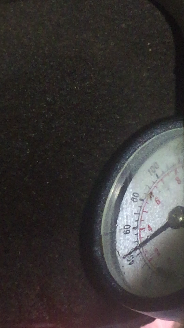

Old Jul 13, 2019 | 02:08 PM
Jeff99's Avatar
Joined: Jun 2019
Posts: 117
From: Mi
So got a gauge on and it has plenty of oil pressure. Light is on almost all the time now. There is no play between moving the crank and the distributer So don’t think that nylon teeth are gone, guess it’s the sender
Idling hot
Revving at 3000 rpm
Old Jul 13, 2019 | 02:17 PM
If you have oil pressure completely warmed and the light stays on its the sender.
Old Jul 13, 2019 | 03:25 PM
Posts: 18,225
That's a relief. A $10 oil pressure sender is preferable to low oil pressure.
