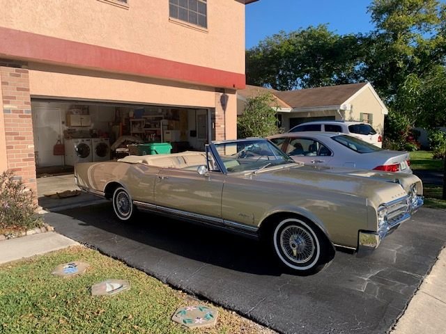

Thanks again for the info, hope to report next month. Took her out for a cruise on Ft Lauderdale beach today, temperatures low 70s.
Our "driver", cruised along Fort Lauderdale beach this afternoon, temperature low 70s. Hope to report on sway bar next month. Happy new year to all of you, thanks!
