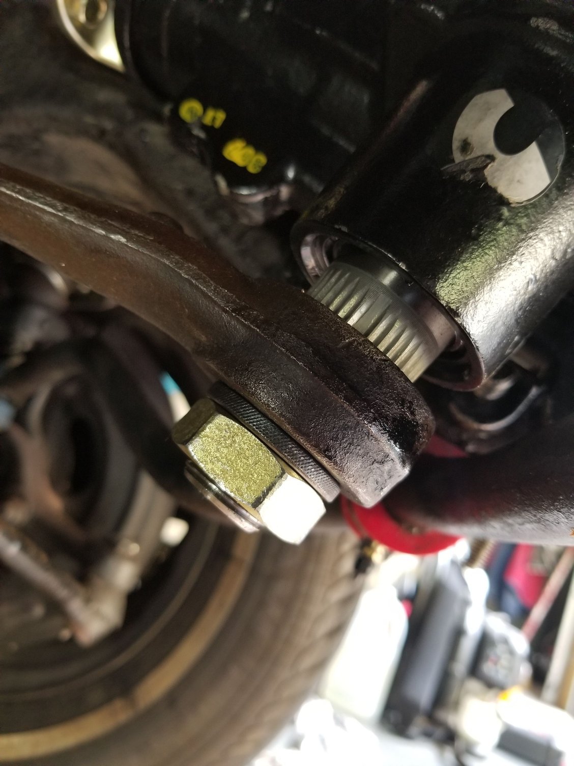

I changed my steering gear on my 69 Cutlass and have a question about how much spline should be exposed after the nut is tightened. I think it was similar before but don't recall. It is tapered and I have tightened it as far as I can get it using a 12" adjustable wrench. I don't have a socket that big or I would use a breaker bar on it. I will probably wind up buying one. Can someone confirm if this is correct?
thanks, Steve

Your adjustable wrench has nowhere near the ability to apply the correct 180-210 ft-lbs on that nut. Buy, borrow, or rent the correct socket and torque wrench.

I agree, I just thought it would snug up a lot more, then torque it. I guess it takes the torquing to get it tight, almost like a press.
thanks for clearing it up, I think. I'll pick up a socket today and see if I am capable of 200lbs.

So this is torqued to 190#. Is that typical to still have the splines exposed?

Yeah, that's normal. So long as you have several threads past the nut like that, you're good to go.

I was surprised, I used a 3/4" drive torque wrench and got it no problem. I was about 28" long. I also thought I would need to extend it.
