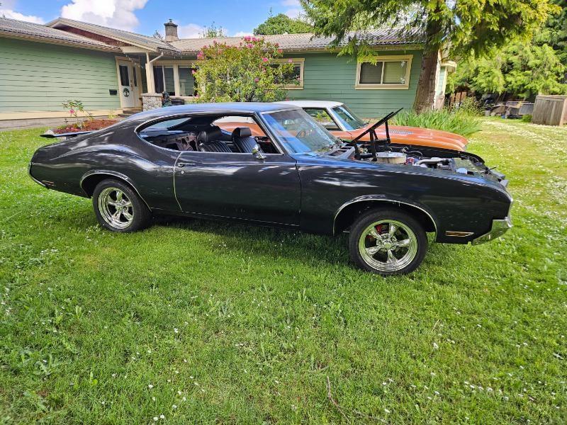

The 64-72 A-body cars have a terrible camber change curve with suspension travel. This is why people use tall spindles or ball joints. In the photo your car looks to be VERY high in the front. This will cause negative camber. The car needs to be at the factory spec ride height for alignment.
The photo doesn't lie...the front is definitely at least a couple inches too high, certainly higher than it sat before and not how I want it to sit. It sounds like my first goal should be to get it sitting closer to where it should be before messing with control arms.
This would, I assume, mean a closer look at the springs to make sure they're indexed and seated correctly as my first step. The car seems to be sitting square so if one is wrong, I'd think they're both wrong lol. These are new UMI "Performance Stock Height Springs 4049F" for small block applications. With my aluminum heads and intake, I believe the 455 now weighs a touch less than a small block.

It's VERY easy to get the tops of the springs incorrectly seated in the frame pockets, which causes at least an inch of extra height. Beyond that you may need to cut a coil.
