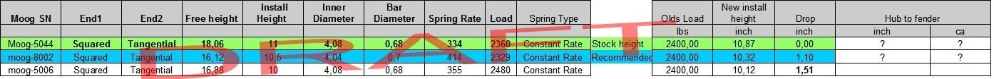

From the Impala Forum I learned that it should be easy to calculate ride height if you have:
Unsprung masses of an 80s Olds Delta88 for each axle/ (or sprung masses and total curb weight)
+ Spring rate and free height of a original Olds spring (or at least one comparable).
Then you would have all needed data on the Moog website to choose exactly the spring for your desired ride height and comfort level. I even created a small excel sheet to help with calculation.

And yes, thats why I would data from people that have Moog springs installed ind their Delta88s. With this data it would be easy to calculate the "real" ride high based on spring rate and spring height. Or at least an pretty good estimation. In another forum someone created a chart for this and I would like to adapt it for the Delta88.
Those values are currently not correct, but it should look like this in the end:
By this you could choose the correct spring for the desired ride height.
