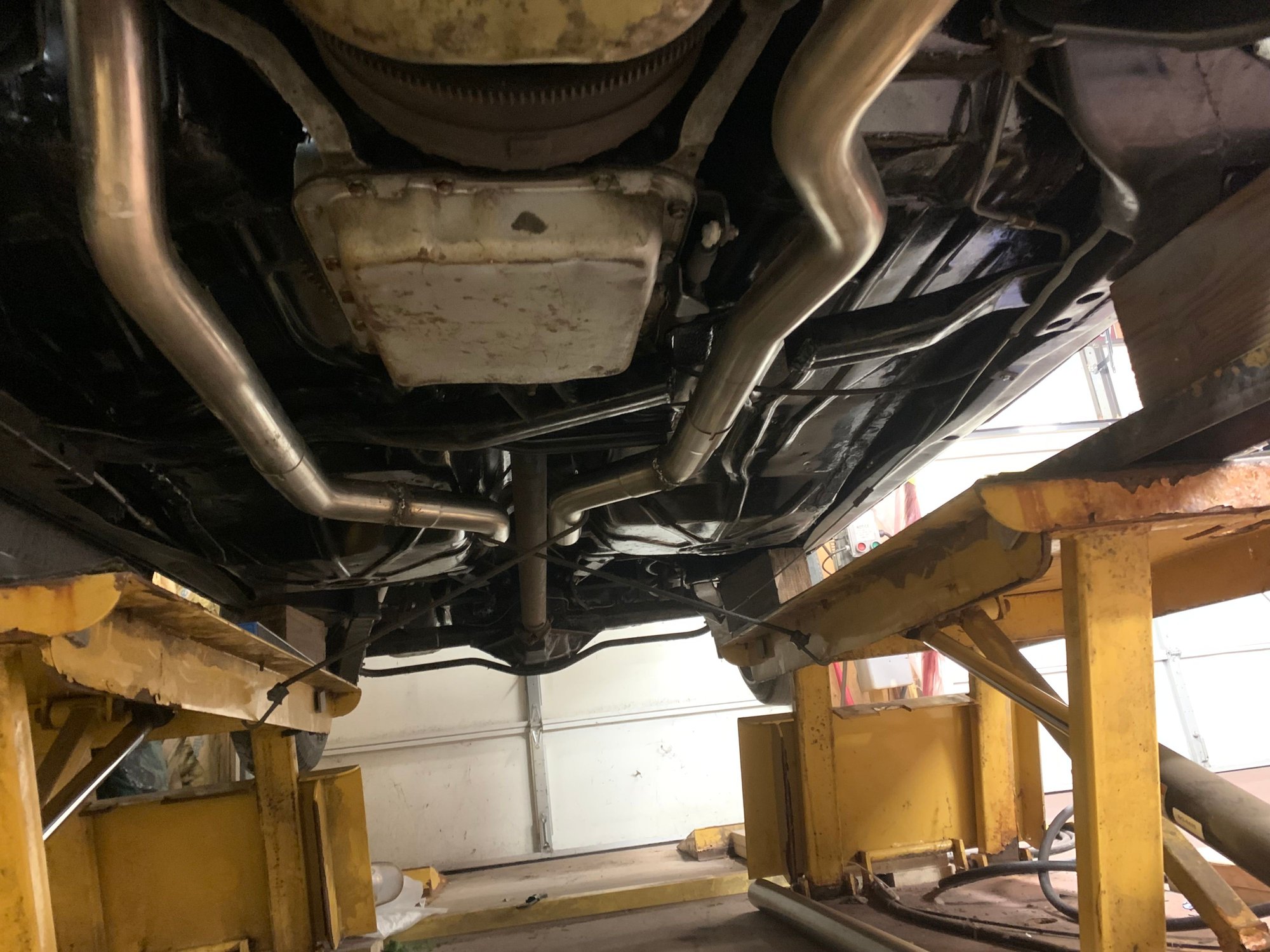

The fit isn't the best you might need to do some clearancing (smash with a hammer) to get around the starter on the driver's side. I reclocked my mini-starter out of the way, but a stock starter could be a little too close. I don't like how low the system hangs; IMO it needs to have some tubing cut out and re welded to tuck the exhaust closer to the car. It's not unacceptably low but a little too low for my taste (my car is lowered so YMMV).
I have them on my car (85 442) with this system:
https://www.pypesexhaust.com/product...-exit-includes
