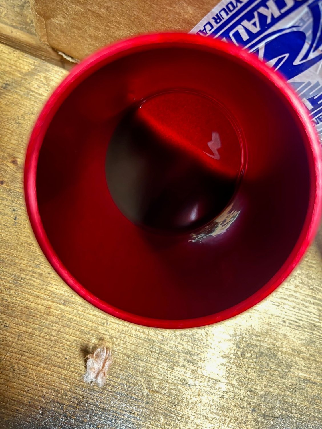

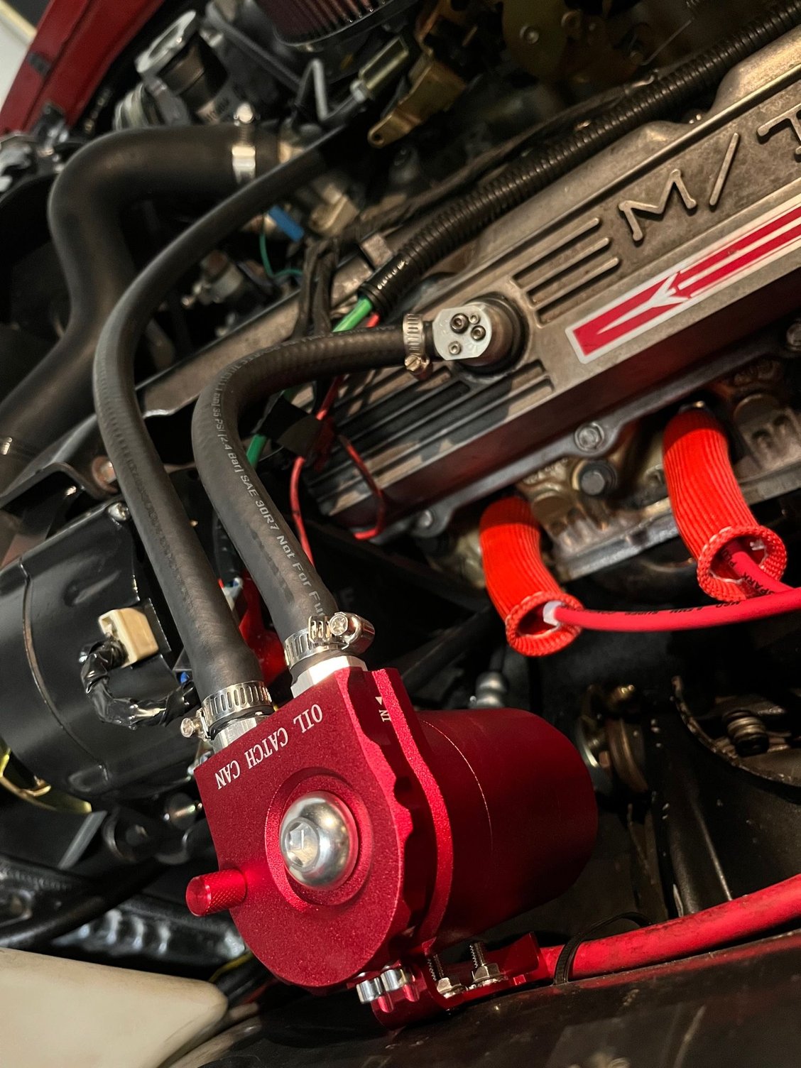

I use one on my '72 350 - after about 500 miles or so it actually does accumulate a relatively small amount - my rebuilt motor has about 17k miles on it now and I went thru it almost immediately after first getting the car so I don't have any prior oil usage history to compare that to. My valve covers are baffled inside and the PCV I'm using is a Wagner M.E. adjustable piece that you can set to your specific engine.
But if it's gonna move oil, I'd rather catch it in the can than back thru the carb
