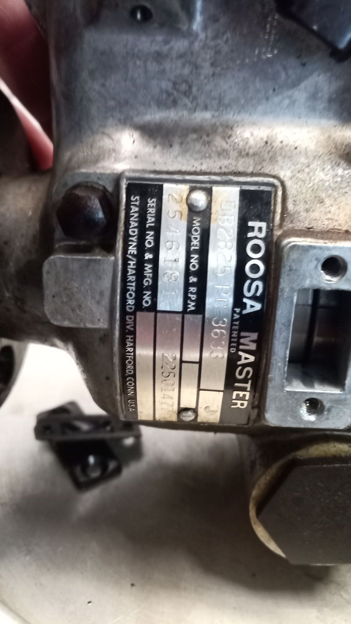

Hello to all, I take back this very interesting subject because my Oldsmobile has just let me down last Thursday: the injection pump doesn't give any pressure at the injectors outlet anymore...
So I removed it from the car and I took the opportunity to remove all the injectors (pencils) and the glow plugs.
I didn't understand if a solution had been found to get new injectors or if it was possible to have them overhauled? They will be tested anyway to have an idea of their condition.
I have another problem:
My Roosa Master pump is to be overhauled but I would like to keep it to do an overhaul myself next winter. I am looking for a new or used pump but the ones I find do not have the same reference as mine which is :
DB 2825 PC 3633
there are DB 2825 PC 3742 but I don't know if they fit on my engine:
F9 type "D" 5.7L mounted on my 1979 Custom cruiser.
In short, to put things in perspective, it seems that there were only 3 Oldsmobile Diesels sold in Switzerland after talking with the distributor of the time and it is not from me that I will find information and parts!

We usually send injection pumps out and have them rebuilt by the pros! They can put them on the test stand and run them after repairs and then set them up for commencement. I have only done shaft seals and cleared the check valve of rubber chunks when those seals fail and plug up the check valve.

If you can get an injection pump as a core in Switzerland I would buy it. You can rebuild a Stanadyne injection pump yourself but as Pat said, there are a few adjustments the pros can do on a test bench that you can't do at home. At the very least you need a set of outside micrometers to set the fuel delivery screw before reassembling the injection pump.

Does anyone knows the signification of the PC and the 4 last numbers on such pumps?
Old Mar 23, 2021 | 04:31 AM
Posts: 18,225
Jerome, I'm not sure what those numbers mean. Here is a link to the Ford truck website I frequent with additional links to a Stanadyne IP rebuild kit and a manual. These will be necessary if you try to rebuild your IP.
