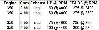

Yep. The 1971 and 1972 engines were essentially the same, with the following power ratings (SAE NET specs):
These are the 1972 numbers that are broken out by carburetor and exhaust, whereas the 1971 specs just show the dual exhaust 4bbl with both GROSS and NET numbers.
GROSS = 260 HP
NET = 200 HP
