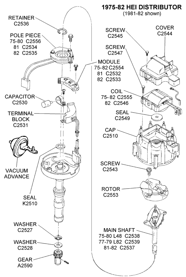

Originally Posted by herkguy
If it is an after warmed up, maybe HEI coil or module is having issue when hot. If you have another set try that if you think ignition is cutting.
^^^THIS^^^
Next time it dies swap the HEI module and report back. Make sure you use the thermal paste on the bottom of the module.

Even though it is likely fuel, try running with the vacuum advance disconnected. If that stops the symptom the pole piece with the green and white wire in the distributor is bad.

check the wires on the pole piece they used to break and would be held together by the insulation around the wire when the vacuum advance would move the wire would open
