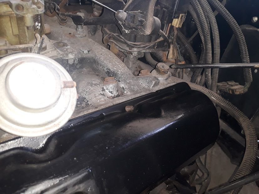

1. NO CAT - Mine does not have a catalytic converter (long gone) and it is also emissions exempt, therefore I have taken off the Air Injection pump and the plumbing.
I have the AIR injection ports closed as below.

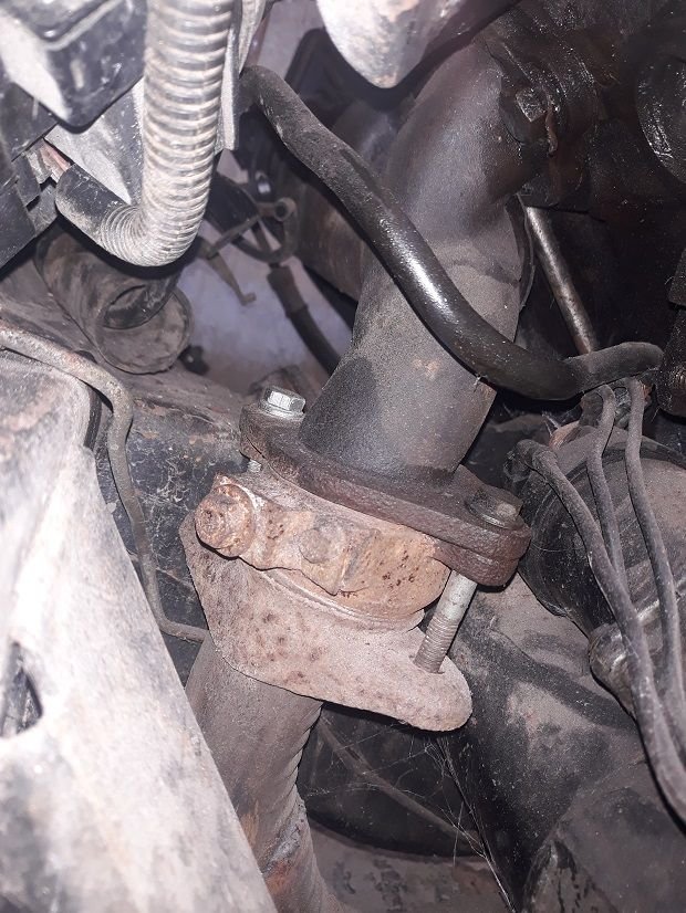

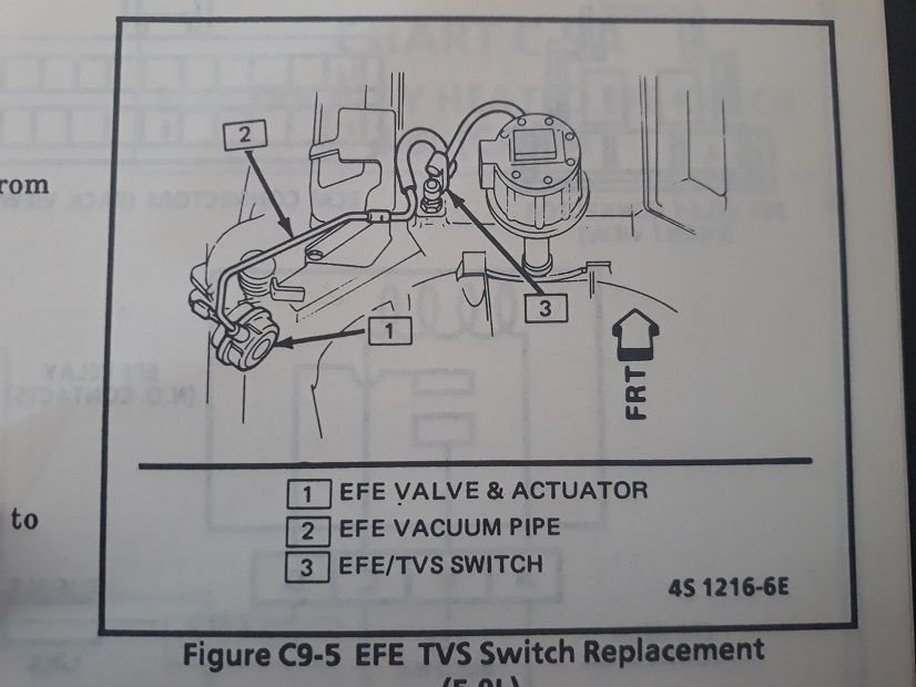

2. NO HEAT RISER - I do not trust a valve that sits in hot air and soot to function a long time without getting stuck. Also, I live in a tropical country therefore cold weather operation is not applicable. Therefore, I have taken off the valve mechanism, of the (EFE) or "heat riser valve" and kept its body because that's needed to connect the exhaust manifold to the exhaust pipe.
The valve

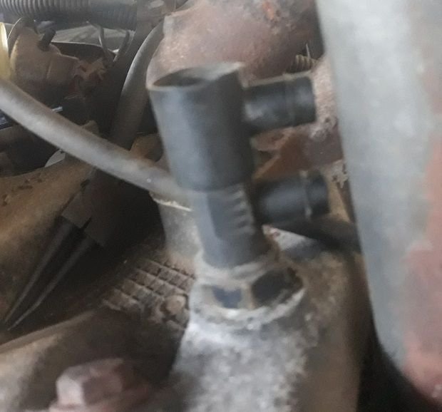

My EFE (early fuel evaporation) / TVS (thermal vacuum switch) was broken, so I am using epoxy glue to close that hole on the top.

Thermal Vacuum Switch (TVS)
Therefore, the TVS would be kept (to keep coolant leaking from that port), but the charcoal cannister and the CCV below (cannister control valve) would be removed.
