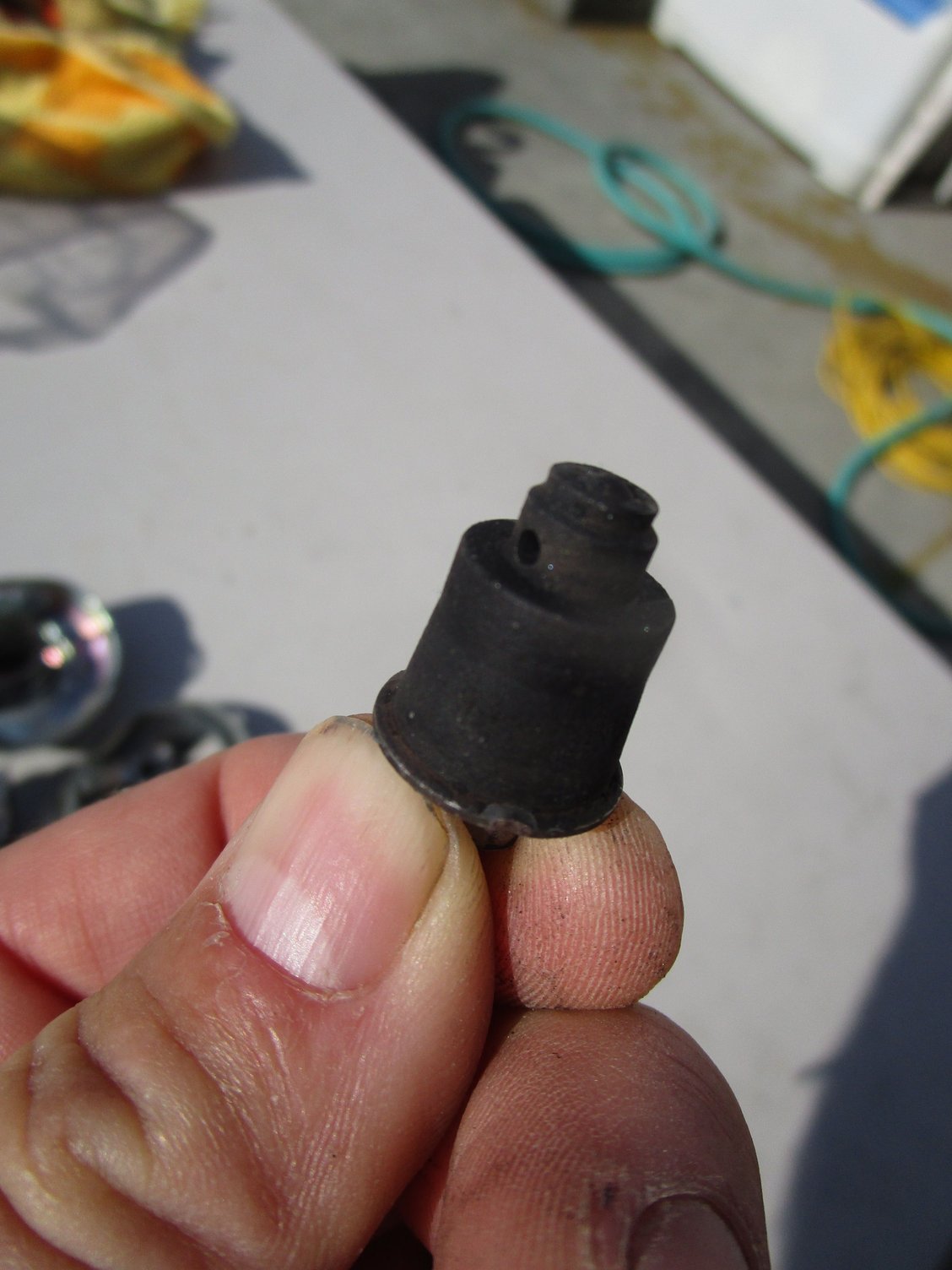

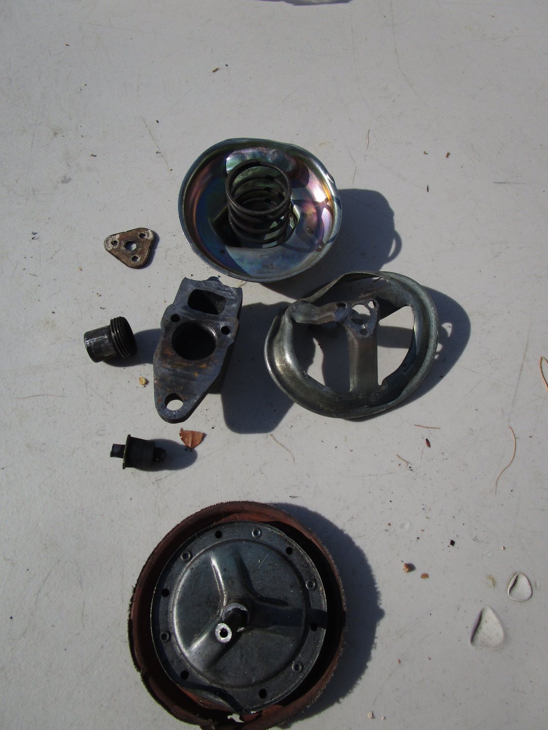

I had a curiosity of what in the insides look like of a typical smog era V8 back-pressure EGR valve.
took it a part and also cutoff the pintle tube.
If you look at the end of the pintle, there are two small holes across from each other.
The backpressure of the exhaust goes through these small pintle holes and up the pintle tube , and then along with engine vacuum, the pintle is lifted off the seat to allow exhaust into the intake smog tubes, lowering the temperature of the combustion chamber and reducing NOX levels.
These small holes are easy to get plugged up, and EGR not work.
