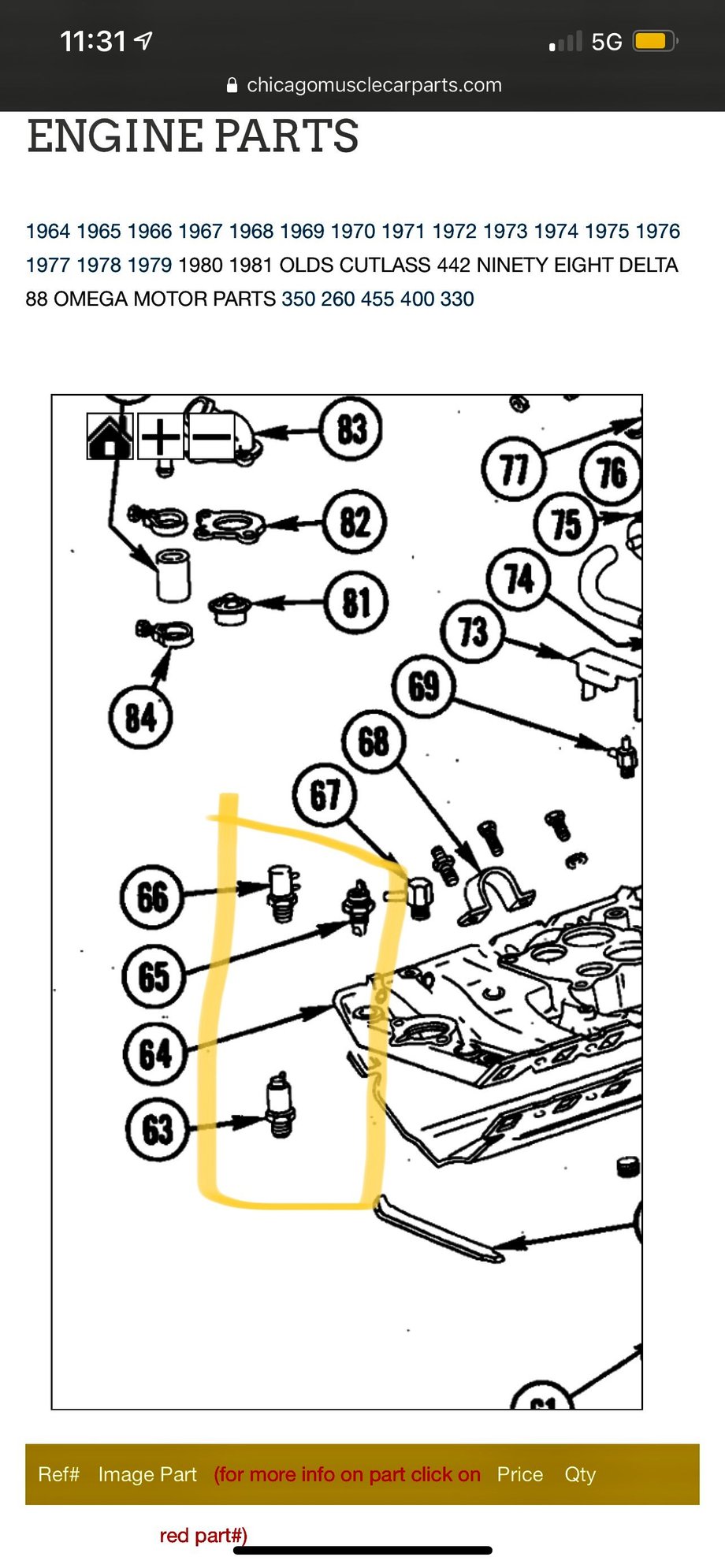

Can anyone tell me what these three are called ? I’m trying to find them. I took my car to a mechanic that completely fucked everything up.
Old Aug 6, 2021 | 09:30 AM
acavagnaro's Avatar
Joined: Aug 2014
Posts: 838
From: Western North Carolina
66 was referred to as a ported vacuum switch. Available aftermarket but originals are hard to come by. 63 and 65 look like oil pressure and coolant temperature sending units.
The ported vacuum switch was installed in the intake manifold in the front right corner (at least on 69's) and plumbed with vacuum lines to multiple locations. Should have at least 3 'positions' or line locations on the body. The oil pressure unit should be in the bulkhead just behind the water pump. Coolant temp sensor should also be located in the intake near the thermostat housing. Both 63 and 65 would be electrical connections to the engine harness. A different oil pressure sending unit was used for the Rallye Pak option but that's not what's shown in your diagram.

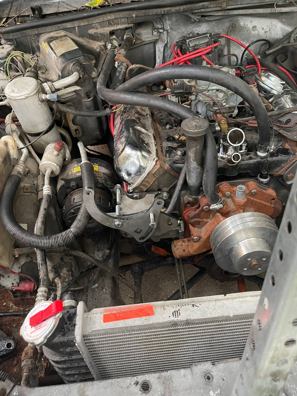

b
Okay because this is how he hooked it up so far.

You don't need any of that stuff just to get it running. The emissions equipment won't be connected, but the engine will run. The fact that the clown working on the car can't even figure out how the heater hoses should be connected suggests that you should take that car and run, don't walk, away. Sorry, but that is completely f'd up.
I don’t know a whole bunch about motar work but i knew when i saw that i knew it wasn’t right.
