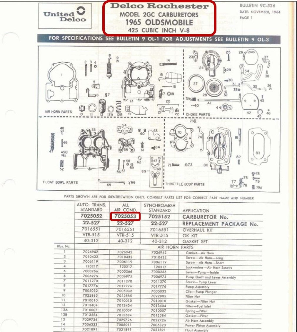

The 5053 is a 2GC while the 5054 is a 4GC.
Old Jul 18, 2021 | 03:41 PM
Posts: 25,800
SOURCE: http://www.newagemetal.com/pages/Old...5OldsPart2.pdf
