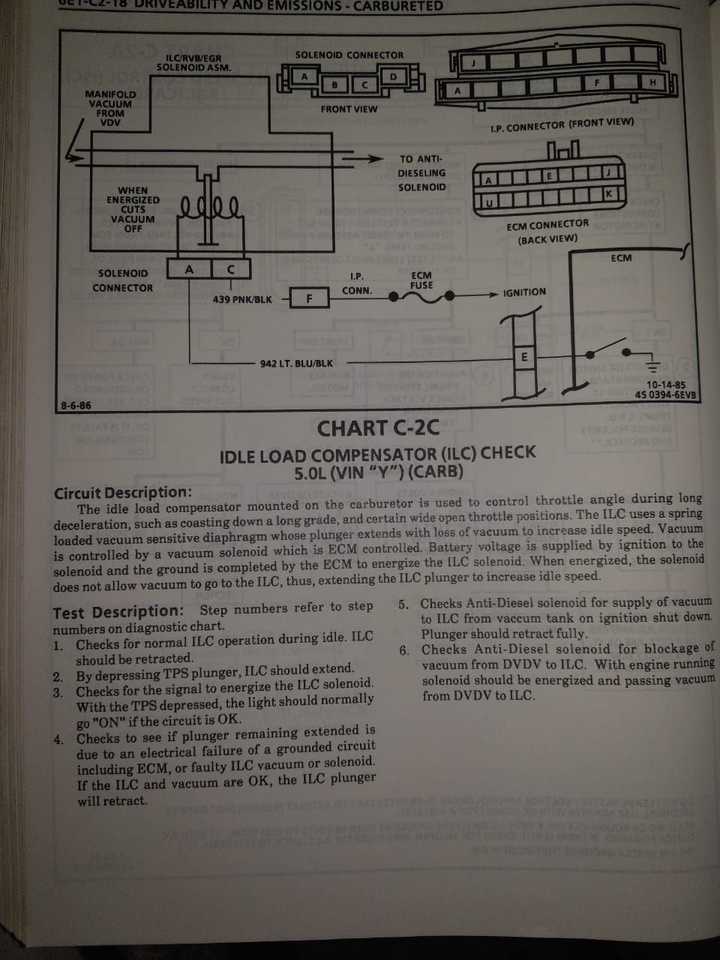

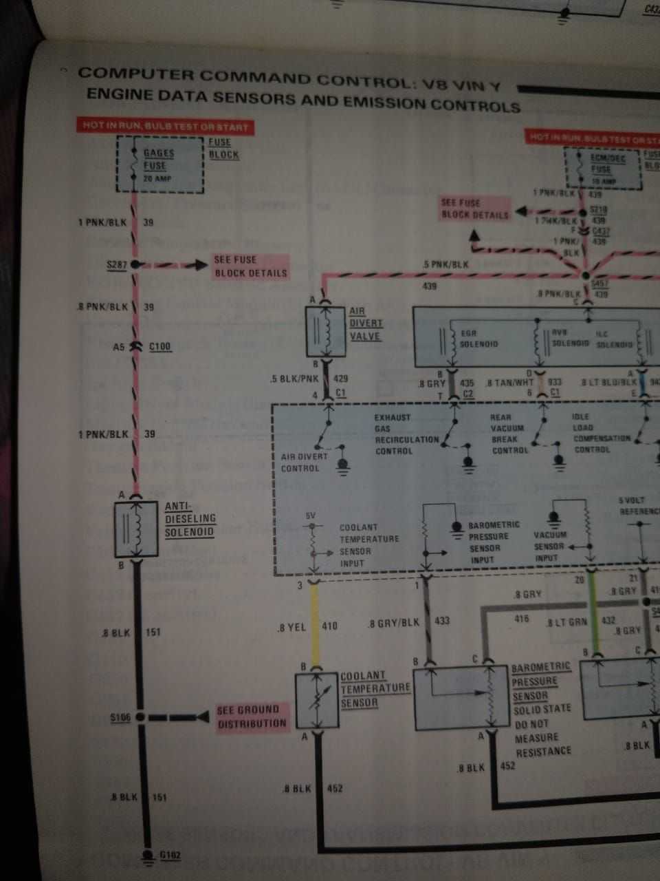

Hi friends,
Part 1
The ILC solenoid vacuum line goes through the VRV, DVDV, anti-diesel solenoid (ADS) {in turn connected to the Vac tank (VT)} and then to the ILC mounted on the carb.
What exactly is the mechanism of each item? (VRV, DVDV, ADS, VT, ILC) Also, what will happen with the failure of each?
Part 2
If I were to remove this ILC circuit entirely and use an "IDLE KICK UP solenoid" as DoubleV explained here, can I power that idle kickup solenoid from the ECM signal line instead?
That means, when vacuum drops, the ECM would signal 12V to the ILC solenoid to actuate (cut off vacuum -> extends plunger), but now it directly activates the kick up solenoid, which does the same. Kicks up idle.
Vacuum operated ILC extends its plunger when vacuum not present, so when you turn off the car, ECM turns off, no supply to ILC solenoid, so ILC plunger pushes the throttles open.
This necessitates an anti-diesel solenoid and the vac tank.
Should not be the case with an idle kickup solenoid. No power to ECU, doesn't push the throttles open.
What do you all think?

Actually, both my VRV and DVDV doesn't work. Anti diesel solenoid (ADS) partially works. This is why I needed to dive deep into this mechanism.
I went through the CSM once again and this gentleman on FB explained the function of the ILC really well, and it isn't as simple as an idle kick up solenoid.
It's quite interesting and I am sharing that information to whoever finds this helpful.
An idle kickup solenoid just bumps up idle when supplied 12V. Could be easily wired up to AC compressor relay. Job done.
ILC gets no vacuum when engine is off. The plunger is fully extended by an internal spring. This keeps throttle plates pushed slightly. (to an idle up position)
When engine is started, ILC gets vacuum. Therefore, the vacuum pulls the plunger against the internal spring, and it is retracted, barely touching the throttle plates.
When engine has various levels of vacuum, the force on the ILC damper by the vacuum also varies. So, the equilibrium of forces (spring vs vacuum) modulates on varying engine loads. This modulates idle RPM ever so slightly for various load conditions. (actually, it's pretty clever)
When ECM power the ILC solenoid, it cuts off vacuum completely to the ILC, so the plunger is fully extended.
When you turn off the car, ECM has no power, ILC solenoid has no power so in turn, the ILC extends fully, so throttles open, and dieseling can occur.
Anti diesel solenoid is 12V when key is ON (it's not ECM controlled).
When car is turned off, it supplies vacuum to the ILC from the tank reservoir to keep the plunger from extending. (stops dieseling) - see point number 5

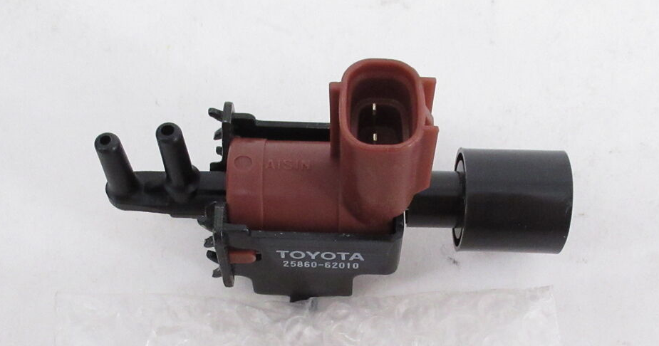

Since this is the case, I do have few of these vacuum switching valves lying around and maybe I can use one instead of the ADS. Still no clue how the VRV and DVDV (or the lack of those) should affect the drivability.
