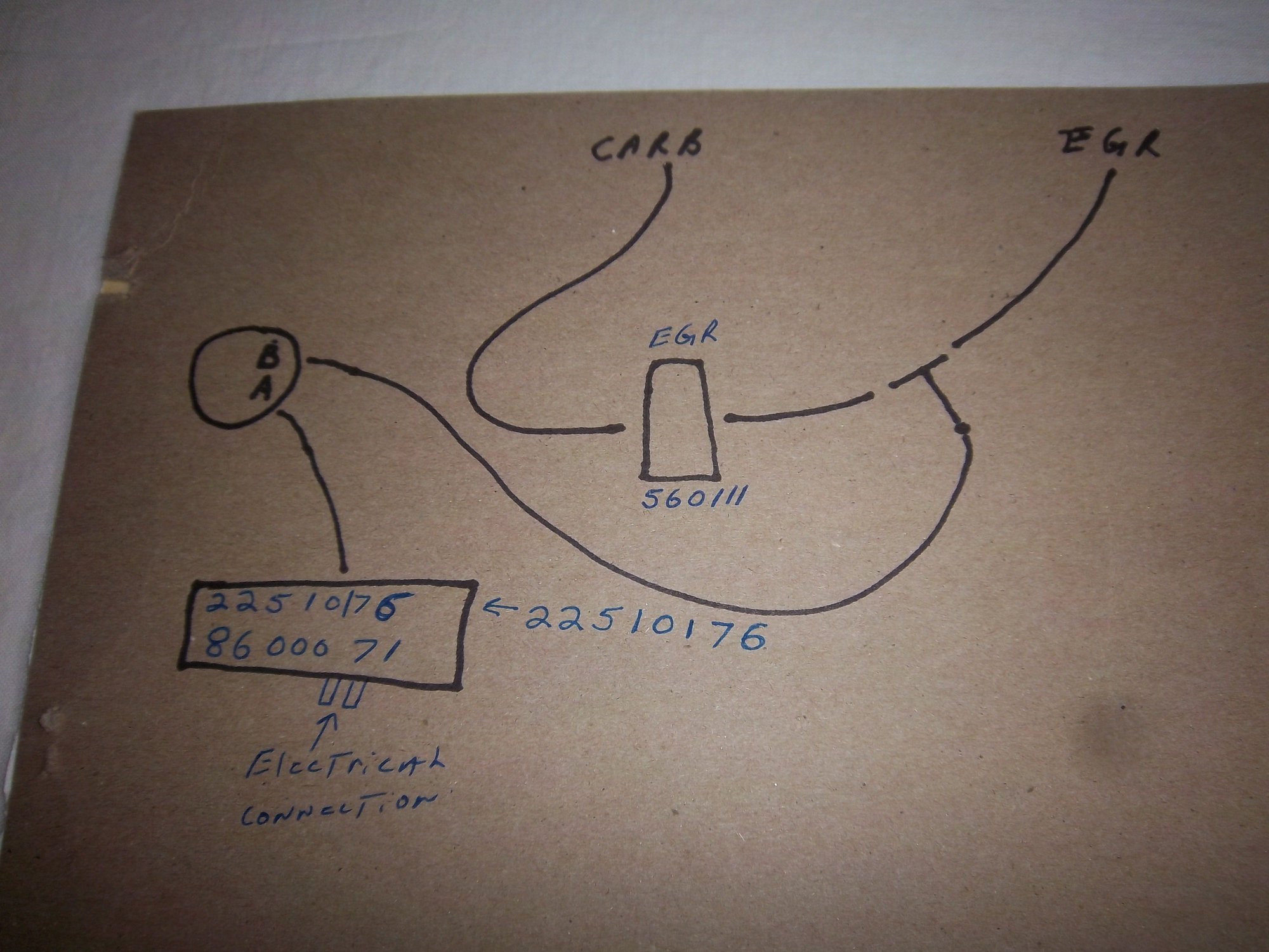

There is already lots of good info on this site about this topic , but i am still unclear on a few things . My EGR valve failed so plugged it off for now . no ping that i can hear , so not sure if i will replace it or leave it plugged off ? seeing that the EGR is plugged off , to take a picture of the EGR system i removed all hoses and everything attached .
I think the vac line from carb to EGR has to be a ported vac outlet from carb. in that line there is a Black and thin yellow item ? i labelled C , maybe a delay? C sits on top of water pump , so thermal switch ? . then a T vacuum fitting after letter C not before ! then the vac line goes to A it rests on a valve cover so a thermal switch ? then to an electrical vacuum switch i labelled B . maybe the carb only has one ported vacuum connection so they had to T into that EGR vac hose . question what is the electrical vacuum switch for ?

Thanks 69HO43 for the info on the 560111 thermal valve , and how to test it . this thermal switch on my car sits on the water pump with a metal cover over it , maybe the cover is to keep it warm or warm it up faster .
so still do not know what the electrical vacuum switch is for . So no other car owner on this forum has one ? OK so what possible things could it be for ? please thro out any ideas and i will test / trial any idea . To recap what we know for sure , it is hooked up to ported vacuum . The vacuum closes or opens to send ? or receive ? an electrical signal . thats a test with a multi meter is it normally open or closed with no vacuum ! then test again under vacuum . So could it receive an electrical signal from temperature sender ? or send an electrical signal to ? distributor or Transmission ? what else could it send a signal to ? seeing that we do not know what its for i put it all back in place , but vac line to egr plugged off . another test could be a one piece vac line from ported outlet to the electrical switch as maybe one or both of the thermal switches have failed and see if i notice anything while driving. i purchased a big roll of vacuum line to replace old line and use to test ideas .

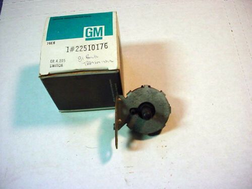

Old Sep 22, 2021 | 10:38 AM
307-5a's Avatar
Roy Ale
Posts: 120
From: Victoria B.C. Canada
ooops i had posted the wrong part number , no wonder no one could help ! checked part again , then was easy to find part on internet , found above pic s on net think it says 81 Buick , so this electrical vacuum switch is for the transmission converter lock up . But this makes it harder to find as it is on emission hose diagram. . So this switch has to go back on . Ok next Question does it really need the thermal switch 22505499 between this trans lock up vac switch and carb ported vac ?

Tested trans electric vacuum switch with no thermal controls , as there were two thermal controls in the vac line , so a vac line to carb (ported) . ran car down hi way , that did not work well at all seemed like trans was stuck in 2nd gear , maybe to much vacuum ? so stopped car unplugged vac line from trans electrical switch , car then ran at hi way speed no problem . So maybe one of the thermal controls also reduces vacuum ? or between the two of them they reduce vacuum . tested trans electric switch with a piece of vacuum line and sucked on it , it takes very little vacuum to make switch close , or maybe switch is old and tired ?

It appears it has something to do with allowing lockup when that thermal vacuum switch is open to allow vacuum to the EGR/vacuum delay valve lines. It likely is taking the place of the ECM-controlled lockup signal to the transmission. You have to be in a certain throttle position with certain vacuum and maintained and over a certain temperature, maybe in a certain gear level, then the solenoid locks up the converter? Then letting off the gas kills vacuum signal, switch drops out unlocking the converter again. Similar to alternate TPS? I dunno. Not familiar with non-CCC Canadian operation of the 200-4R.

This is a picture of the Blue and mostly black Vacuum control item , number on it 22505499 , it must be thermal as it lays on the valve cover , notice it is marked A and B , so maybe directional ? and interesting the T for the electrical / vacuum switch is after 56011 , so the electrical vacuum switch needs ported Vacuum and both 56011 and 22505499 vac controls ?
Question what is the Blue and black vacuum control how does it work ?
