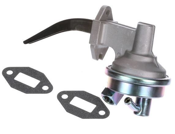

On my 72 CS the furl pump was leaking so bought a new one. Cranked the engine and let it idle and the Quadrajet started overflowing. Would run smooth at 2000rpm but would flood the carb at idle.
Been having some issues with the Q-jet so put a known good Holley 650 on it. It loads up at idle but clears up after a short drive.After cool down it again loaded up at idle.
Finally borrowed a pressure tester and the pump is outputting 12 psi. HUH ?????????????????????
The Oreilly pump was for a stock 350 but shortly thereafter discovered that the engine is actually a 307 replacement by the previous
owner.
Question: Should a stock 350 mechanical pump output be 12 PSI? Did I get the wrong pump or a bad pump?

If it matches the number of lines that came on the car, it won't care whether it is a 307 or 350. It sounds like a defective pump, I have only experienced the end, a new pump that couldn't keep up with a stock 307!

Thanks guys for confirming that 12psi is too high. The Oreilly pump was their house brand so who knows the mfg.
I ordered a Delphi MF0024 which shows a 5psi rating on RockAuto to replace the Oreilly's pump

The Delphi pump I ordered is not threaded deep enuff to seat the double flare. Tried 3 different flare nuts. I'm going to grind the first thread off of a nut and see if that will allow it to seat.
Nah. Pump is going back
