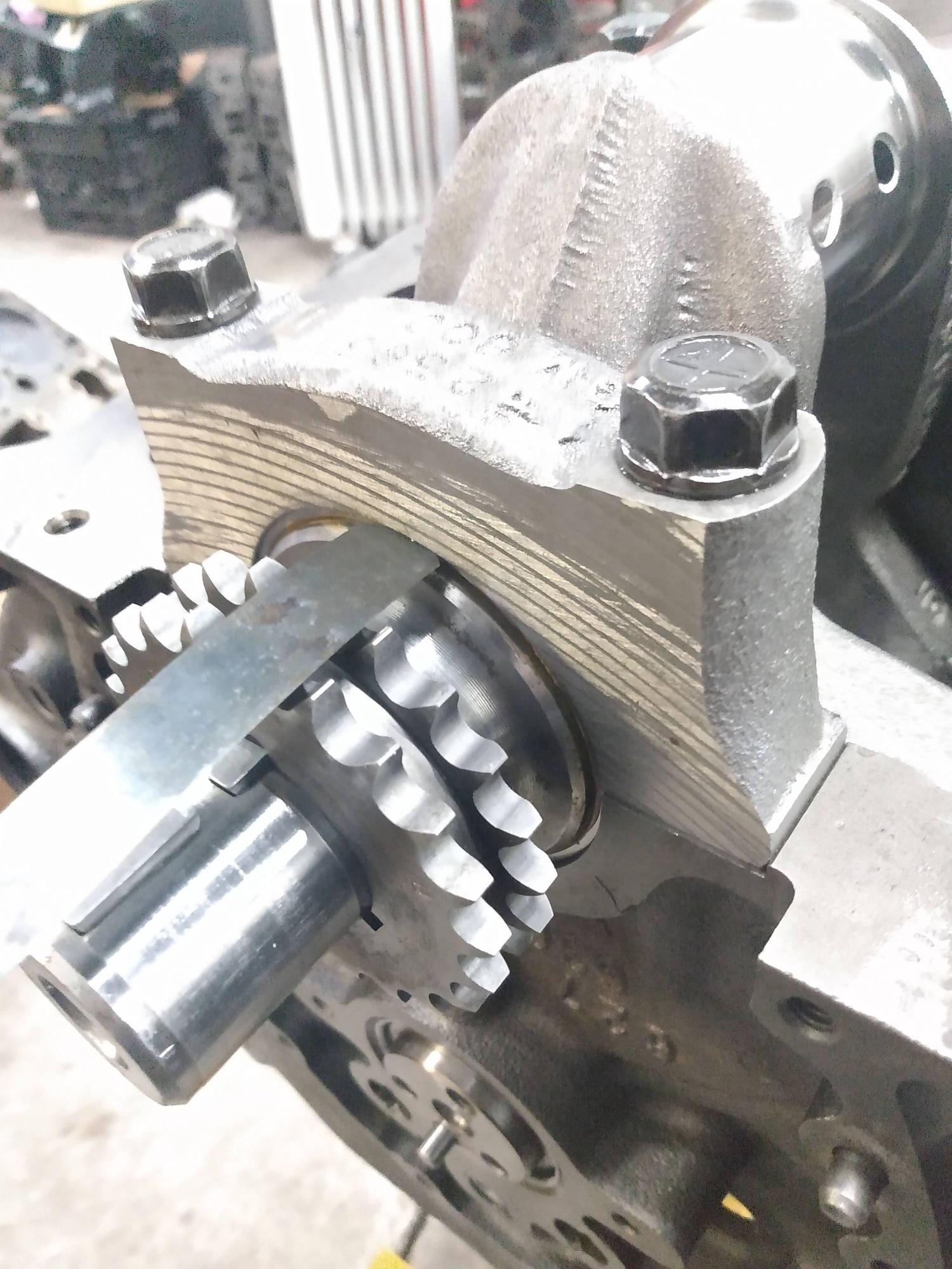

A lot of guys laugh at this method but for a DIY that wants to just double check their measuring methods take a .002" feeler gauge and slide it in to the front main as shown in my picture and then torque the cap. If you can pull the feeler gauge out you know for sure that you have at least .002" clearance. I used the .002" as an example. Depending on the clearance you are shooting for it might be something else. In my case if a .002 will pull out but a .003 wont, it gives you an idea of what you have.
Of course you can only do the front main but it might make you feel better about your measuring method.
I will also add that Plastigage is actually pretty darn accurate on the mains.
