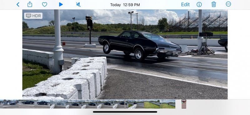

Saw this on V8Buick, 11.50 with a 400,C heads, cast iron manifolds, wicked launch..

Neat build and car. Some original bias ply tires would take care of that twist problem.

11.50 with no second gear? Holy cow.
Old Sep 24, 2023 | 08:01 PM
Posts: 15,409
I’m trying to understand exactly how that short shift happened. Doesn’t make sense with the information presented.

The post says that the car twisted so bad that it caused issues with the column shift, resulting in a miss shift 1 to 2, going straight to 3 that resulted in a large rpm drop.

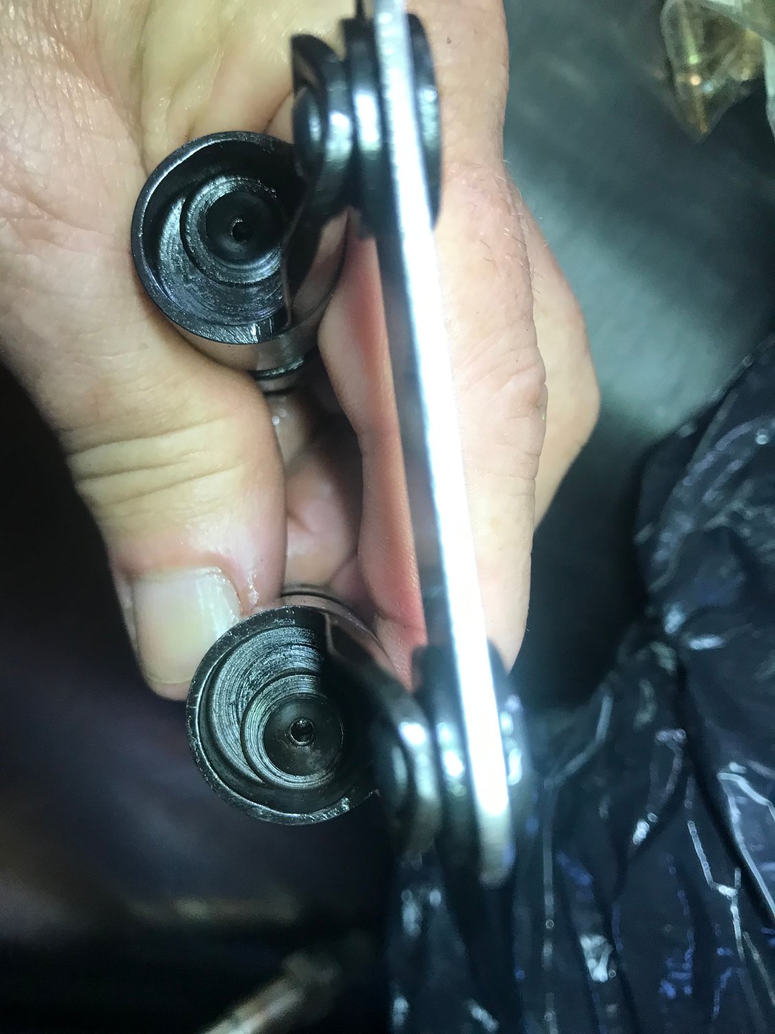

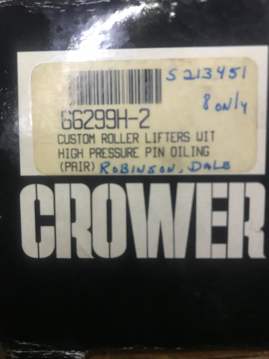

yes..it’s past the thought stage. Been doing it off and on for a while but other builds keep slowing me down..I’ve got the body which will be a 69 H/O clone and will be able to switch back and forth from the big block class to small block 69 W31
it’s costly because it will be competitive. Stock block for each build. Big Block has billet caps&girdle , it will get this Moldex billet 4.850” crank, with a 4.200” bore for 538”. GRP al rods. Big comp 800” sr, offset cup crower lifters. Lots of welding on the D heads. The cast iron intake has been cut down in weight from 80 to about 40lbs…can’t show pics of that until it’s finished 😉 and closed back up.

I assume the offset lifters allowed you to move the push-rod location in the heads to maximize cylinder head flow? Are the lifters custom or were you able to use an existing lifter?
Yes on the reason..custom .180” offset high cup location
