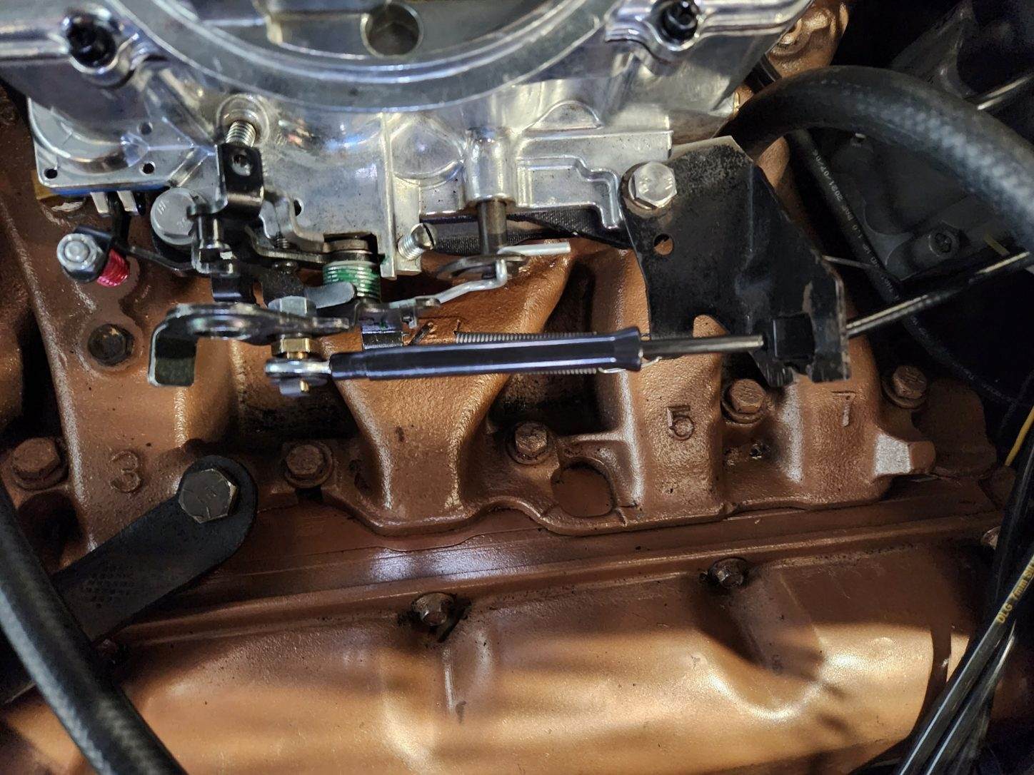

Looking for an end all-be all answer on this.
I am running a Holley style carb on my 400. Currently, I am running a new throttle cable from Inline Tube for the '69. I have taken an old throttle cable bracket designed for the Qjet, and cut it to allow it to be bolted via the 1 bolt on the carb
This leads me to two questions:
  • Is there a certain distance the cable and the bracket need to be away from eachother? I'm not 100% certain I am getting to WOT based on where the cable is bottoming out against the bracket
  • If the throttle cable seems to almost "loop" between the bracket and the firewall, is that a for sure indication that I need to go to a shorter cable?
I've seen many different answers on this, just trying to find a solid one not just for myself, but for those in the same boat moving forward.
Thanks.

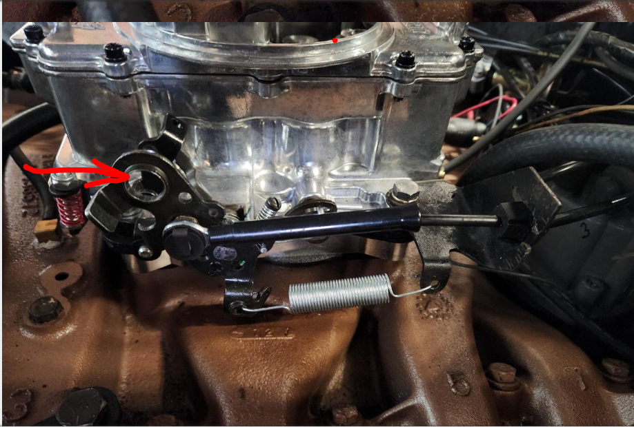

Currently, you don't have enough travel. This is obvious to a trained eye.
To verify WOT is WOT have someone mash the gas while you take a peek down the carb, (engine off of course). I'll bet you are getting ~1/2.
Use the hole indicated by the red arrow below with the bushing kit Eric shows. This may buy you enough travel.
As wr1970 said the modified bracket WILL move as the gasket settles. Ask me how I know.
If you keep tightening it you will warp the carb.
I like the spacer wr1970 made.
You will need another bracket or a way to pin this one to the throttle body...if the current position will allow WOT with the cable mounted in the forward hole(red arrow).
Several vendors offer custom adjustable brackets and various-length cables.
FYI The OEM 4-barrel cable should be ~23 1/4" long, in total, (The 2-barrel carb cable is shorter, ~20 1/2 - 21").

initially I had the cable in the top hole, but kept having issues with the throttle catching until I got the right stud on there. What do I use to fill the hole?
Also, yeah..the vacuum advance is backwards..thats another issue on the off-season to-do list

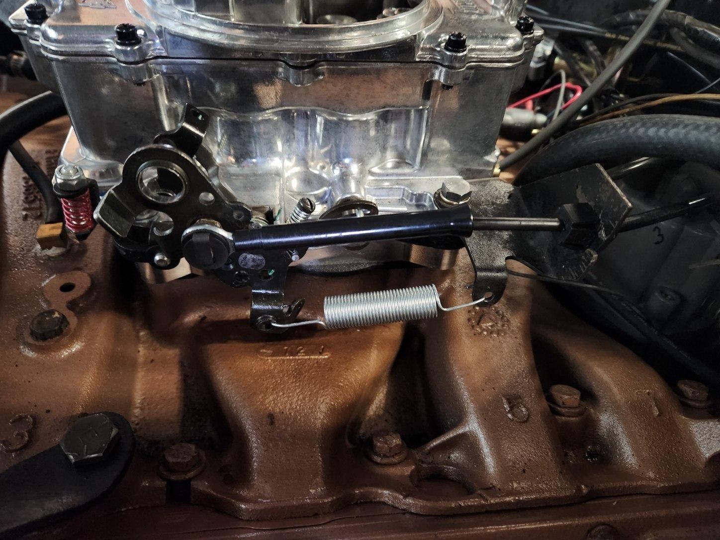

Just went out and put the spare bracket on the Qjet and measured from bracket to stud, and it measure 6 1/2". Measured the current setup on the car and it was about 5 3/4". Moved the cable to the top hole and it's bow reading 6".
Gonna look into a bolt on top option to gain that extra half inch, in addition to figuring out how to lock the cable into the linkage at the large hole.

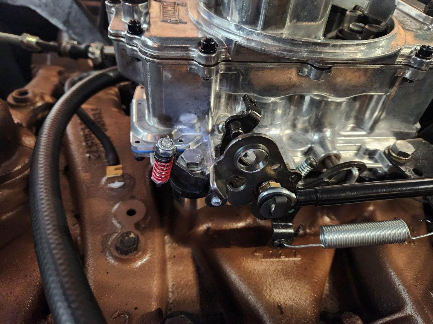

Went back out and re-measured as I'm having a hard time finding a bolt on (top) option that doesn't include kickdown or anything like that. I spun the bracket as much as I could, and am now reading 6" from outside of bracket to center on the bolt at the linkage arm. To compare, I bolted on the bracket to the Qjet and remeasured from bracket to center of post where the cable attaches at 6 1/8". I can't imagine an eighth of an inch creating that much of a difference regarding WOT, but I'll verify once the stuff comes in to actually hook the cable up properly

Put the new springs on and got the cable in the right spot for the throttle arm, just gotta figure out the bracket and I think we'll be golden.
