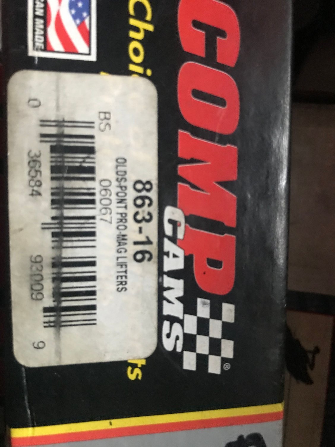

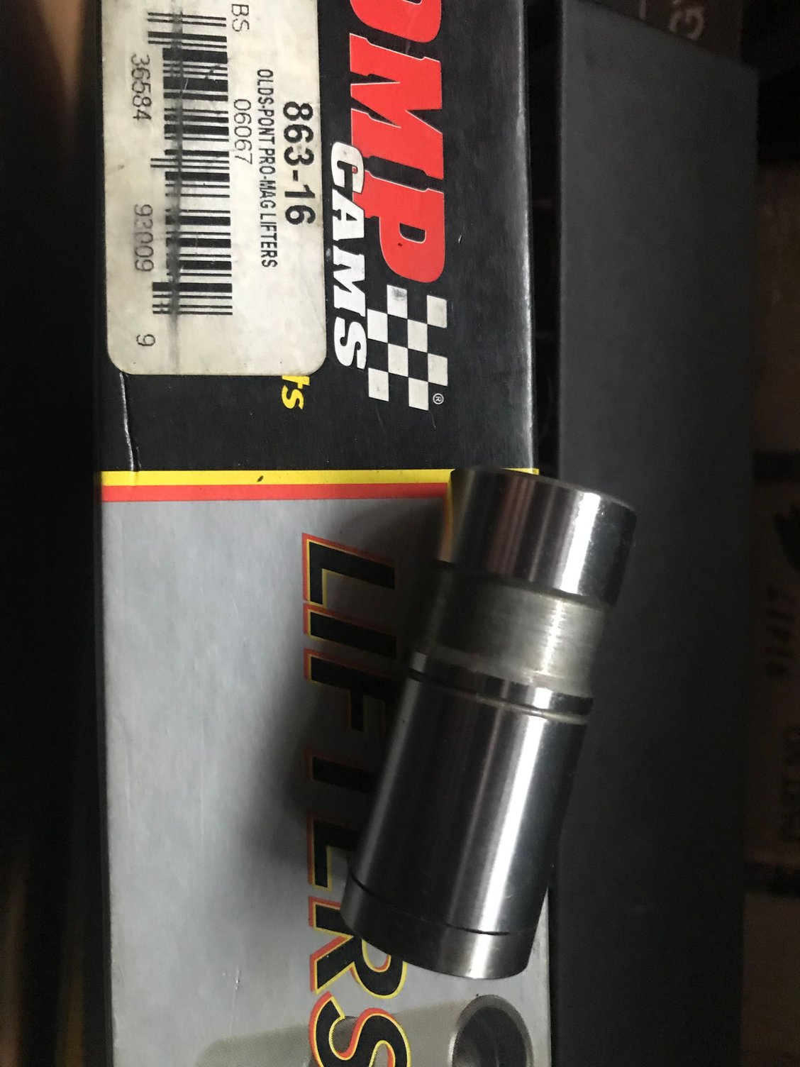

I try to only use hard face bottom lifters. Comps pro Magnums are hard faced. Anything over 300 open I get the core nitrided. That combo lasts for years
h
