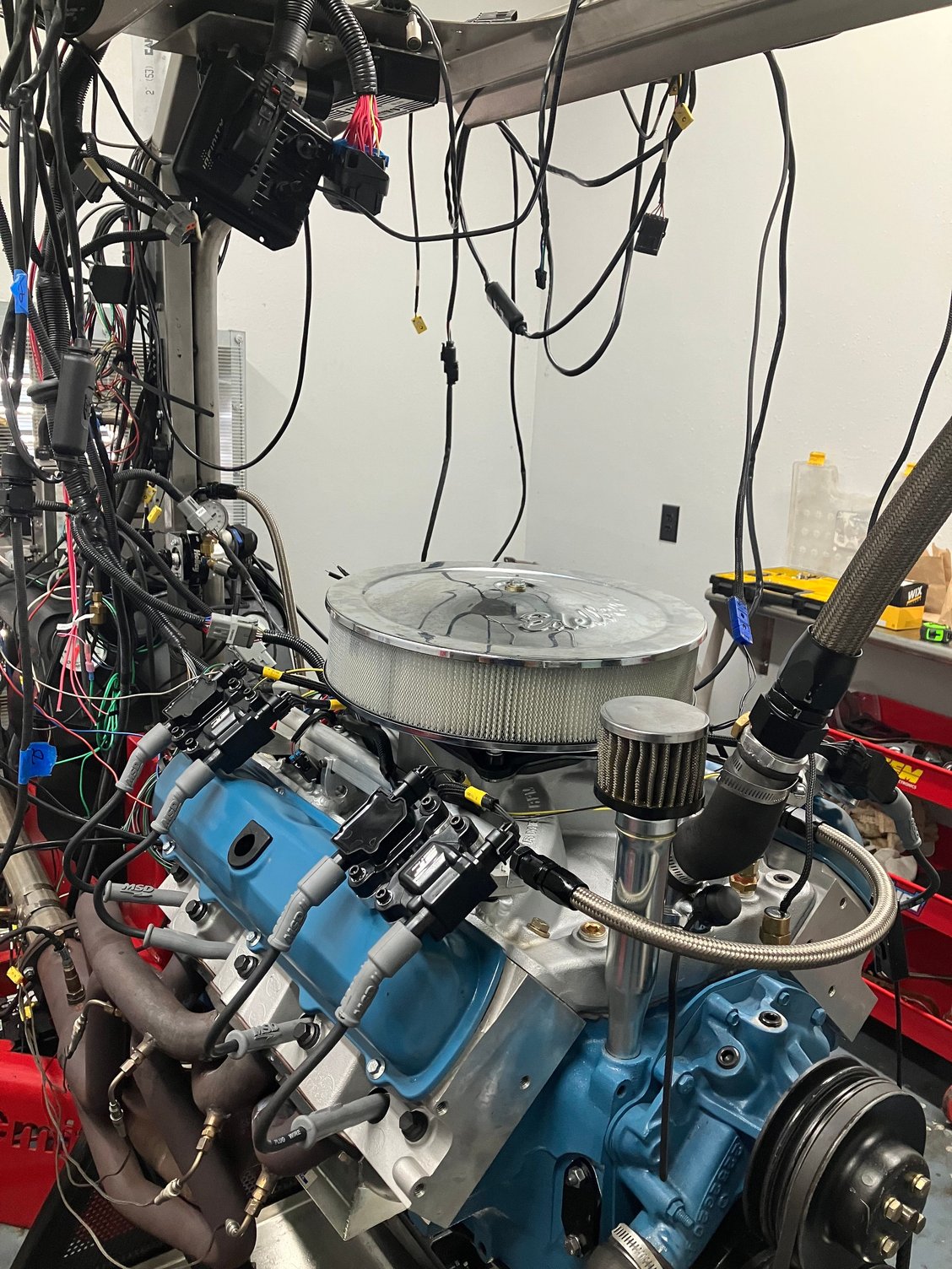

Does that dyno have the auto load brake controller or the manual one?
Auto load. The valve is back by the pump, not in the console like it was originally.
It has a servo for both the load valve and the throttle so it can simulate “track” conditions.
For the record, I’ve had this engine off and on the dyno now three times. Once for initial run in, once for a bad main ECU harness, and this last time just to make sure it’ll fire and run right out of the box as it’s supposed to. Every time the corrected hp was within 3. It averaged 512. Do the math, that’s less than a 1% variance.

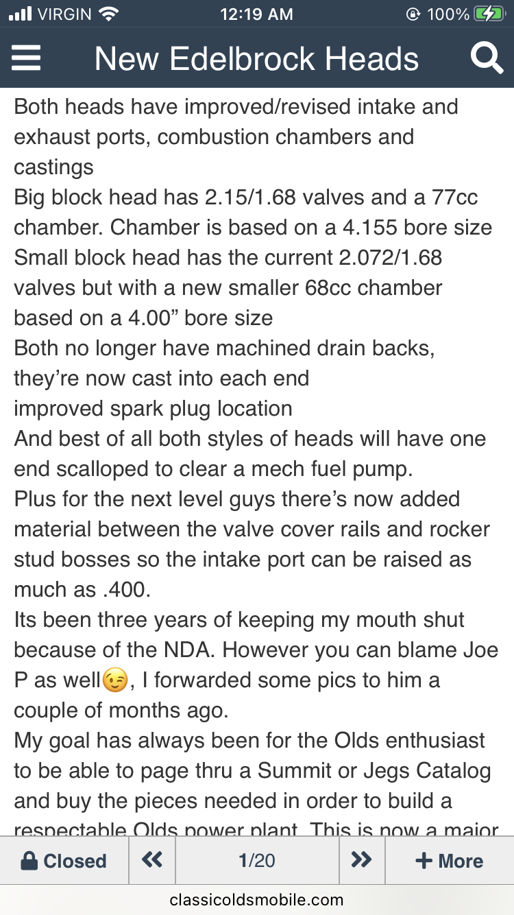

Virtually the same as the previous generation Olds head. For the umpteenth time, this is essentially the earlier head with a smaller, redesigned chamber, and a few other enhancements. But the original 198cc runner(it was advertised at 188, it was never 188) is virtually identical to the Gen II head.
However now the big block head has a 218cc runner. They moved the inner wall back to gain the volume.
That’s not what you said in January 2021. You actually said both of these new heads have improved/revised intake ports. That’s why I asked and why others have asked .
you need to get your stories straight. So don’t pull the “umpteenth time” thing on me like I’m an idiot. Here, this is your words

what I’m looking for is the info on the improved/revised intake ports. He said it back then… but now says they are virtually identical to the previous heads.
I wouldn’t have asked for any info if I knew there was no difference.

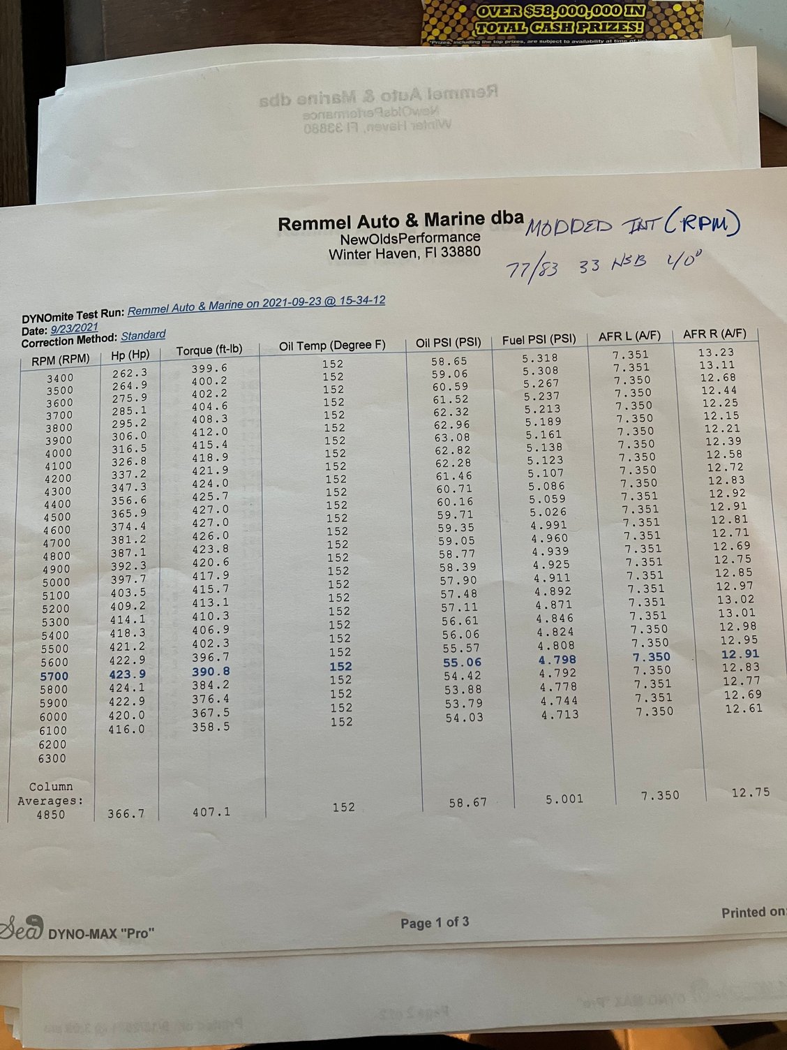

Dale, Port entry is the same, aka cross section at the pinch point. There were some minor modifications beyond that.
The exhaust port got more improvement than the intake. Flow changed as much from chamber redesign as anything else, and it wasn’t by much.
The main changes were, in no particular order, chamber, ports, added material up top, cast in drain backs, relocated spark plug and scalloped end.
RPM Dyno sheet. “Modded” intake is center divider cut 1 1/2”, and splitting the difference in port size at the flange. Not a full match of port openings. For a street application this is the way to go imo.
Hope this helps to clarify things.

Why not post the setup page? The TQ peak RPM seems strange on the first test you posted? Your HP and TQ could be correct, I'd just like to see how you arrive at those numbers with the supporting evidence via the setup page, nothing new here with me. BTW-how do you feel about the front half of your engine being supported by a round pad under the front bottom of your oil pan?

Why not post the setup page? The TQ peak RPM seems strange? Your HP and TQ could be correct, I'd just like to see how you arrive at those numbers with the supporting evidence via the setup page, nothing new here with me. BTW-how do you feel about the front half of your engine being supported by a round pad under the front bottom of your oil pan?
I’m fine with it cuz the rear plate is 1/2” thick and bolted to the cart with a half dozen 1/2” bolts.
And just for everyone, the SF 901/902 brake is virtually the same one GM used in the 80’s. L&S is a much newer billet design that doesn’t heat the water nearly as much as the SF ones do. Way more consistent. Plus there’s no servo that you have to constantly adjust to adapt to different engine applications.
Take a cruise around the internet, there are more than a few top name shops and engine builders using this very same Dyno, with no issues, ie Island Racing Engines in the NE. He does 3000hp blown alcohol stuff with the 19” version of mine, loves it. The guy I bought this from got a SF Powermark. Ran the same engine on both(425ci SB2). L&S showed 807hp, Powermark showed 817 after a rocker ratio change.

Awesome! Thanks for the data.

Who cares. You’ll have the software issue “figured out”?. This from a guy who never noticed the relationship between hp and tq after countless Dyno pulls. Wow!
And what happened to the 30hp discrepancy mentioned earlier, now it’s 15? So what is it really?
The only thing I would ask is please don’t post it here. Post it in Non Olds where it belongs. I’ll bet not too many care what you post anyway.
I tested the same 496 back to back on the Powermark first, 669 HP 675 TQ, then on "dynamite" 684 683 TQ. The "dynamite" you enter the corrected barometer, then "dynamites" computer takes the corrected barometer and turns it into the uncorrected barometer, heres the problem: "dynamite" would show the uncorrected barometer @ 27.95 when it was really 28.80 hence the discrepancy in HP between the two dyno's. Of course you can manually enter the correct baro which is what we did, then the power became closer, but theres other adjustments on that page you refuse to show and those adjustments are what I will be honing in on.
Here are the facts. You can change the set up page on the superflow the same way you can on anything else. You know it and I know it. In fact I asked that very question of Bill Trovato on his Facebook page awhile back. He had two comparison Dyno pulls that were vastly different and didn’t make any sense to me. He admitted that he entered the wrong info on the set up page, but he never showed me or anyone else what he did. He has a super flow Dyno like yours,
So, seeing as how you continue to hold me to a different standard for some stupid reason, I’ll make you a deal. If you can get Bill Trovato, Dick Miller, and any of the other Oldsmobile guys to start printing their set up pages whenever they post a Dyno sheet to make the playing field even, then I’ll give you mine as well, I promise. How about that? Otherwise you can take a long walk on a short pier, please.
