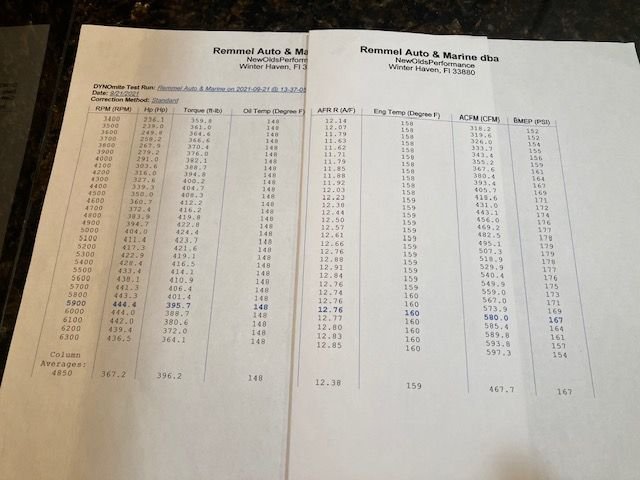

Attached is the Dyno sheet from my 357 mule with the new small block Edelbrock head.
To recap, the combo is;
Mahle 4.100 10cc piston, 9.2:1 compression
Mahle MLS head gaskets
Molnar 6.00” Olds rods
Crane 222/228@.050 Hyd roller, lift is .555 on both, 110lsa
This run was done with a stock Victor and 750 VS Brawler carb
My 1.6 rockers were used as well as .145 wall 3/8” pushrods.
All pulls done on 91 pump gas and at 500/sec.
Heads were totally and completely stock, untouched other than to check chamber volume.
As is typical with my Dyno sessions as well, engine was run with 3’ of 2.5” pipe and Magnaflow mufflers.
Needless to say, with more compression and cam, I think 480+ isn’t out of the realm of possibility. Not bad for a pump gas, off the shelf SBO build. Btw it made 424hp with an RPM intake, same carb.
Let the bickering and nit picking begin.

Old May 8, 2022 | 03:16 PM
HighwayStar 442's Avatar
Joined: Jan 2013
Posts: 1,816
From: Laguna Vista, TX
Nice. N crank?

Old May 8, 2022 | 04:34 PM
fleming442's Avatar
Posts: 3,889
From: Mt.Ary, MD
Why so short on cam duration? I would think it to be more in the 236/242 range
Old May 8, 2022 | 04:57 PM
cutlassefi's Avatar
Posts: 8,505
From: Central Fl
Simple, this was my test mule patterned after a majority of the builds on here. When I put it together I wasn’t sure of the status of the new heads.
To take it one step further for all the Engine Masters fans on here. Their 383 SBC Chevy test mule has 10.2:1 compression, a Victor intake, AFR heads and a 242/248 Comp roller. It makes 480/445 with just a short 3.00” pipe and no mufflers. I think my combo is pretty damn impressive, considering.

Old May 8, 2022 | 07:17 PM
VORTECPRO's Avatar
Joined: Aug 2012
Posts: 1,878
From: Thousand Oaks Ca
I've dynoed two times on "dynamite", there is a setup page, I found this dyno to read 30 HP high due to the dyno software taking the corrected barometer converting it to the uncorrected barometer and being full point low, then theres the foot under the front of the oil pan. Hopefully you have the barometer entered correct so your data is accurate.
Old May 8, 2022 | 07:21 PM
VORTECPRO's Avatar
Joined: Aug 2012
Posts: 1,878
Not with 9.2 compression........
Old May 8, 2022 | 08:01 PM
83hurstguy's Avatar
Posts: 1,434
From: Chicago
Nice numbers for a low compression, stock stroke 350. I'd say those heads have potential.
Old May 9, 2022 | 06:39 AM
cutlassefi's Avatar
Posts: 8,505
From: Central Fl
I would expect a response like this from someone like you.
And for all, Superflow dynos, like Velcros, have a setup page too.

Old May 9, 2022 | 10:57 AM
anoldsman's Avatar
Posts: 103
Awesome test! Thanks for sharing. Would you mind posting the RPM manifold data? I'd love to see how the curves compare.

Old May 9, 2022 | 06:47 PM
CANADIANOLDS's Avatar
Joined: Sep 2013
Posts: 2,939
What kind of gear and converter would this need in something like a 3,600 lb A body?

Old May 9, 2022 | 10:05 PM
olds 307 and 403's Avatar
Out of Line, Everytime😉
Posts: 10,151
From: Melville, Saskatchewan
Not a race car.. a street car.
Pretty sure 99% of us would pick the RPM intake for the street. Run a converter and gear like Copper has been running with the Victor. I assume the Victor was to satisfy Edelbrock? With the identical bottom end, except an internally balanced 330 crank, a roller cam on a 112 LSA with 4 less intake and 10 degrees less exhaust duration and .009" less lift, intake and exhaust. My plan is my current 2350 rpm flash stall, rated at 2200 to 2500 in the 2004R and the 3.08 gears, I got from you. It is meant to drive comfortly for a 1000 miles, getting good mileage at our nearly $2 a liter gas. I plan to take it to the track next year, along with SEFI. Hopefully Edelbrock has a good amount made for the first run this Fall.

Old May 10, 2022 | 12:03 PM
VORTECPRO's Avatar
Joined: Aug 2012
Posts: 1,878
I’m not a drag racer, never professed to be. I’d rely on friends with experience that are, ie Dr Dan and others.
Since Dan's name has been brought up, it sure would be nice to see how Dan utilized Bill Travotos HP, its been years now, at least I'm very interested.

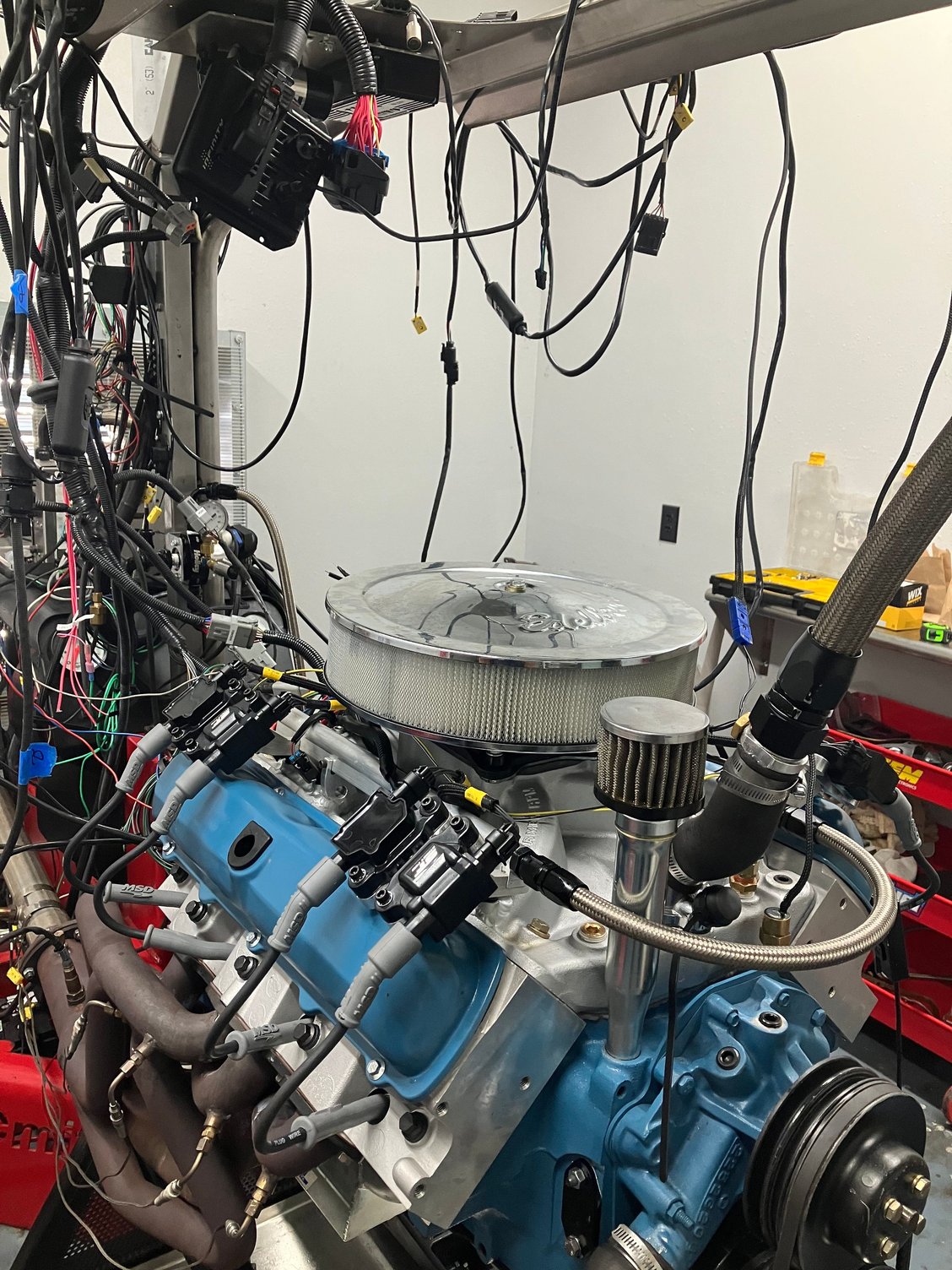

Old May 10, 2022 | 02:38 PM
cutlassefi's Avatar
Posts: 8,505
From: Central Fl
You mean like this one?😉

Old May 10, 2022 | 03:15 PM
Joined: Sep 2013
Posts: 2,939
Don’t know and don’t care cuz I wouldn’t run this combo on the street myself. I’d either change it over to the rpm or add a full ratio compression and a little more cam to the Victor combination.
Then why didn’t you up the comp and add more cam?
you can run a lot more than 9.2 with 91.
Old May 10, 2022 | 04:00 PM

Old May 10, 2022 | 04:02 PM
cutlassefi's Avatar
Posts: 8,505
From: Central Fl
Originally Posted by NTXOlds
YES! Exactly like that one, I would guess.
I would love to see those numbers, too. I am guessing a great balance of street performance and drivability.
512hp, 535tq. Flexfuel build, brother to the EFI’d 403 I posted a couple weeks ago.

Old May 10, 2022 | 04:42 PM
Rallye469's Avatar
Joined: Feb 2008
Posts: 2,669
From: Jacksonville, FL
Nice build Mark. A testament to your work on those heads.
this is a relatively modest build making very decent #’s!
congrats!

Old May 10, 2022 | 07:01 PM
  #34
Joined: Sep 2013
Posts: 2,939
Why?
Are you happy with 360 ft/lbs at 3400?
Old May 10, 2022 | 09:30 PM
  #35
cutlassefi's Avatar
Posts: 8,505
From: Central Fl
Not really, so send me something different. I’ll up the compression based on what you send me.
Old May 11, 2022 | 02:18 AM
  #36
Joined: Sep 2013
Posts: 2,939
I wouldn’t be happy with 360@3400 either so we’re both in agreement there.
It’s peak HP is at 6k and peak TQ at 5k. Both seem high for that .050 duration.
What’s the adv duration and lift it’s measured at?
what’s the int c/l ?
Old May 11, 2022 | 04:28 AM
  #37
cutlassefi's Avatar
Posts: 8,505
From: Central Fl
276/282, lift is .555/.560, 107icl. Cam was installed based on the original iron headed combo.
Victor has a large plenum. Plus remember, these “Small Block” heads still have “big block” size ports(198cc). Just too much intake area for 357 ci with 9.0:1 compression. BUT it was better with the RPM, I’ll try to find the Dyno sheet.
Old May 11, 2022 | 11:00 AM
  #38
Duh's Avatar
Duh
Joined: Dec 2016
Posts: 354
So it's NOT a true small block head, it is REALLY a big block head with smaller chambers.
Old May 11, 2022 | 11:05 AM
  #39
cutlassefi's Avatar
Posts: 8,505
From: Central Fl
Pretty much. I tried to get them to reduce the size of the intake runner and the exhaust valve, but the casting pattern was already done.
But remember, this is a “performance” cyl head, and this is a very mild build by all accounts. However it still worked pretty well with the RPM intake right out of the box.
Old May 11, 2022 | 01:17 PM
