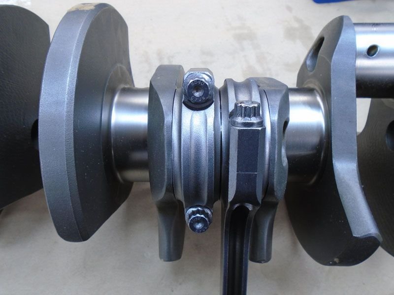

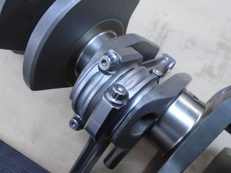

Talking BBC 7.100" Rods on the Billet Scat Crank
Well, at least I'm looking good on my BBC rods with the coated King bearings on the Scat CNC billet crank:
The H beam rods and coated King spec BBC bearings came in today, so I wrestled the crank up onto the work bench for a quick test fit - perfection! Hey, something has got to go right once in a while. A quick mockup resulted in .020" rod to rod big end side clearance, and a caliper and Plastigauge check come in right at .002" So I was right, Scat did indeed set up the rod journals for full size BBC standard interface. I was concerned with the .990" BBC big end width specs, thinking we were possibly going to have to machine them in just right, but I got lucky (actually happens some times). I took my measurements, did my homework, ordered in the right parts and it all fit perfectly. Andy from Olds Performance Products was arguing with me about this on the phone, just about calling me dumb *** that didn't know what I was talking about when we were talking about the crank. "No way full size standard BBC is going to work - Scat wouldn't do that" Well, here you go Andy - you can eat your hat now.
Paul
