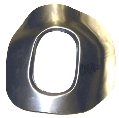

I'm pretty sure the non console cars got the same hump as the console cars did in 68-69. They hacked a holes with a torch and tack welded the hump in.
This is what you're looking for less the brackets

If you're into functionality and not originality I'd clean up the edges of the current hole, get a section from an auto car, locate the shifter, cut a hole, (before mounting the section), roll the inside edges of the hole, and butt weld in the section.
I made a wood template to make a hump but I wish I had rolled the inside edge like the original was. The inside is squarer than the original hump was but it does the job

Here's some reference info courtesy of John (2blu442)
https://classicoldsmobile.com/forums...peed-hump.html
Also, Parts Place does sell a so-called repro for $50 ....
Part # BP1281T
BUT, it's not entirely accurate to Olds (Buick/Poncho, maybe?). The hole is a bit smaller & slightly different shape than an Olds hole so it may need a little bit of tweaking...
