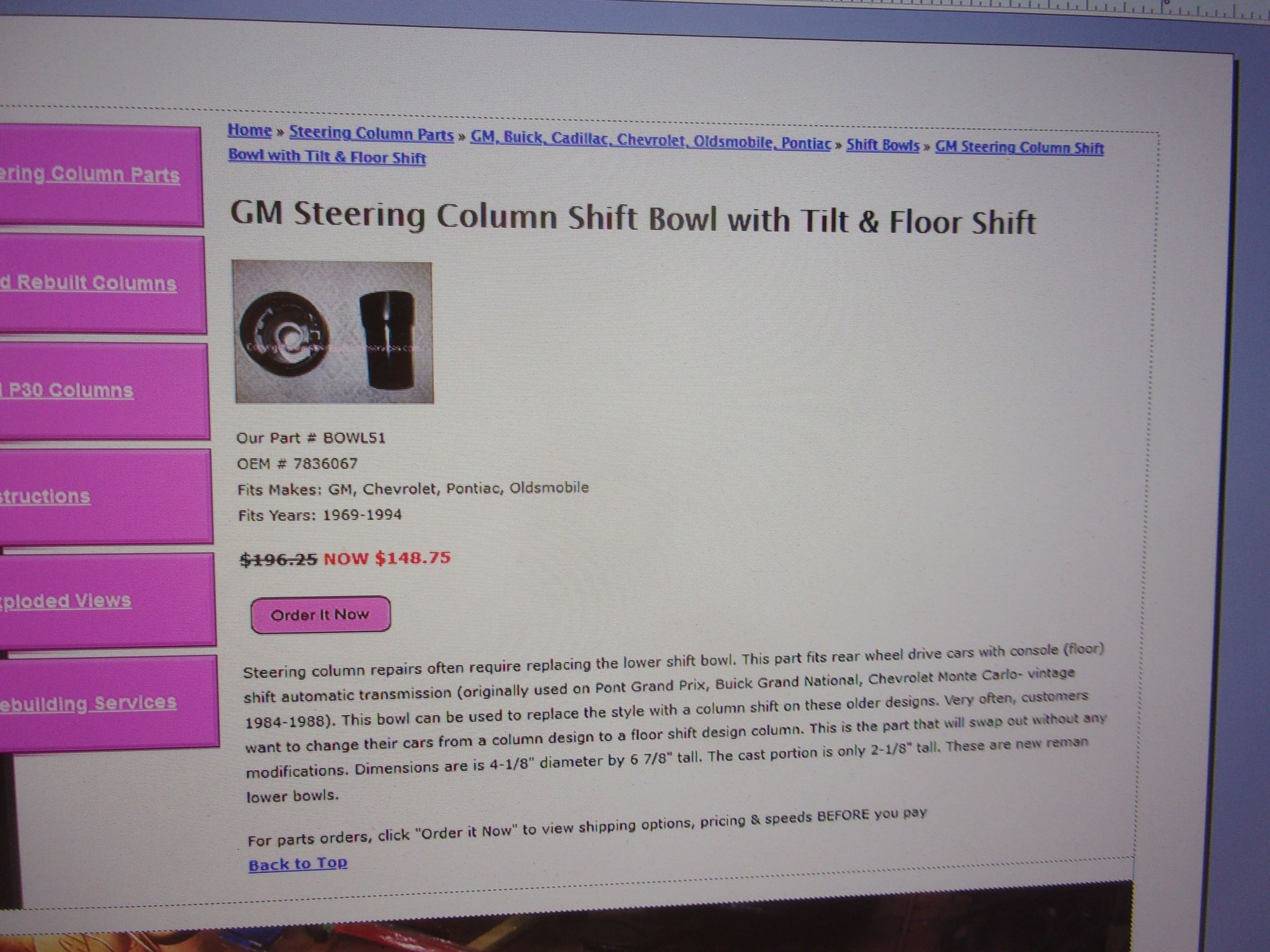

The part I need is available. Thank you guys.
I searched the web for the part numbers Joe highlighted for me. The 7836067 steering column shroud
appears to be just what the Doctor ordered. Thank you, Joe.
