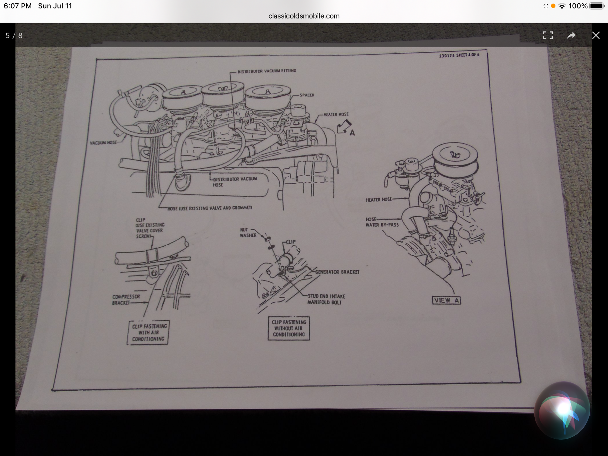

The one I'm looking for secures the heater hose at the manifold near the alternator mount bolt.

The diagram in lower center.

So it's a guide clip instead of an actual hose clamp.
Pretty sure those were on all 65-67 engines and maybe earlier as my 64 Starfires have them.

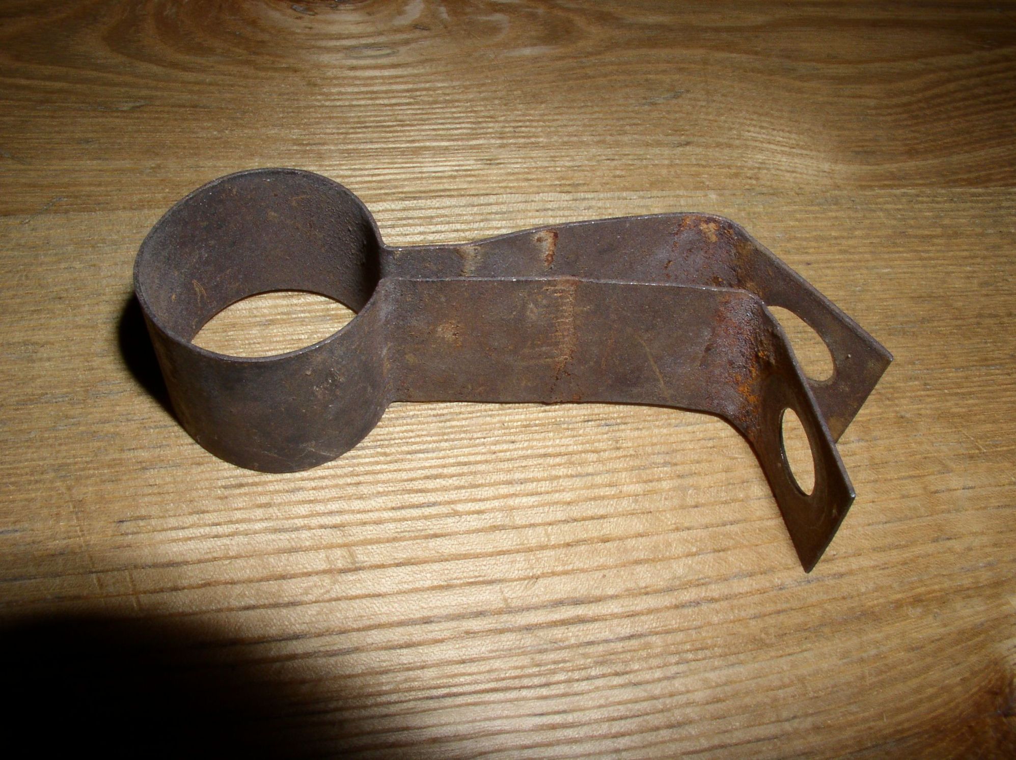

Here is a clamp I have...came from a '67 Cutlass. Super nice original clamp w/no pitting, etc. Beadblasted clean and professionally re-phosphated to the original finish.
You can PM me if you have questions.

You will have no worries buying the one Patton pictured in Post 8. He's a skilled restorer, his descriptions are accurate, and you will be happy with anything he sells.

You can use the 68-72 clamp that works great, Fusick has them and that diagram showing it bolting to the valve cover but it will not. It bolts to a studded bolt in the second position on the intake manifold. The studded bolt is the same as the studded bolt in the first position on the drivers side intake. The one on my car.

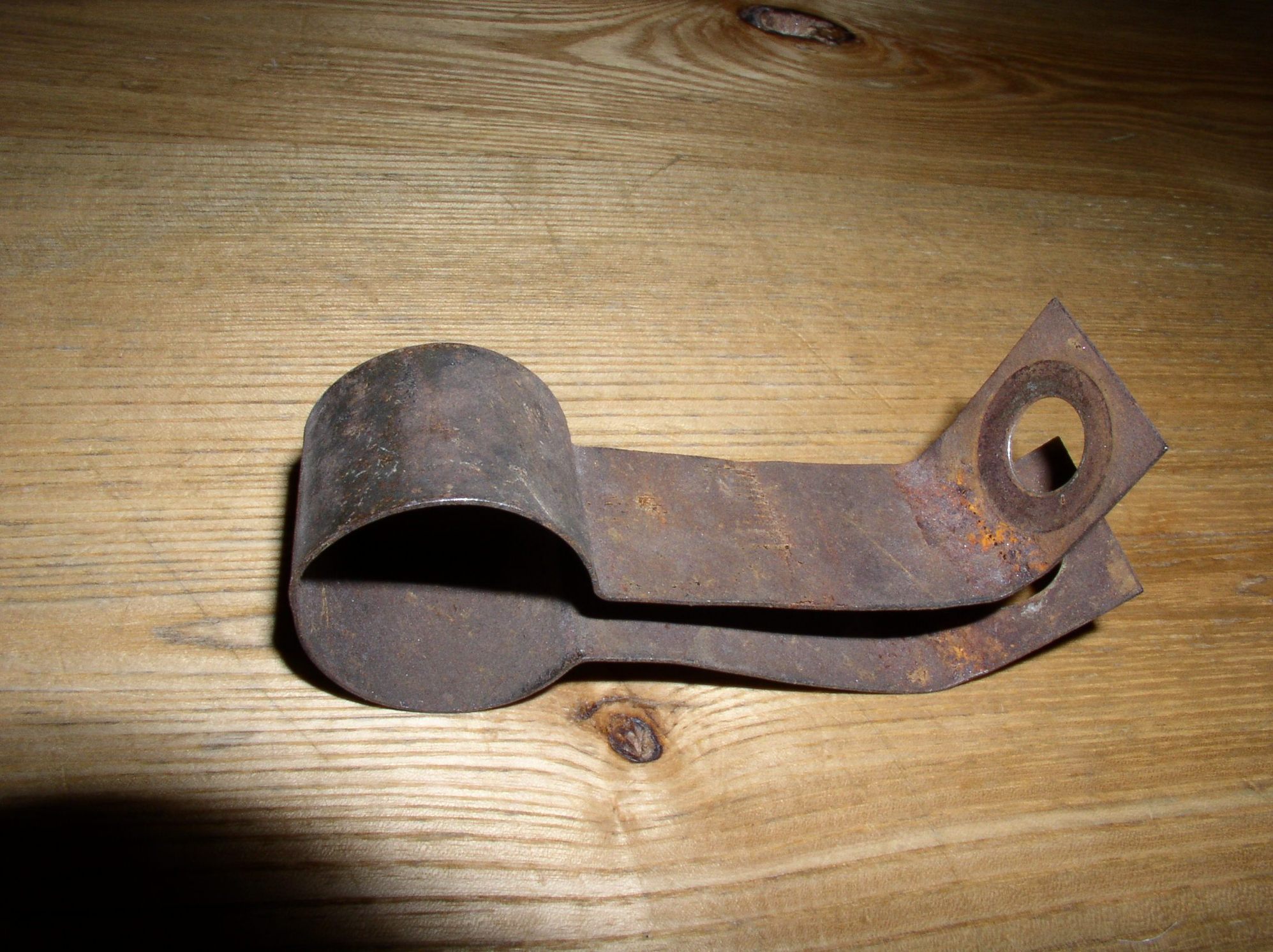

Hose guide clamp bracket
Went through 3 fiver gallon buckets of parts and found one pictured below
$25 shipped to lower 48

Thanks for digging it out,but looking for one like in post #8
