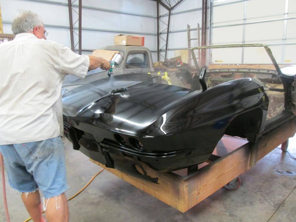

Agree with Joe. Metallics require better equipment and some skill but if you are shooting a single stage solid color the Harbor Freight units are all you really need. I used one on my last job to shoot Black lacquer and it turned out great.

Yeah...yeah I know. I did have a 4 foot floor fan pulling air through the shop and out under the shop door. Plywood blocking off the sides of the fan to the door opening. You can just see the top edge below the bottom of the door in the pic. Kinda of a redneck version of a down draft booth. I was shooting upstream of air flow.

X2 on the mask, and spraying in shorts and a tee lol and the the spray job looks to dry, check the data sheet if in question on what pressure you should be using, the key to a good paint job is the prep work, painting is the easy part..
