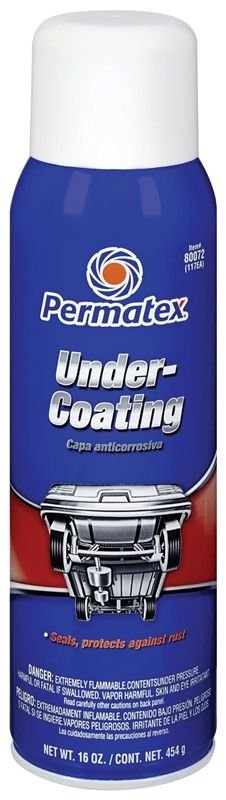

I also like Permatex for serious undercoating areas. This is the Asphalt undercoating, not the rubberized version. Kroil is penetrating oil for cracks and crevices and places where you should not use awful smelling stuff -> like around the passenger compartment and trunk!
