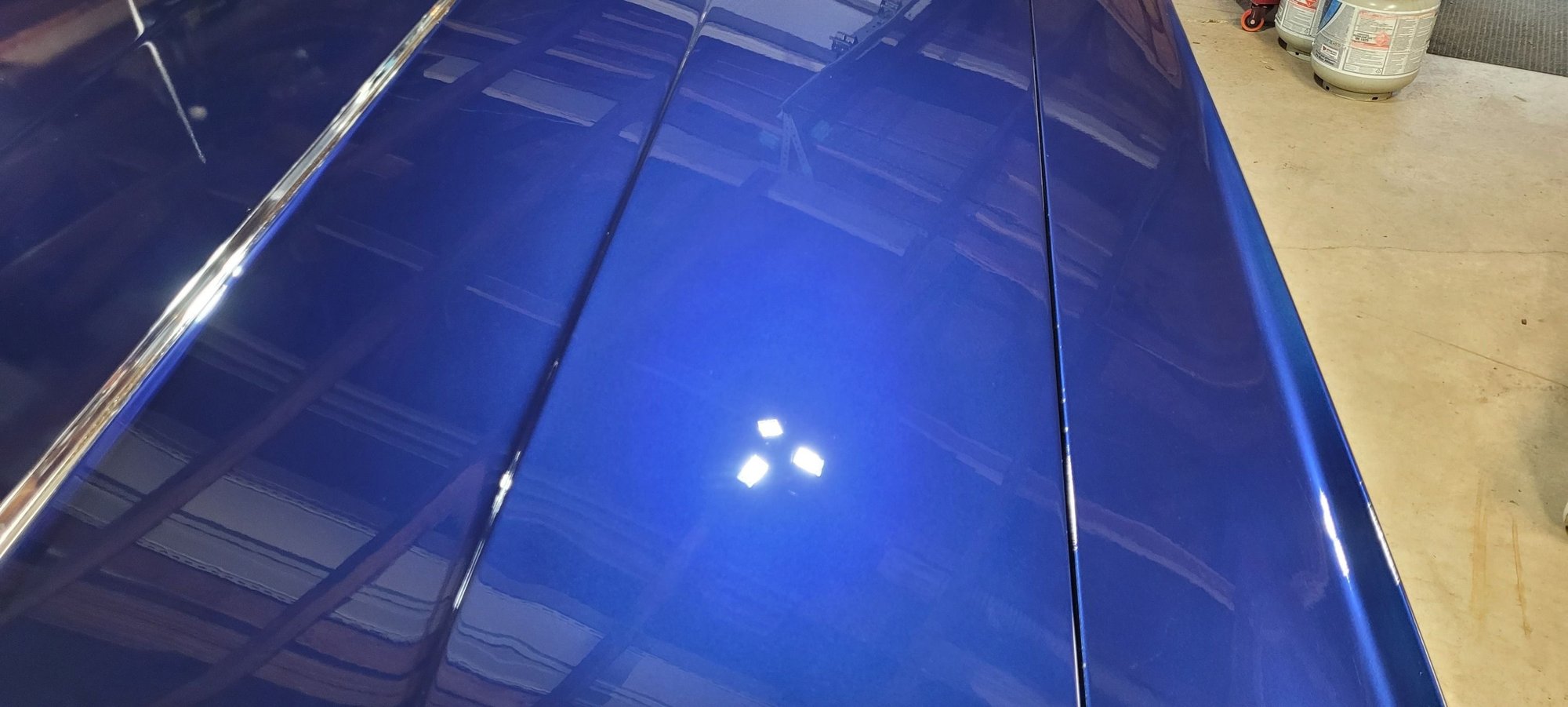

My car was a back yard restore - if you've seen my other posts, a lot of the stuff done to it before I bought it was half-a$$ed (I'm not bitter, it had a lot of potential and it's turning out pretty good). The paint job was no different. It looks fine for what my car is, a driver not a show car. It is a base/clear paint job and I love the color but the orange peel and crap in the paint drove me nuts. Last fall I was fixing some chips and sanding with 1,000 grit to flatten the chip after I put in the touch up paint, followed up by 2,000 grit, compound and polish. Fixing the chips got a little out of hand and I used 1,000 grit to knock down the orange peel on the one half of the hood. The problem was I didn't know what I was doing and my heart sunk when I saw the end result. While I did use 2,000 grit and compound after, it still didn't look good. Over the winter, I did some reading and built up the courage to fix my mistake. Here is the results from yesterday's project.
The left side of the hood shows the 1,000 grit marks from when I was getting rid of the orange peel - even after the 2,000 grit didnt do the trick. The right side is the
The left side of the hood shows the 1,000 grit marks from when I was getting rid of the orange peel - even after the 2,000 grit didn't do the trick. The right side is the "after" side, when I used Meguiar's Pro Speed Compound to get rid of the scratches.
Another view of the
Another view of the "before" and "after".
This is the finished product, after wet sanding and compounding, I finished up with Meguiars Deep Crystal Carnauba Wax.
This is the finished product, after wet sanding and compounding, I finished up with Meguiar's Deep Crystal Carnauba Wax.

What machine and pad combinations did you use?

I used a Bauer (Harbor Freight) 6" DA for compounding and polishing.
For the compounding, I used SPTA 6.5" Green pad (heavy cut), from Amazon.
For the polish, I used a Grants 6" polishing pad, also from HF.
