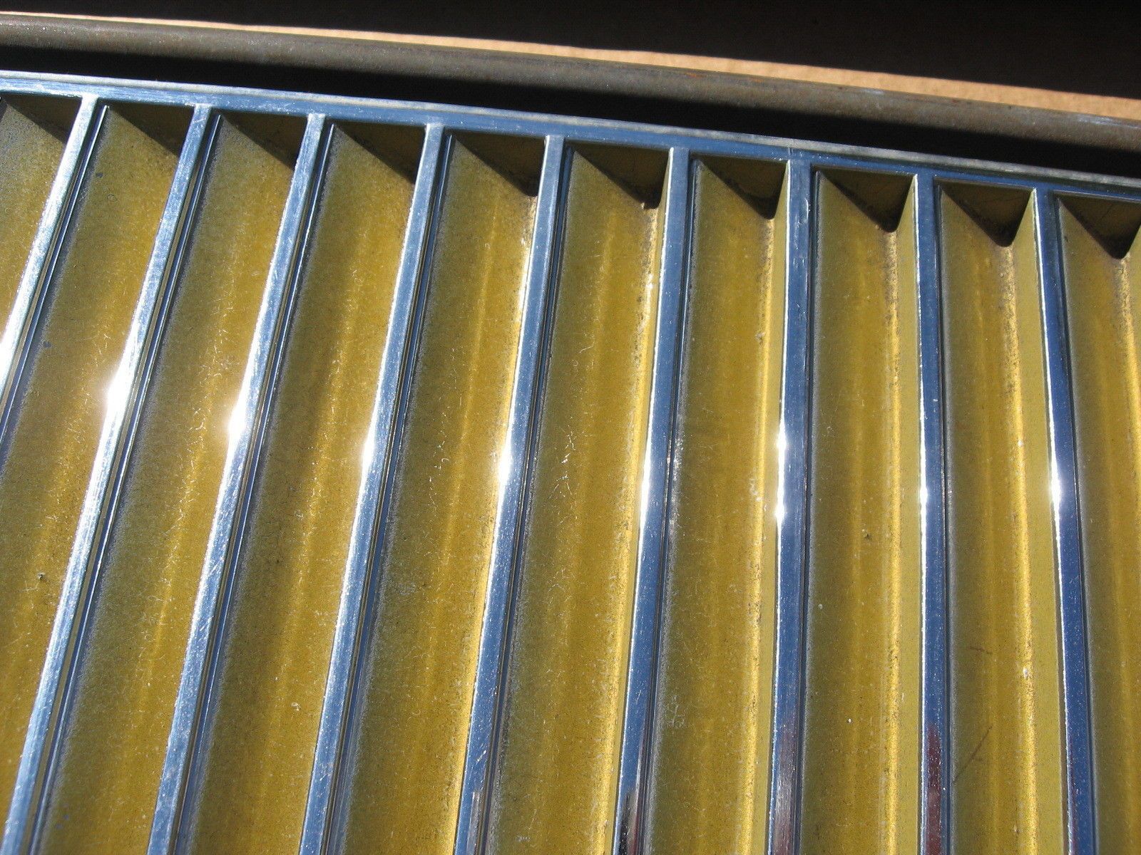

Many of the ones I've seen were painted gold (or some variation thereof). I restored a set for an S hood that I installed on my '72 ragtop and painted the inlays a semi-gloss black to set the louvers off against my red body color. - these are the ones I started with

Just as depicted in the photos I provided of the seemingly unmolested set I started with, I believe only the ribs and outer edge outside of them remain chrome - the inlays right up to the inside walls look to be painted
If there are any true experts on this topic, possibly they'll weigh in further

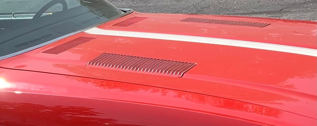

Jeff, Here is a picture of the louvers of our unrestored original paint 72 W29 that you may have seen at the 2024 Springfield OCA Nationals (was a cross from you towards the end of the parking lot). Only the top of the ribs are chrome so the picture you marked up appears to be correct. Also, as you stated, Only the 1972 W29 cars had blacked out louvers. All others were body color
1971 Cutlass S: Hood Louvers are Body color
1971 442: Hood Louvers are Body color
1972 Cutlass S: Hood Louvers are Body color
1972 Cutlass with W29 442 appearance package: Hood Louvers are Black regardless of Body color.
