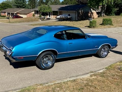

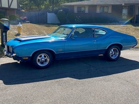

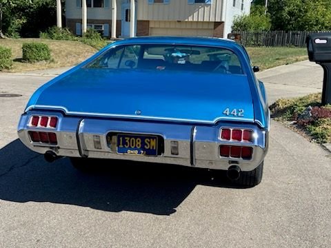

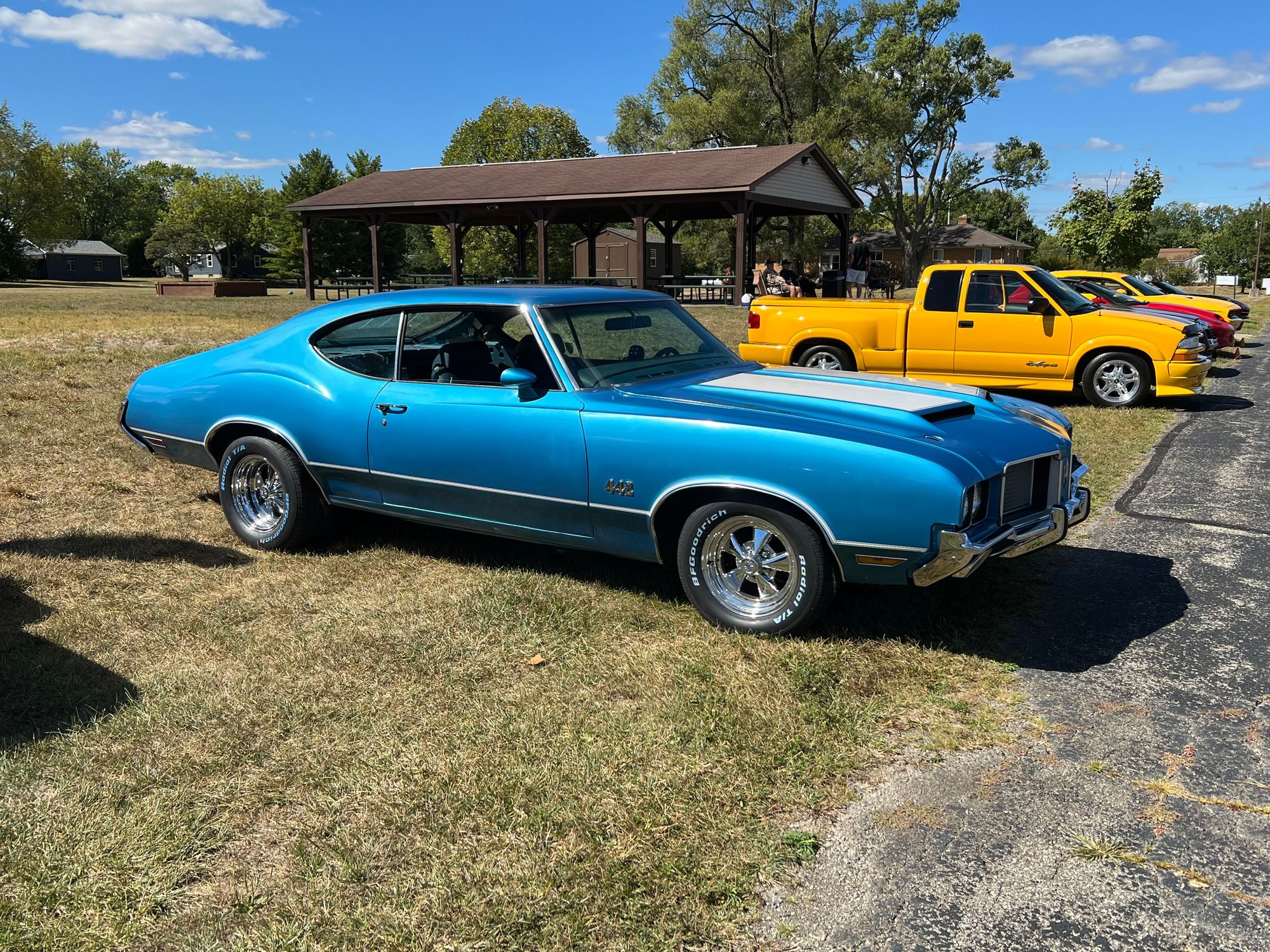

Yes, the lacquer shrinks after you think you're done. I painted the hood stripes and the sides and trunk pinstripes on Labor Day. Took it for a local drive in the neighborhood today. I have not washed the whole car. I'm going to wait 10 days since the white stripes are new lacquer. I'll wash it and wax/buff the blue areas. I'll go over the white in a month or so. I'll use Meguiar's #26 yellow!
Looks OK for a garage paint by a 72 year old man who hasn't painted a car in 20-30 years! It is what it is. It's not as nice as I'd hoped but not as bad as I'd feared! My 69 BOSS 302 was waaaay nicer but then, I was waaaay younger!

I hope you’re proud of it, because you should be. That’s all that matters. The pats on the back are nice, but at the end of the day, who cares what anyone else thinks. It’s your car done your way.
Old Sep 4, 2024 | 06:33 AM
69HO43's Avatar
Posts: 2,549
Looks great! I wouldn't complain about your paint job at all. Looks better than OEM!

I washed and waxed it after it was at this show and it looks a bit better! Still, not a Barrett/Jackson quality car! I’m on a budget! 😂
So far, I’ve done it all myself!
