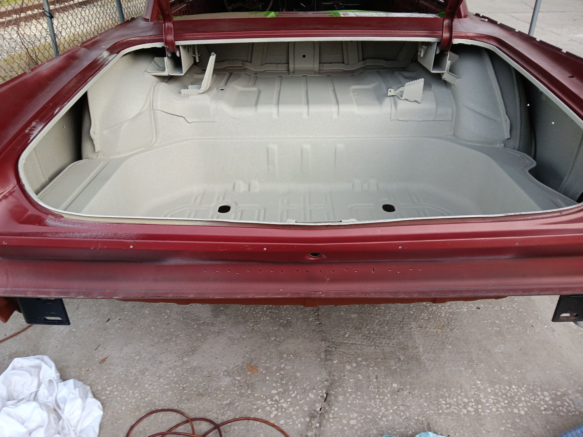

X2 on Zolatone.
I sprayed the trunk of my '63 with a cheap Harbor Freight gun with Zolatone.
I think it looks pretty good.
Old May 16, 2024 | 07:16 PM
fleming442's Avatar
Posts: 3,858
From: Mt.Ary, MD
X2 on Zolatone.
Looks great!
Do you need a big nozzle, I assume, for the flecks?
Old May 16, 2024 | 07:24 PM
Posts: 15,394
That’s your trunk? At first I thought it was a 6 person hot tub.
Old May 17, 2024 | 06:53 AM
Charlie Jones's Avatar
Phantom Phixer
Posts: 5,525
From: Apopka, FL
Looks great!
Nope, just the cheapest Harbor Freight HVLP gun. About $15.
Zolatone is a nitrocellulose coating, and they don't recommend that you thin it.
They do say that you should apply over a similar color primer.
That's why they call them FULL SIZE cars.
