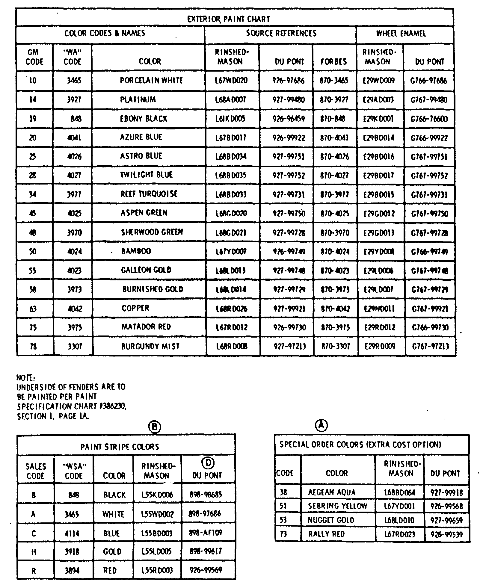

For a 1970 Cutlass, "- -" appeared on the cowl tag (and a blank on a broadcast sheet) when you ordered option Y62, Special Paint - Colors.
The order sheet listed four colors for Y62:
Aegean Aqua (paint code 38)
Sebring Yellow (paint code 51)
Nugget Gold (paint code 53)
Rally Red (paint code 73)
Other colors could have been specially-ordered and would have also resulted in the "- -" and blank paint indicators.

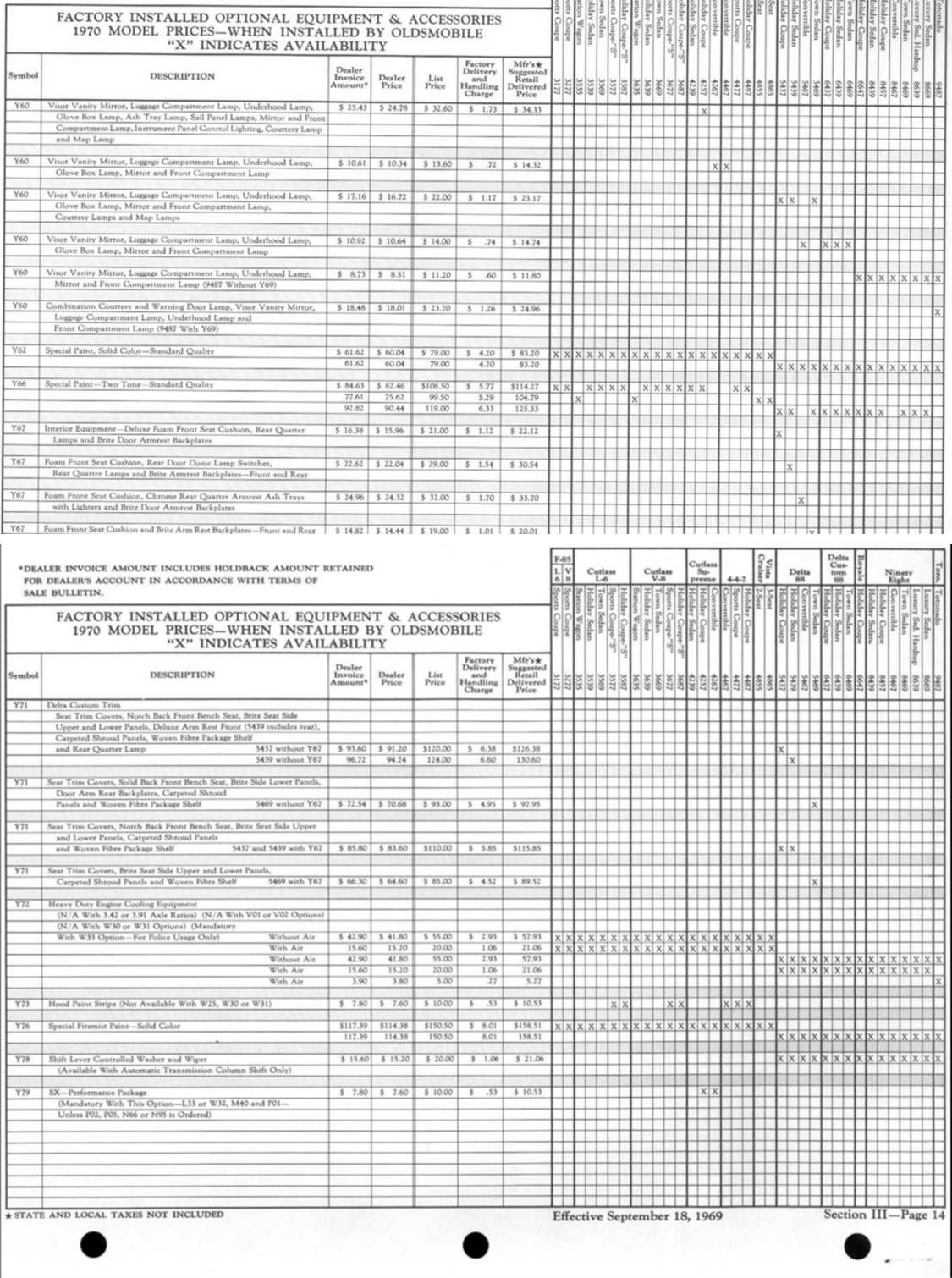

Paint code and availability info is in Section 0 of the Product Information Manual
Old May 18, 2024 | 07:26 PM
Posts: 50,768
Info on the RPO codes for special order paint (including non-Oldsmobile colors) is found in the Dealer Optional Equipment and Accessories list. Note RPO Y62, Y66, and Y76.
