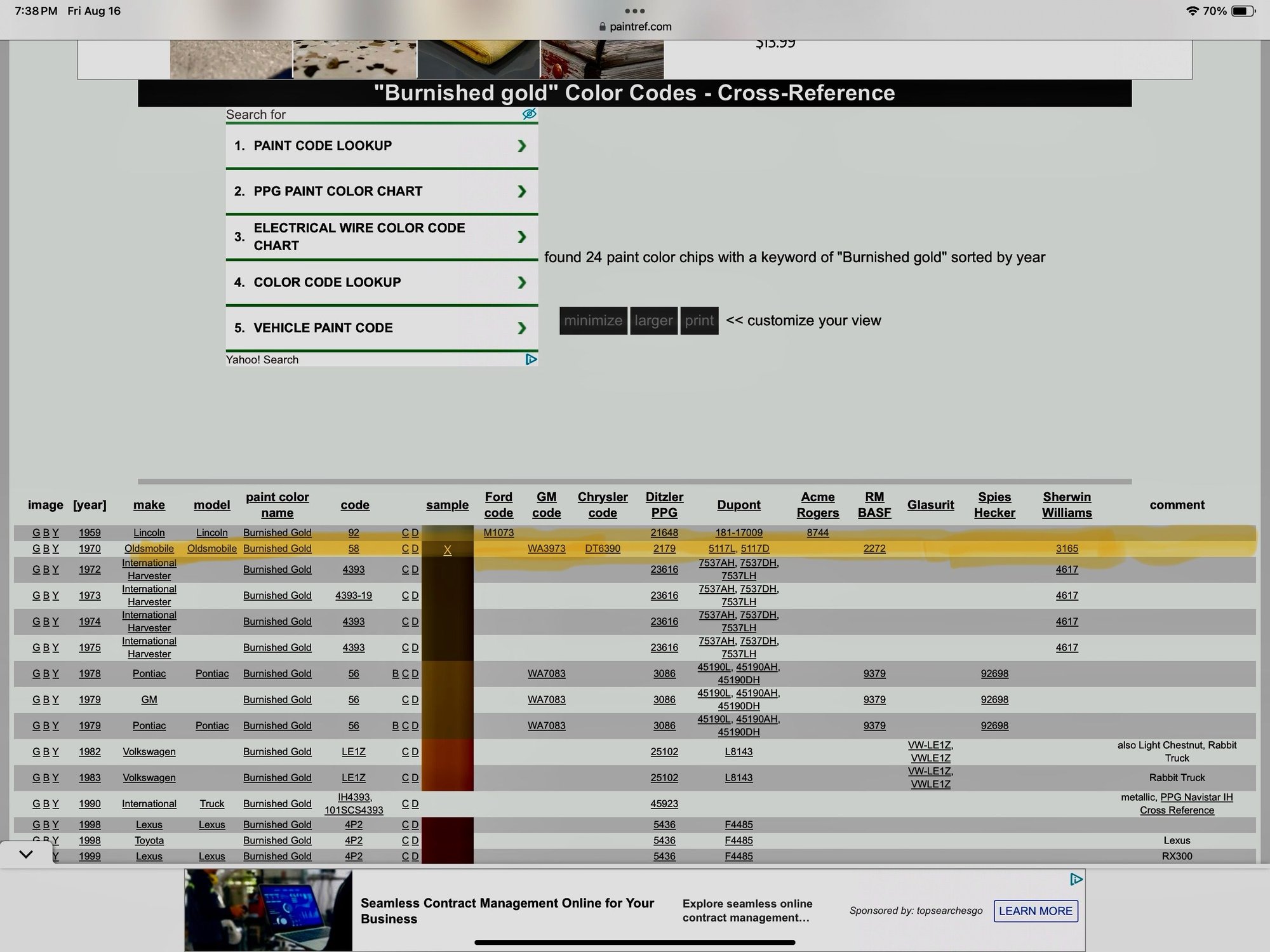

this chart shows rm, Sherwin and DuPont

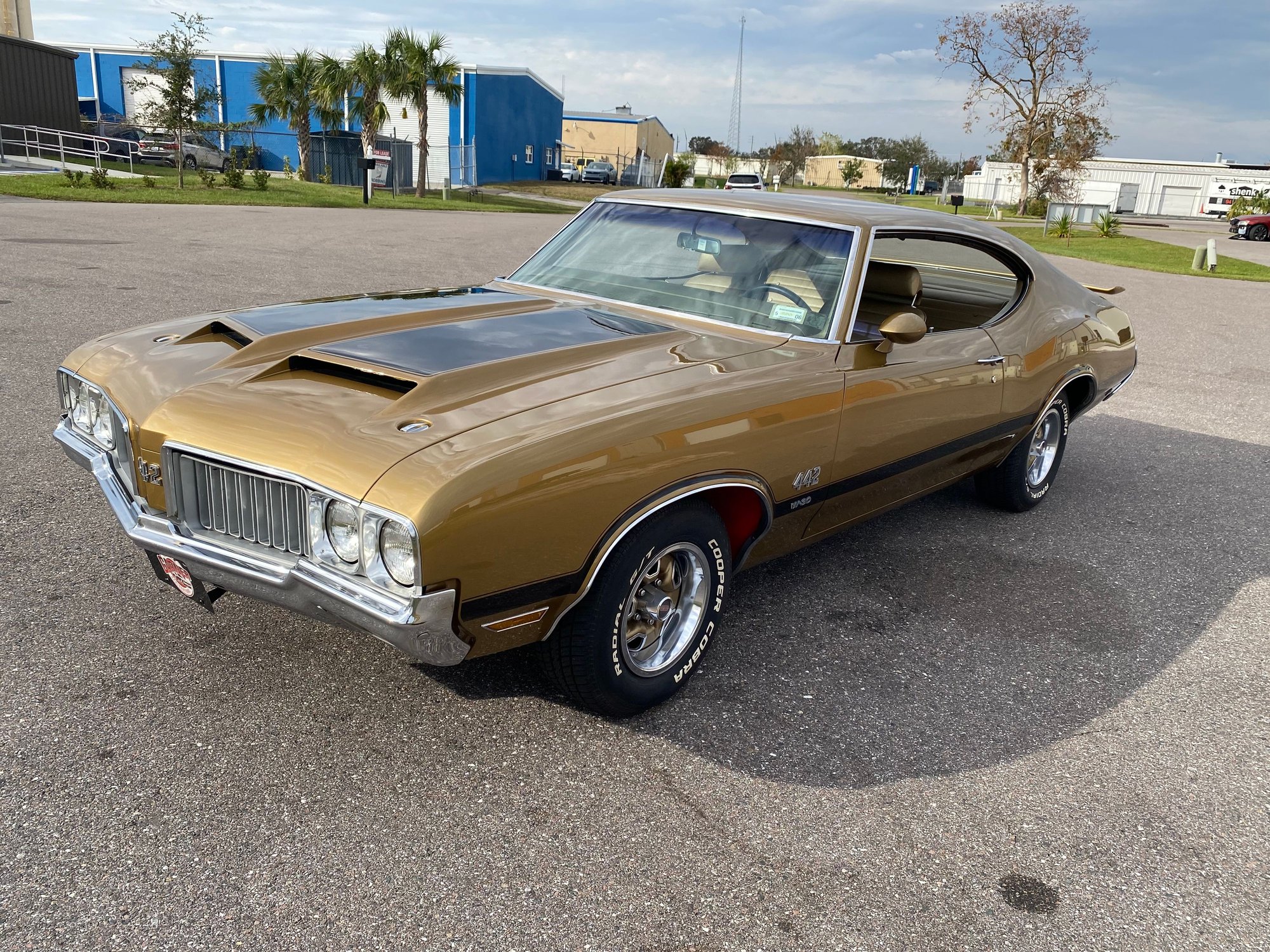

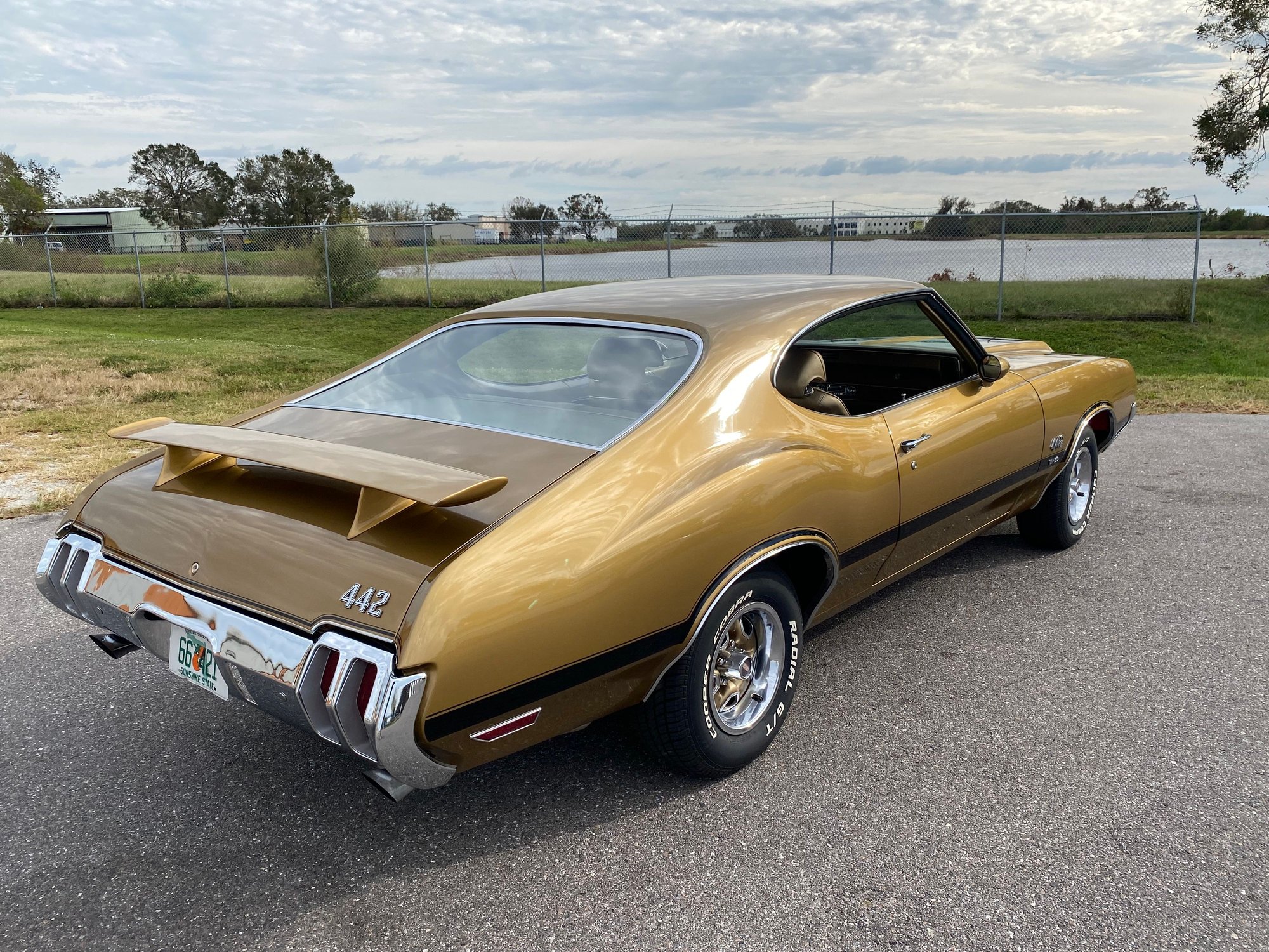

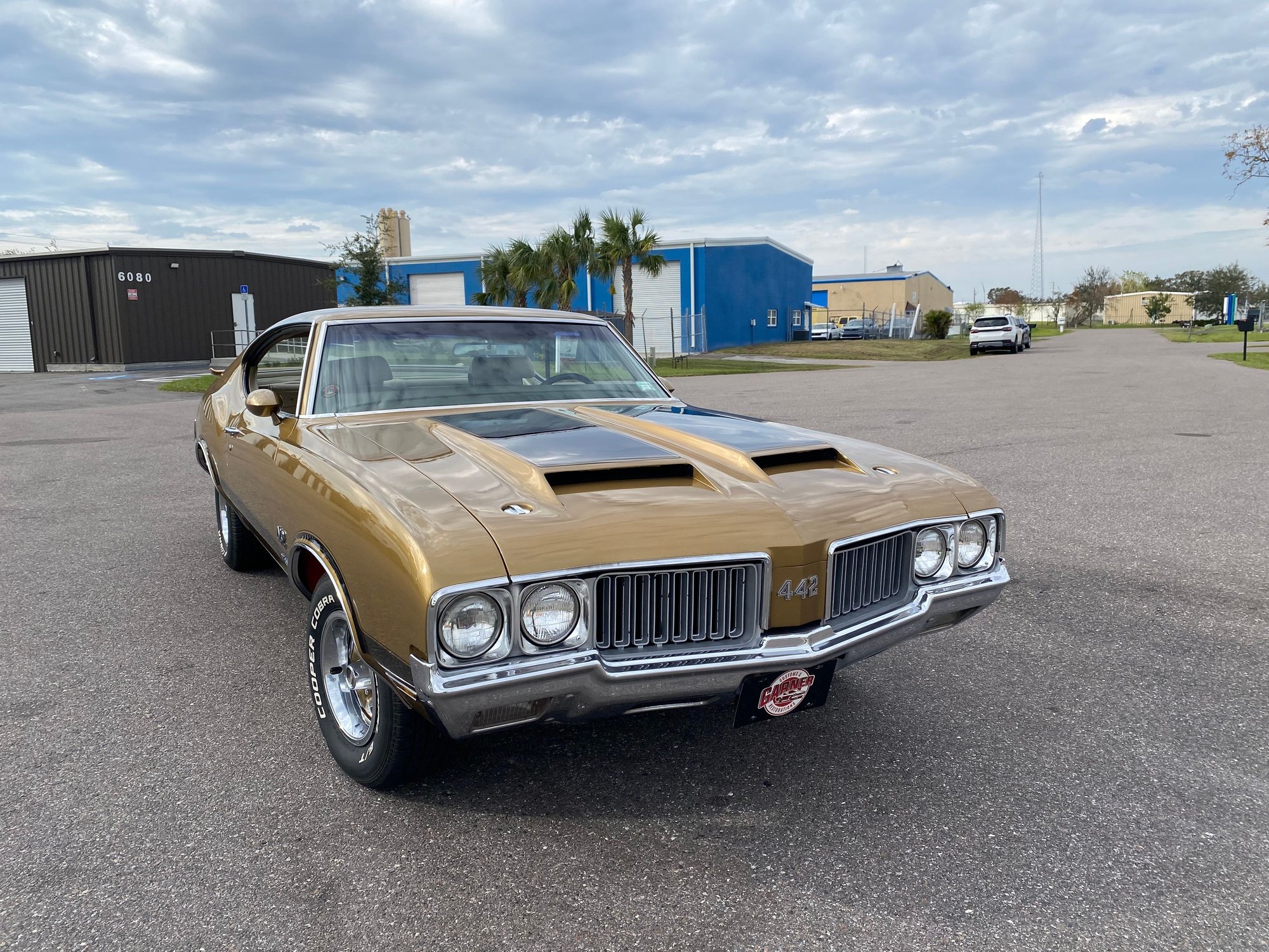

Ppg was able to give a good match finally. Its a touch more gold than the factory burnished gold. Very very close. Using camera and code thats the closest they could get. Will
look fantastic

This is PPG shop line, only line they could get the code correct, takes about 6 coats of color as the paint is thin. End result was great.
