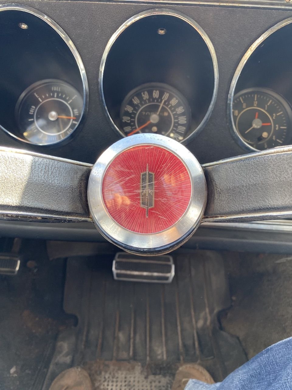

I don’t have a shop manual for the Delmont 88 in my hands yet so I don’t know the trick for removing the central steering wheel medallion. I assume the inner horn switch screws are concealed beneath it. I’ve gingerly twisted and pulled and it doesn’t release.
I need to remove the horn switches for cleaning/repairing the intermittent contacts.

Ran across a photograph of a Delta 88 steering wheel and saw where the clips engage into the steering wheel. Inserted my fingernails, gritted my teeth and pulled. I figured they would snap off first.
I realize now that the clips are made sensibly of steel and there was nothing fragile to break. Contacts are cleaned of oxidation, treated with Vaseline and now it’s honking reliably.
The retaining ring which retains the plastic trim is made of spring steel which will yield (unclip) under sufficient force. In '66 there were 2 prongs or "ears" that secured the ring/medallion to the column. I suspect, but don't know, they used the same or similar design in 1967.
