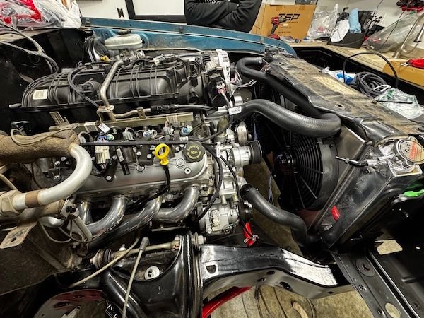

I have a 71, ls and flowmaster headers. What have you used for exhaust that doesn't break the bank?

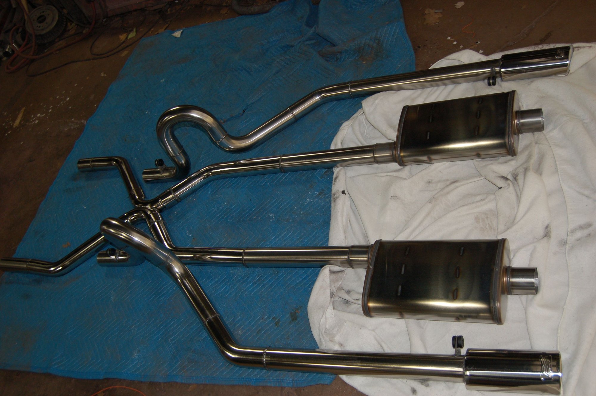

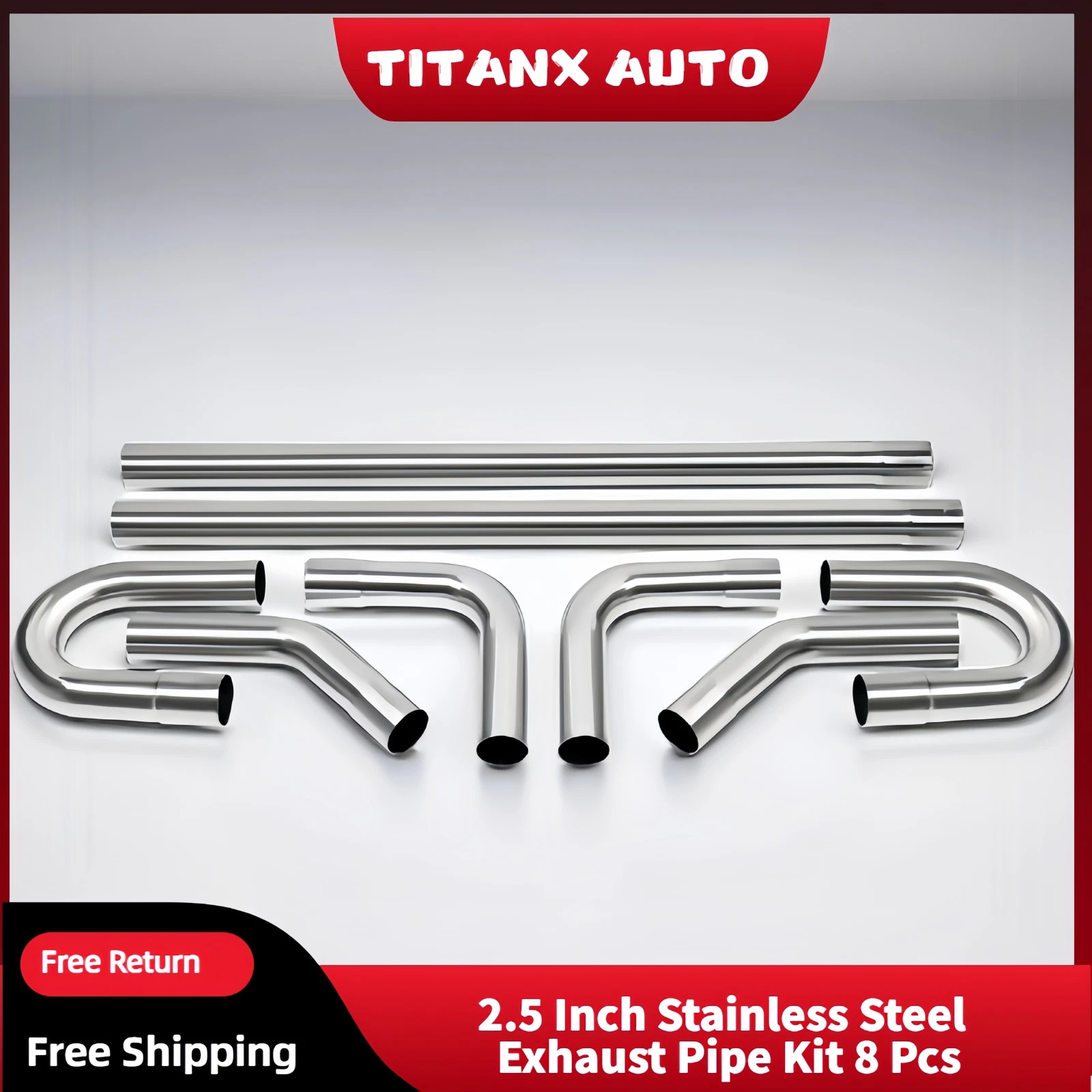

If you have a mig welder and a cut-off wheel, buy a kit like this and make you own:
https://www.ebay.com/itm/35672483670...Bk9SR_aR9ouxZg
The above kit is $79 or you can find one with an X-pipe for a little more. A mig welder will weld stainless really well.

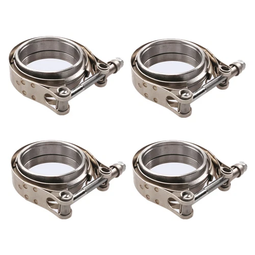

You can add some V-bands to make it easier to remove when needed:
https://www.ebay.com/itm/20469059661...3ABFBMyu-VjLFm
2.5 Inch V-Band Flange&Clamp Kit Male/Female With Ridge Exhaust Stainless 4 Pcs - Picture 1 of 7
The above V-bands are less than $40 for the set.
Buy a set of stainless mufflers of your choice and with a little time and effort you will have a nicer system than the standard exhaust shop "crimple-bend" system and probably save some money too.
I have made a few systems with kits like this so far. They work really well, but it does take time.
