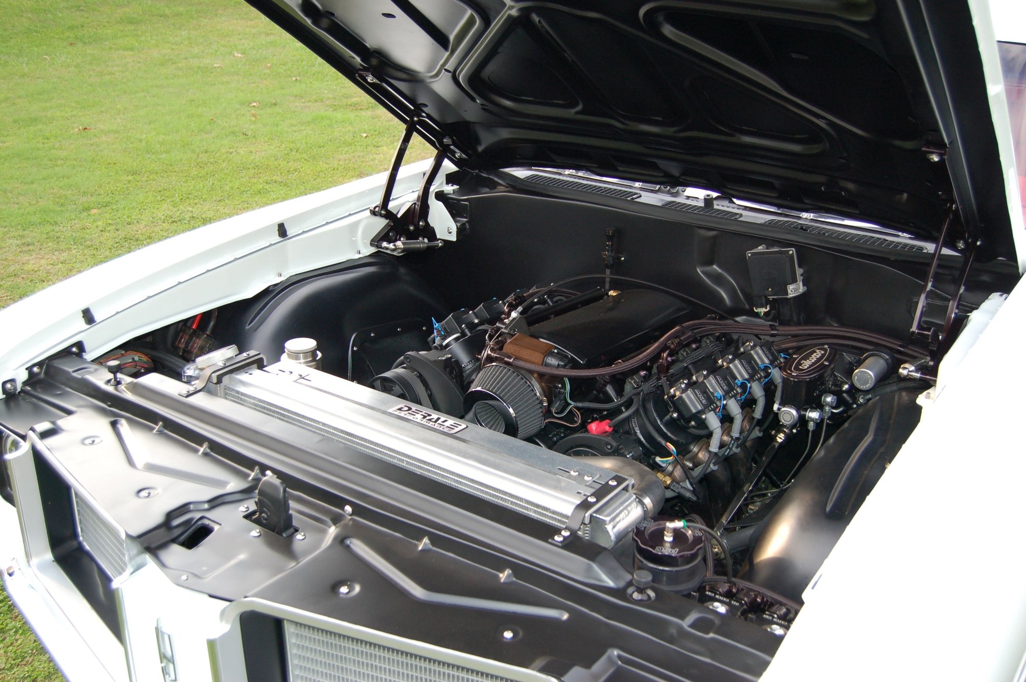

I got a turbo LQ4 in my 71. Its about the easiest LS swap you can do. The a-body swap market is endless.
