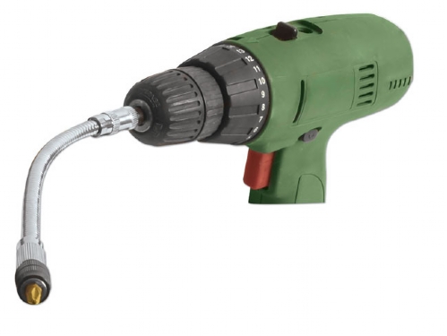

I used a flex shaft extension attached to my drill with hex attachments for most of my dash screws I couldn't
reach with my fingers after loosening. The biggest bitch of it was gettin a long enough hex socket on there to fit

I must say, I've never seen one of those. I'll have to add it to the tool box...
